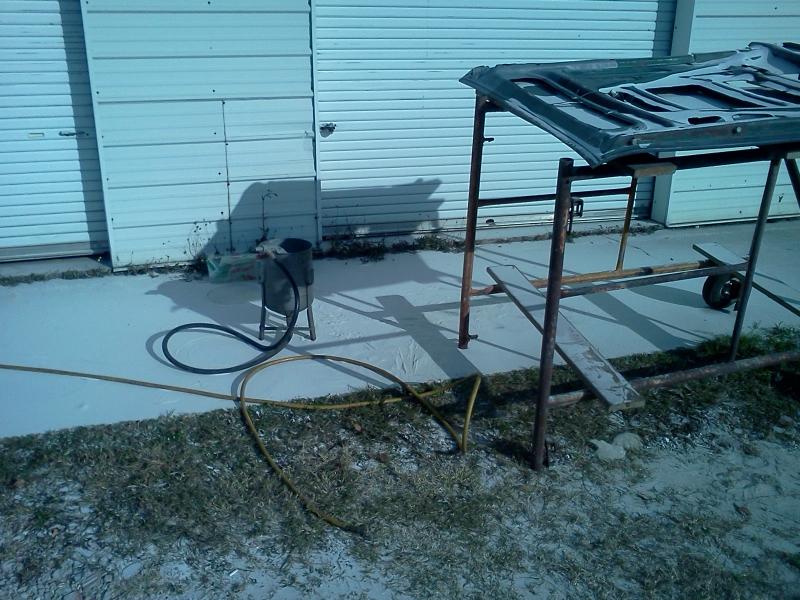

Media blasters - anyone doing this at home? What blaster?
I found this gravity setup at a yard sale for $25.
Works as good as the HF pressure pot with a LOT less hassle.

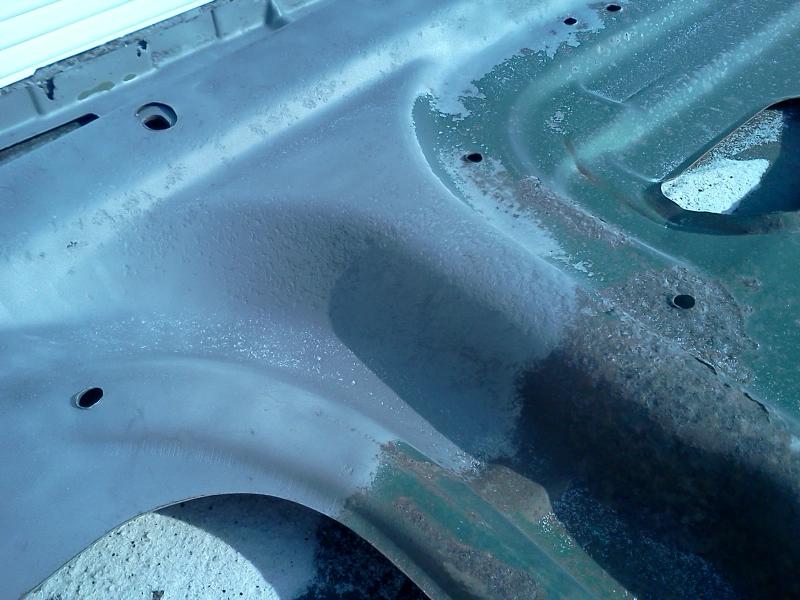

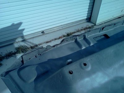

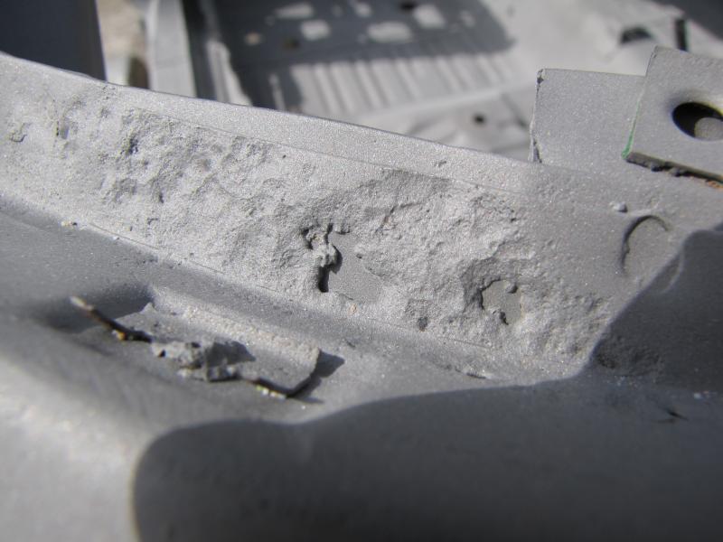

Here's a look at some of the things you find.
I knew some of this would be there.

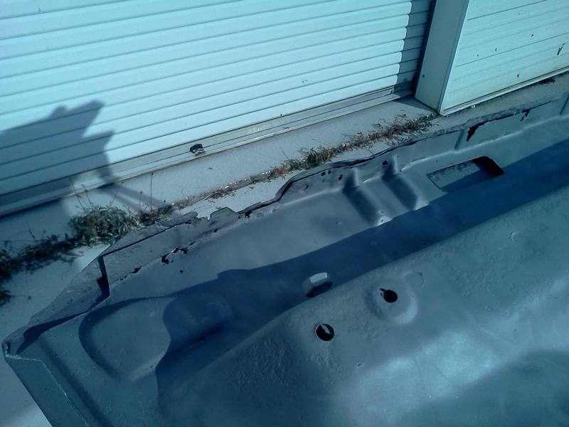

We'll see how this turns out.
I've not warped a panel yet...and I did a roof last year.

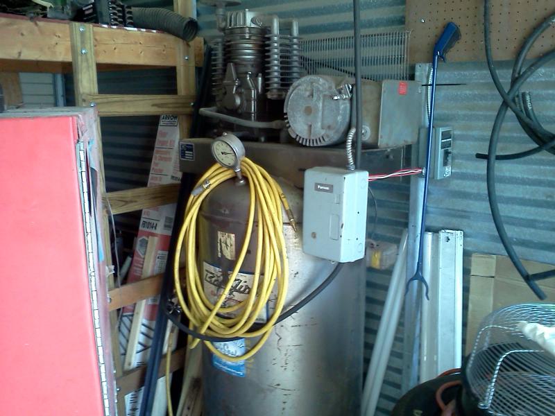

Here's the compressor I'm using.
BTW that corner took an entire bag of sand and about an hour.
Regulator was at 85-90 PSI IIRC. Compressor is set at 140.
32 CFM.
Next time I'm putting down a tarp so I can reclaim at least some of the sand.

You should not be using Sand, period. Doing it for the fun of it is not fun if your son (or you) gets sick from what Cuda Chick sais, which is true. There's a LOT of areas where Hobbyists can excel in; blasting is not one of them. DA'ing the outside panels you will NOT get clean areas like this, in fact, you'll be wasting sand paper, your time, and making a turd of a car if you sand this (and these types of areas) down, and paint over it. In fact, you don't know this sort of damage is there unless you media blast.
