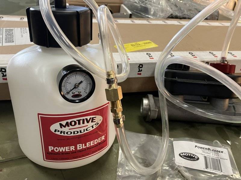

Having the “Motive” one man bleeder tank makes it easier to bleed the brakes when a helper isn’t around.
