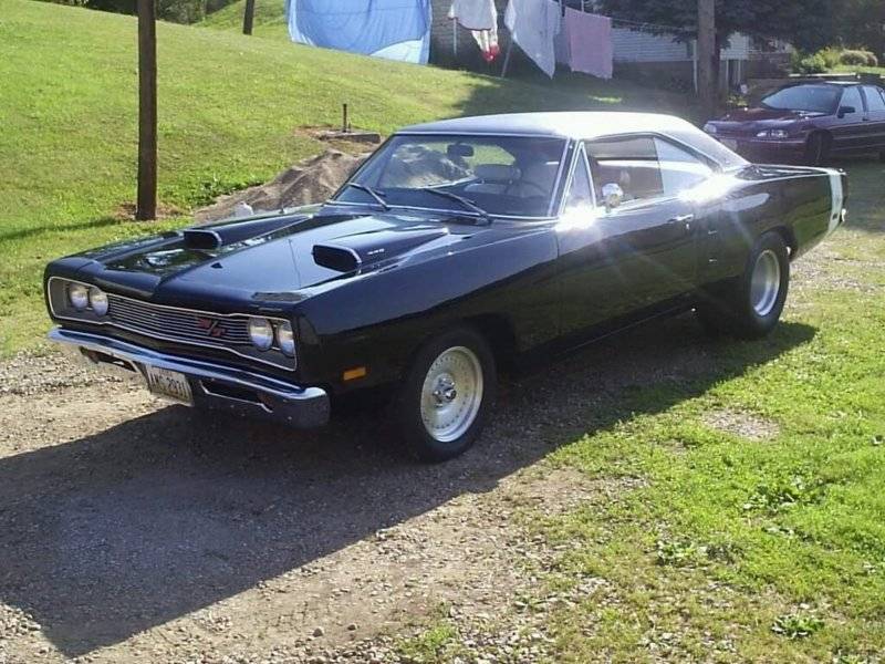

I'm running BF Goodrich 345 55 15s on my Coronet and cant find anything close
@Rob Vaughn , that tire has been discontinued a LONG time. Posts on moparts looking for a replacement going back to 2009.
What size rim are you using? Do you have room to go bigger? Does it have to be a radial. Is it strictly for street use, you just want a big tire, or is it for occasional track use?
If you can go bigger, M&H makes a 390-45x15 drag radial. Same height as yours, 12.5" tread on the ground, probably an inch or so wider in section. Other than that, it looks like you might have to go smaller. I've got some 315-60x15 et street radial pro, on twelves, I can get you dimensions if you want.
I agree, it looks like everything available is way bigger or smaller.
Kinda just wanted to stay with the same look. I have an inch clearance on the inside but still rubs occasionally if the the car is leaning hard
Its just been mini tubbed to the frame rail.
I don't think I can go wider.
