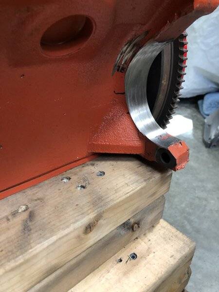

I usually buy used mini starters so warranty is pretty limited concern.
I would not grind my block.
People grind blocks because they don't want to ruin a POS new starter that's under so-called warranty for fear they can't replace it, so they ruin their blocks instead!
No issues, your engine so you can grind all you like. My point is that before I would be grinding on the block I would want to make sure that it was necessary. You have to remember that there are others who come on here who may not have a lot of experience and saying "grind the block" may not but the best solution. I have taken a grinder to many engines for one reason or another but that is after ensuring that it was necessary and I knew exactly how much I was taking off and what the potential effect might be.
Sometimes you have to do what you have to do but in general if the engine was working previously, the replacement of the starter should not in most cases require grinding, however if it does, so be it.
To each their own. I don’t care. I was pointing out to the OP that the starter may actually also be hitting the block so for him to have a look there too. If some people don’t care about grinding down their already weak and poorly cast aluminum off shore starters to fit that’s their choice. My choice is to make my life easier for now and possible future events.
I ground 15-20 trough off a useless area of the block. Not the side of the block where the terminal block goes or near water jackets or cylinder walls etc...
My engine builder, a mopar specialist, also a machinist, and a tool maker does it, did it, and recommended it so that’s good enough for me.
If you want to see what 15-20 thou looks like go get your electric caliper with the Digital read out and open it until you see .015 on the display screen. This amount in that location does not ruin a block.

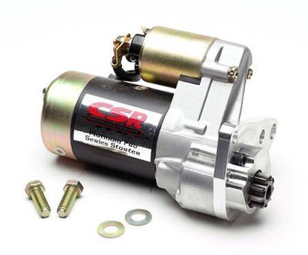

Is this $400 CSR starter a POS?
View attachment 1088077View attachment 1088078
I agree that .015-.020 is not a lot and should not have any effect on the engine/block. My question is more about why the starter/s didn't fit in the first place? Was the block a bad casting or is this just something specific to the starters?
I wouldn't say that the CSR starter is a POS, I would say it's pretty expensive for what it is but I am sure it does the job.
