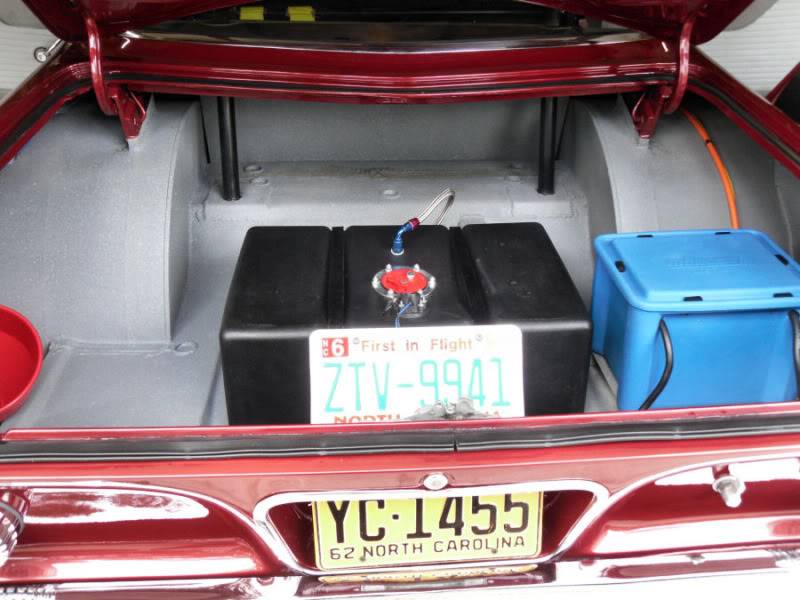

did mine a while back....all that work and the end result is ....WOW....i could squeeze 31-16.50/15 in there....looks great

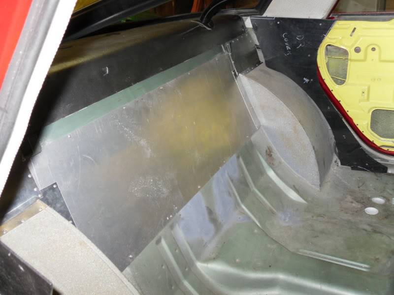

Here's a shot of my 62 tubs. Springs are moved in 3". The rear seat can be kept in but the top and bottom seat frames need to be cut a bit and have a 90 degree piece welded back in. Jut to wrap the edge of the wheel wells.
Do you have pictures of the seat mods?
