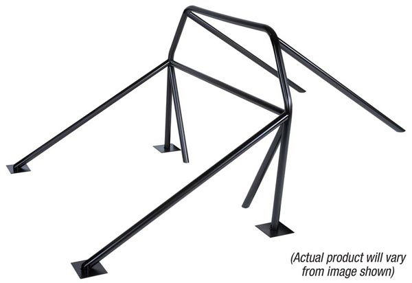

Mine has swing outs on both sides. It is an 8 pt bar

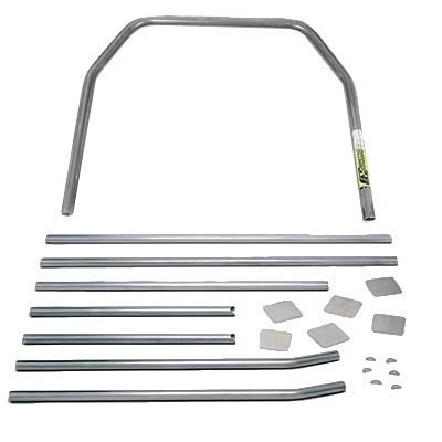

Competition Engineering sells a Mild Steel 8 pt kit
haven't bought from them in a while but the one I bought 15 years ago
was a decent kit, a little room for adjustments
I use to hang out with Chris Alston's foreman Jim some,
He was part of our Calif. Outlaw P/S racing Assn.
he was a great guy, great fabricator to aid in advice on custom roll-cages or roll bars
when I lived in Rancho Murieta {southeast Sac. Co.}
he custom bent some chrome-moly 4130
0.095" & 0.120" wall x 1-3/4" bars/tubing, struts & hoops for me

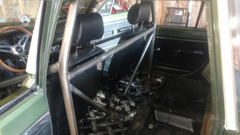

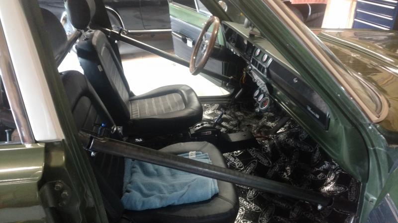

Got done putting a cage in my car this winter. If you guys are looking for some more reference material... Originally was just going with a 8 pt, but I really wanted the extra safety of a 10 pt. Just something to think about.
