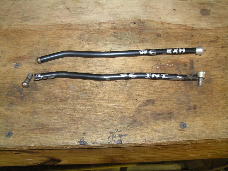

I bent two pushrods severely when I accidentally hit 8000 rpm's with my poly. I was running 7500 consistently at the races but 8K was too much.
It definitely caused the valves to "click". You can use a vac gauge to see if there is a valve train issue. It will cause the gauge to flutter. In my case it was extremely easy to see which ones were the culprits. BTW all I did was replace and re-adjust the valves and all was well. Lucky!!!
