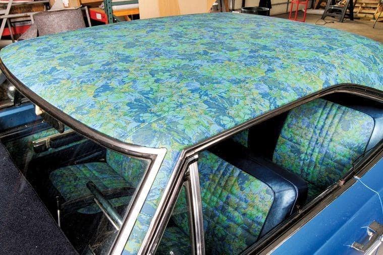

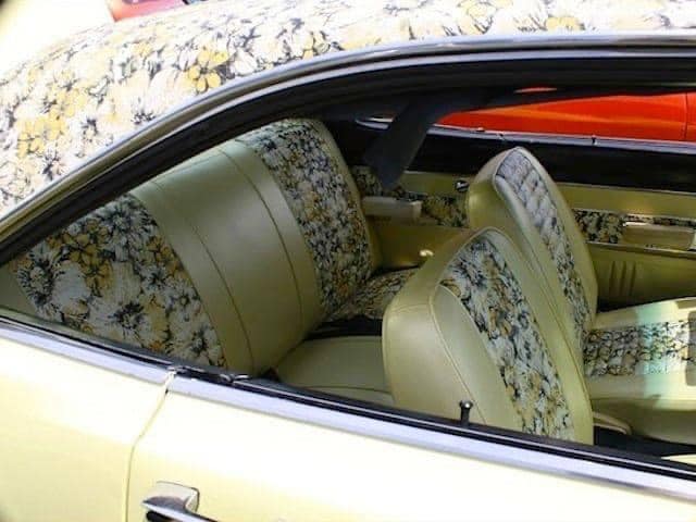

Since there are is a lot of Mopar knowledge here I am bringing this thread back to life for a reason. And the reason is...I have a mod top question concerning the interior. Were white vinyl seats with floral inserts a factory option?
I have seen a very nice 69 mod top satellite with both the V1Q top and the F2Q interior fender tag codes. It is a white car with a white interior and floral inserts. It has no broadcast sheet. All the mod top satellites that I have seen pics of have turquoise vinyl with the floral inserts.
Good info. Thanks!
With more research I have decided the satellite floral interior option were not available with white vinyl. It sure does look good though, although not factory.
