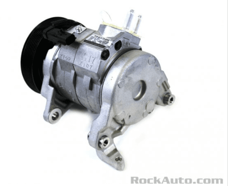

From Rock Auto this is a 2006 Ram 5.7 compressor... Looks like a fixed swash & designed to bolt directly to the engine...

You'd be ahead to just use an oem one, they have so many models with different mounting, you'll waste time trying to make that free one fit when the right one bolts on immediately
As Furious 70 mentioned it would probably be the easiest method... Did you get a complete 5.7 take out? A bare 5.7 or a crate?
Thing is on most modern engines all the components bolt directly to the engine in an effort to reduce NVH (noise, vibration & harshness) & simplify assembly line operations..
