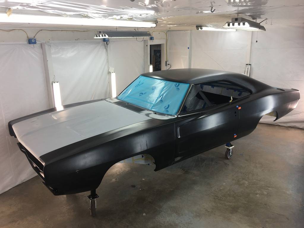

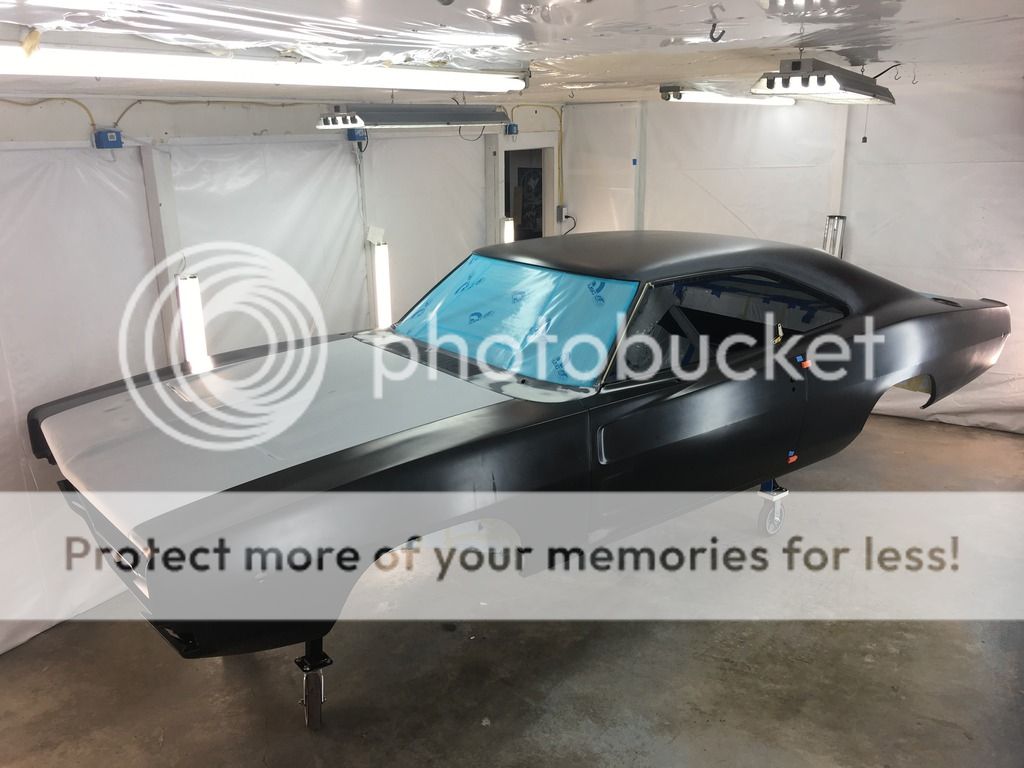

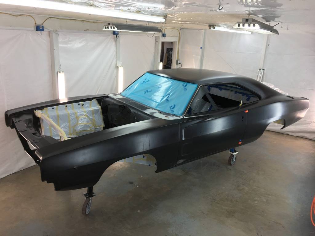

Doors and fenders are closely aligned after a lot of massaging. Just need put the hood on and then I can start on the final gap alignment.

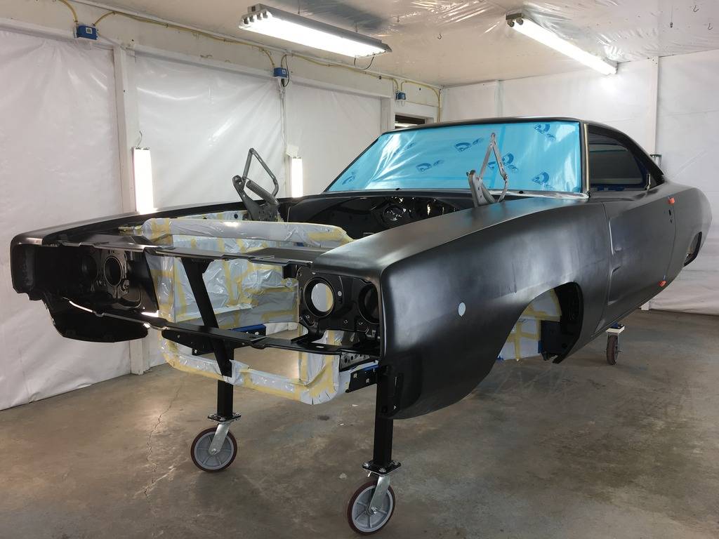

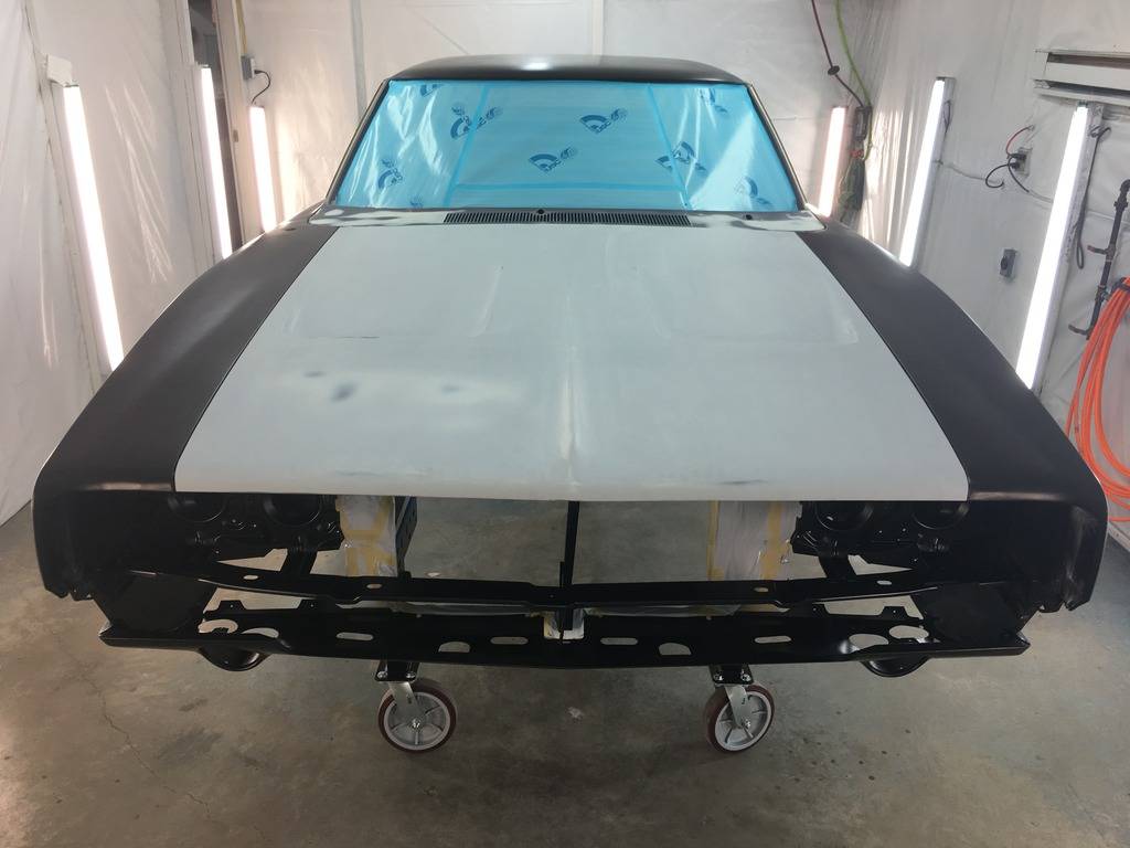

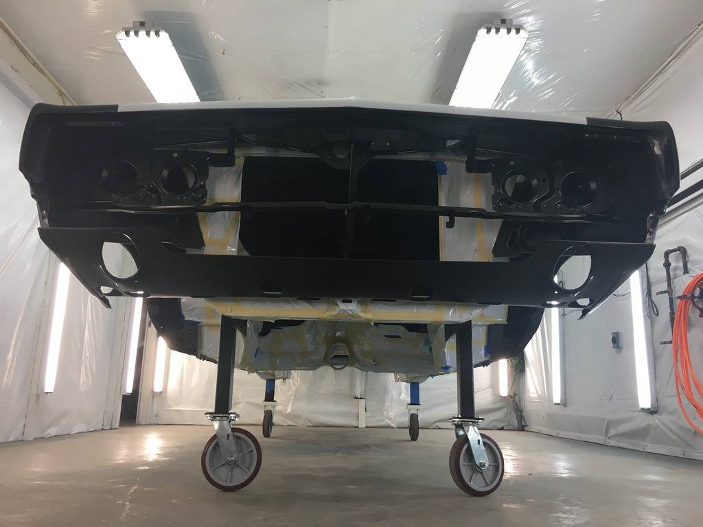

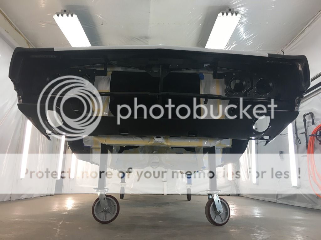

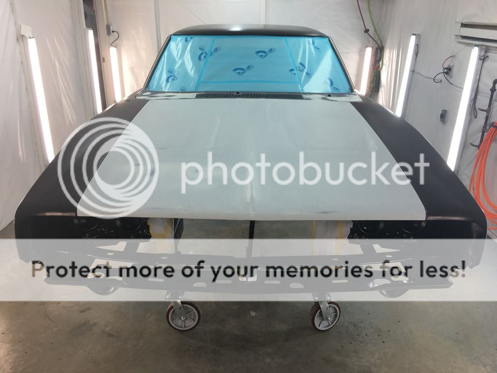

After a few small modifications to both front fenders I installed the front valance and the hood. The trunk lid is next and then I'll start fine-tuning all the gaps.

Pat , will you paint it together or pull it back apart? I usually paint mine apart but it is a pain to reassemble with out chipping the paint. But I hate over spray in the door jams or tape lines.
I will do all the bodywork and primer with the car assembled. But will remove the fenders, doors, hood and trunk for paining. Drilling the hinges for relocating, along with using small rubber hose on the door edges to prevent any chipping has worked well on my other cars.

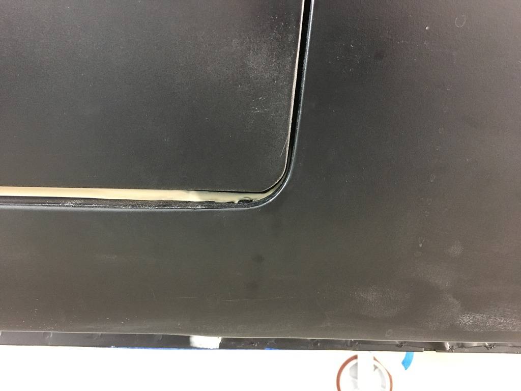

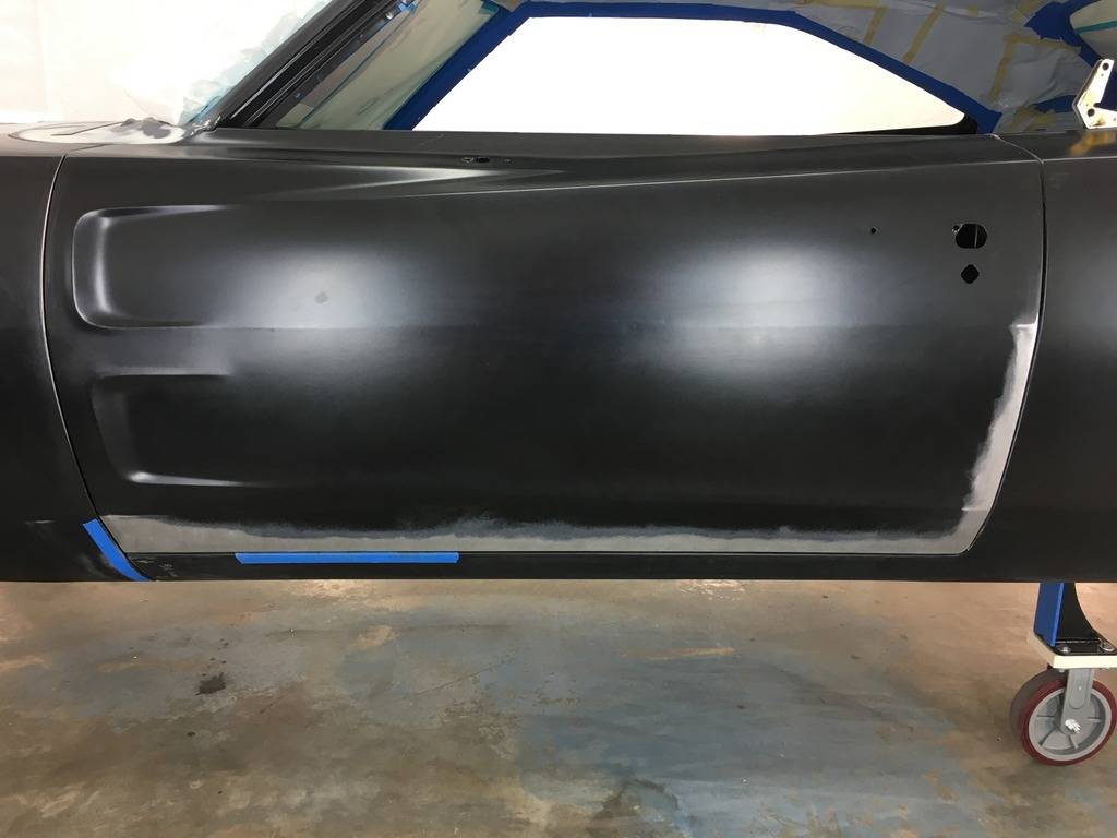

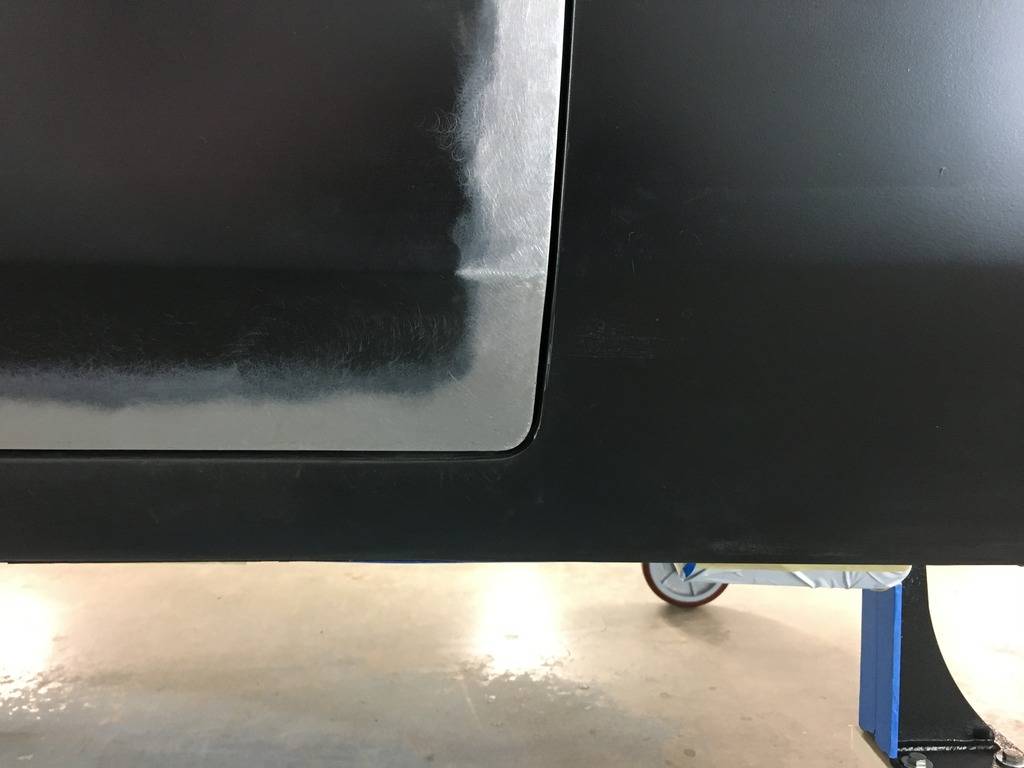

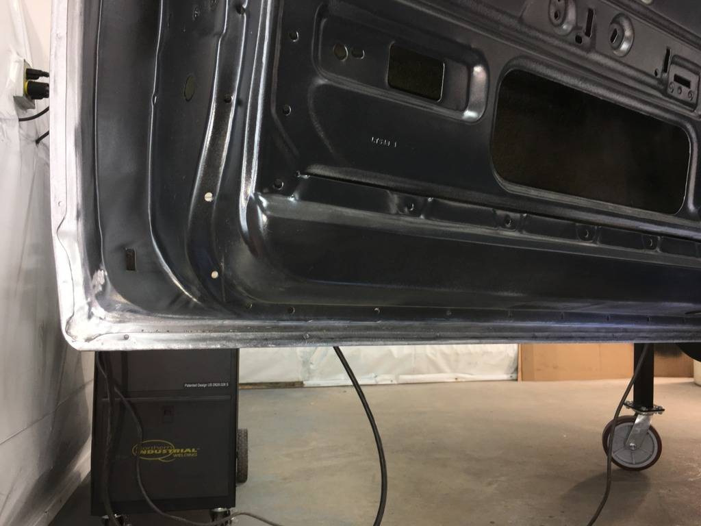

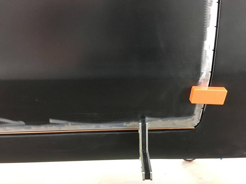

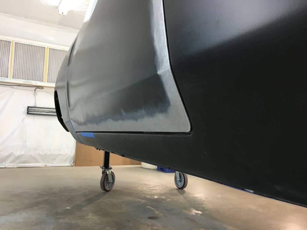

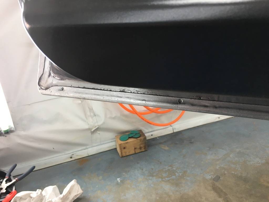

Welded and filed the drivers door gaps. I set the sides at 5/32" leaving room for primer, sealer, base coat, and clearcoat. I had to weld a rod across the bottom of the door to close up the large factory gap that varied between 5/16" and 21/64. Now the bottom of the door is a consistent 7/32. Next up is the passenger door.

How did you weld a rod to the door and make it disappear? Does it not show on the inside of the door edge? Just curious about this technique.
I stitched weld the rod (1/8" ER 70S-3 rod) on using a mig welder. Then I used a 2" grinding pad (40 grit) on a small air 90° die grinder. As I stitch weld I use the grinder the knock down any high weld to help find holes. This also helps keep the welds thin and the welder turn down to keep the heat
low in the panel.

I'm not sure if this is just the B body thing but my other charger was the same way with a heavy 3/8" close to a 1/2" gap across the bottom of the doors.
