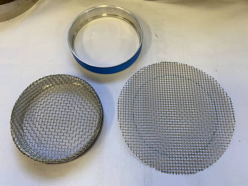

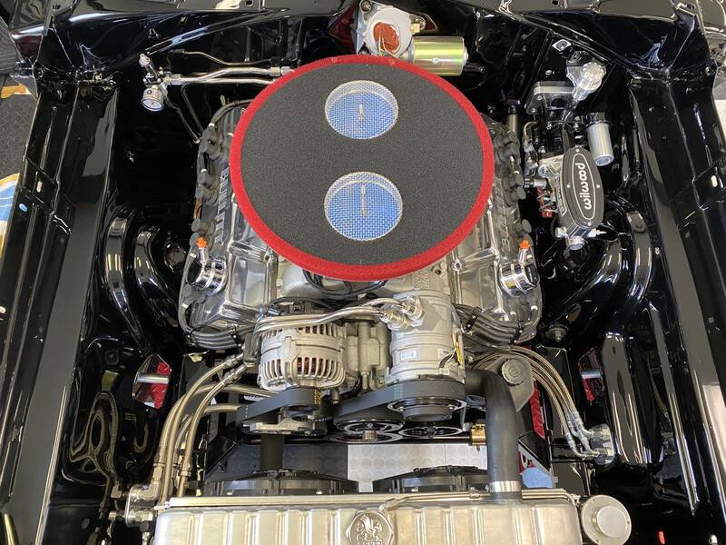

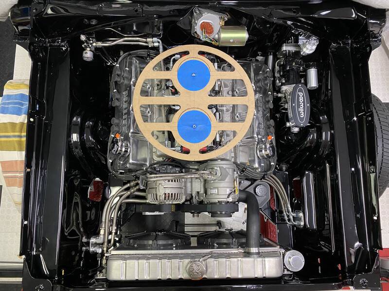

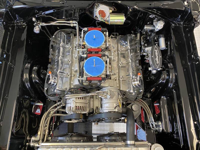

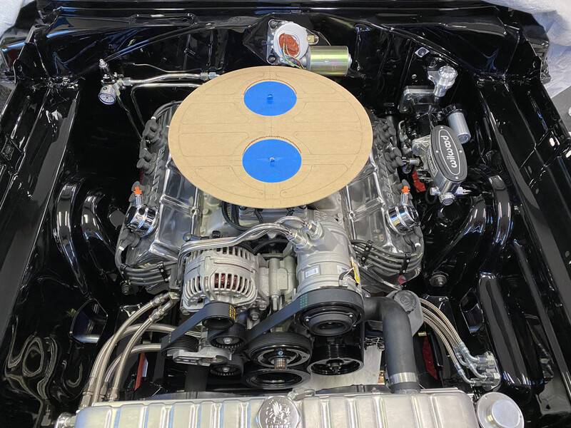

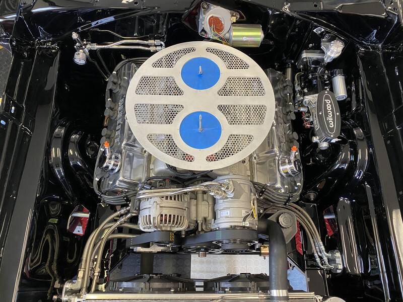

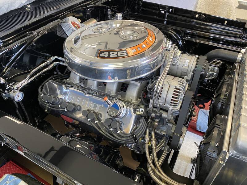

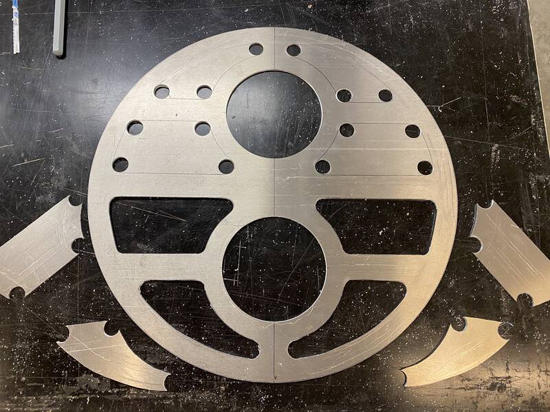

To get the hood clearance for the 1968 hemi air cleaner I had to make a custom base and air filter. Started with a cardboard template before making it out of 1/8” aluminum plate.
I think the 1” velocity stacks worked well.
Thanks and happy holidays!
Pat

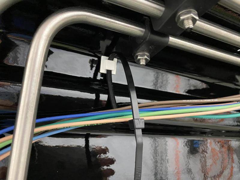

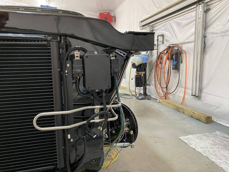

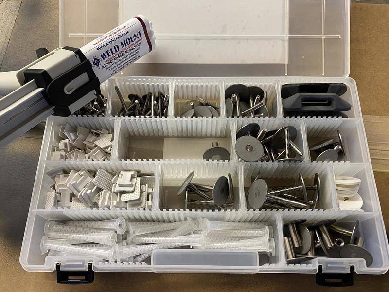

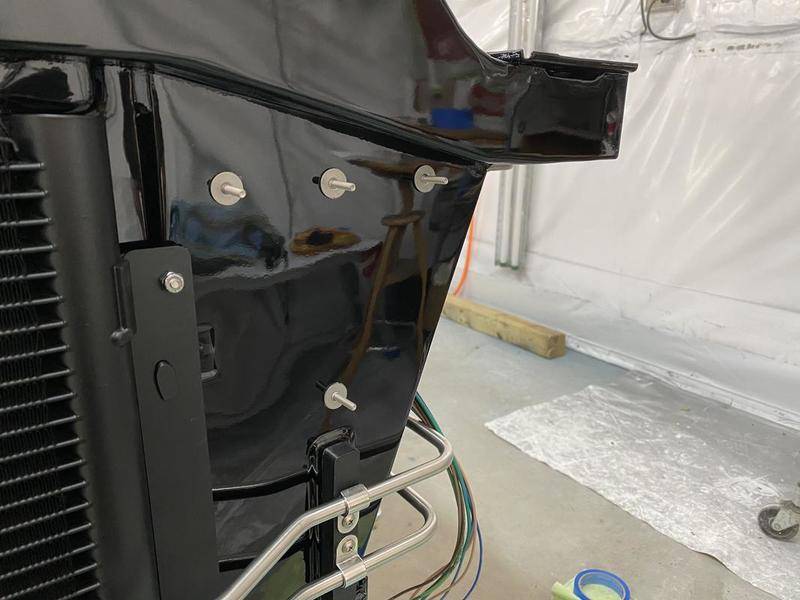

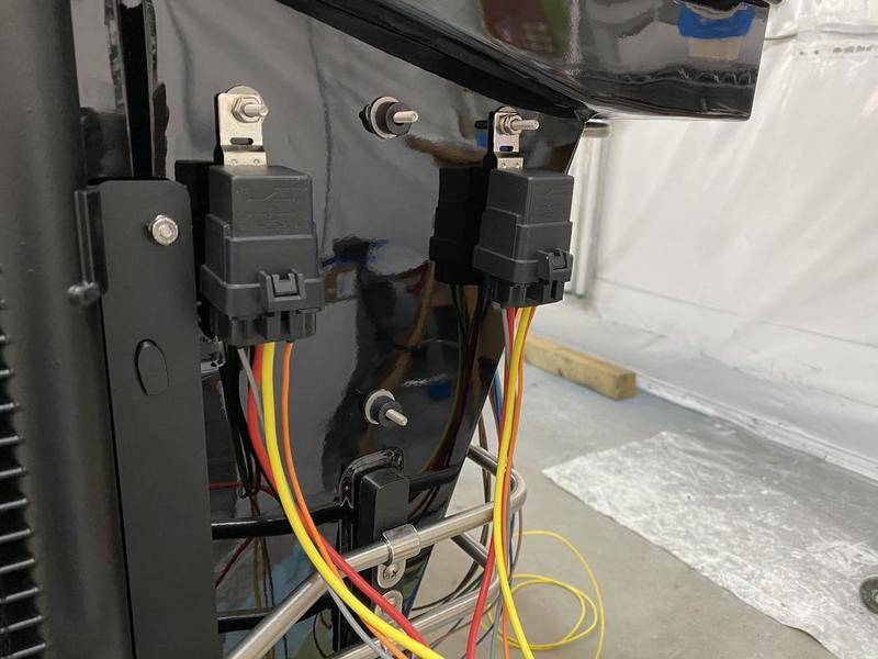

Weld Mount is in acrylic adhesive mounting system with a wide variety of very cool fasteners. We use it on the boats when we cannot drill into a bulkhead, fuel tank, or hull sides to mount or fasten equipment and wires. I used it to mount a few fan relays and headlight door operator To keep the engine bay clean of fasteners. Very cool stuff, easy to use an extremely strong!
Thanks
Pat
