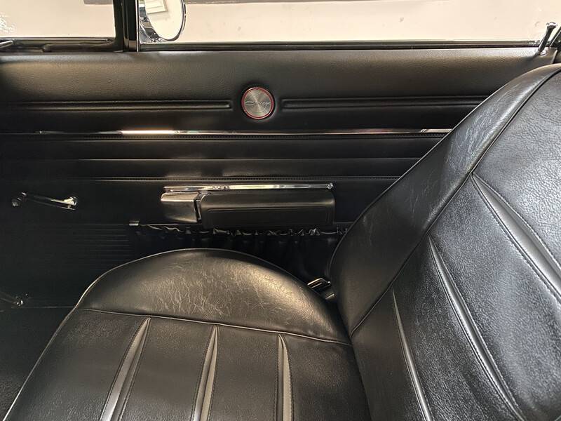

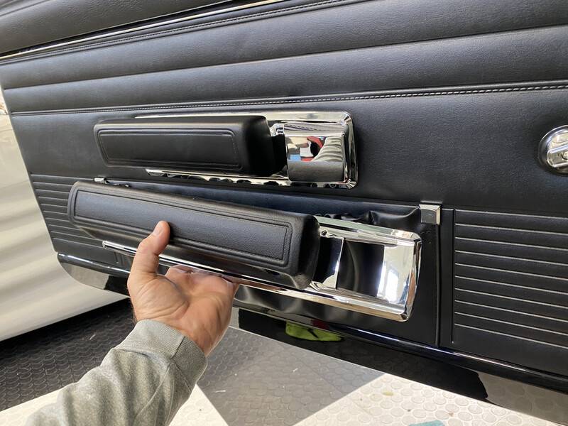

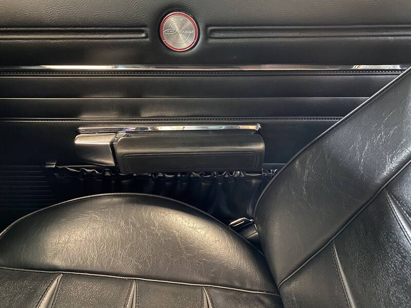

FYI can’t use the legendary rally seats with the standard charger long armrest. The side bolster Hits the last 2 inches of the armrest. It could work but eventually would leave a dent in the seat fabric. Not a problem if you’re also replacing the door panels but if you reusing your door panels they will be an imprint from the longer armrest base.

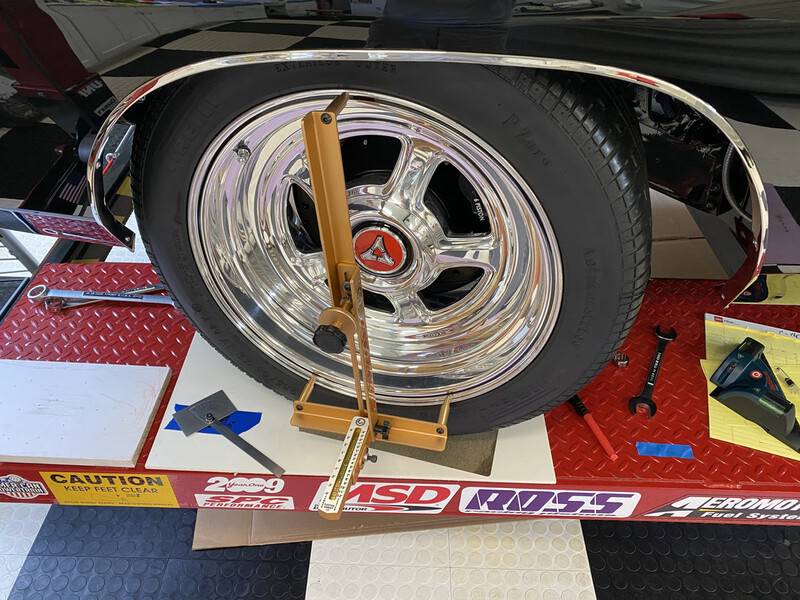

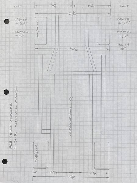

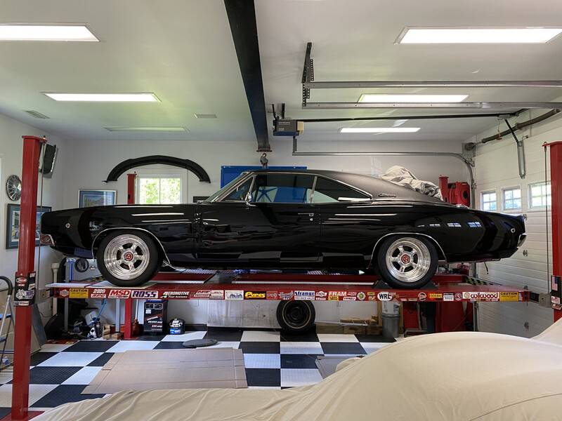

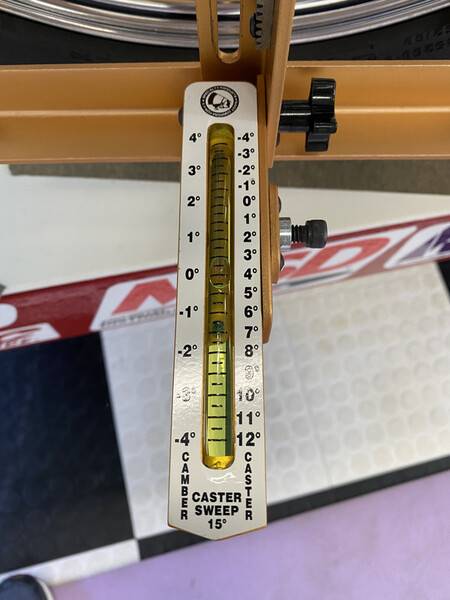

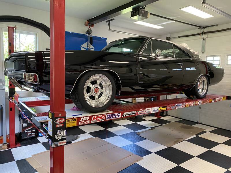

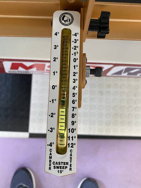

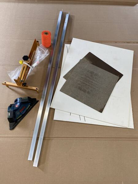

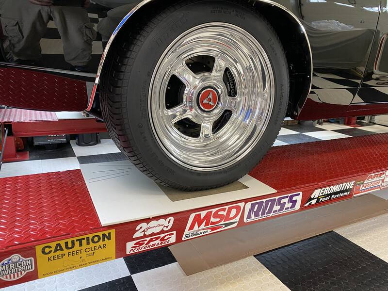

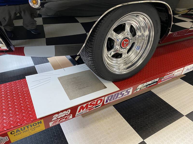

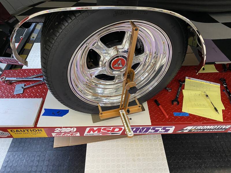

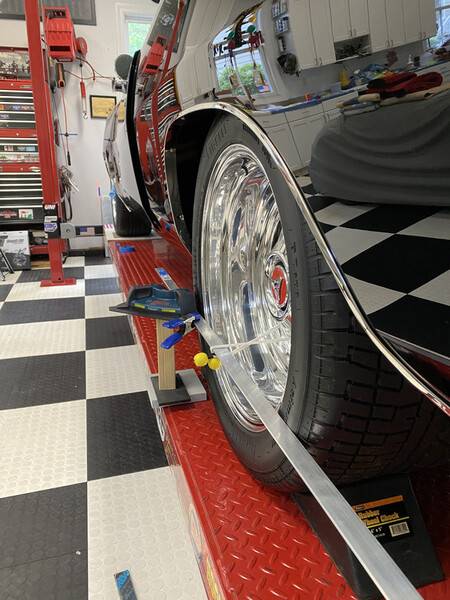

Today I aligned the rear to the body using lasers. This confirm I welded in the 4 link 5+ years ago correctly;-) Then I did a front end alignment with my Fastrax camber caster gauge. Starting by rolling the front wheels onto a piece of plastic and thin piece of Formica. This allows the front wheels to turn and the suspension to relax. Camper was set to -.5° and the caster was set to +3.8°. Toe in was set to 1/8”. I was very happy with the rear end to body alignment. I guess all that check, double check, and triple checking before I welded in the rear suspension paid off;-)

Outstanding work Pat, hope you plan on hanging on to this one for keeps!
Very cool....she's come on a long way since I last looked in. I use a similar technique for front wheel alignment but being a cheapskate its no Formica for me! Putting the tyres on old glossy magazines has the same effect as the pages easily slide over each other.
Sounds great and looks even better, excellent work:thumbsup:

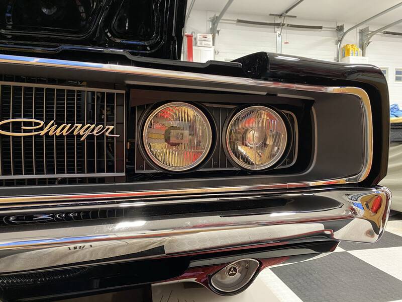

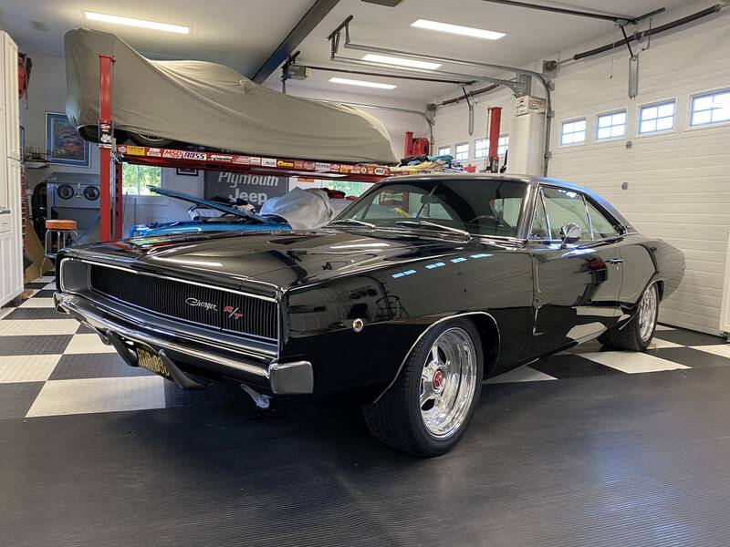

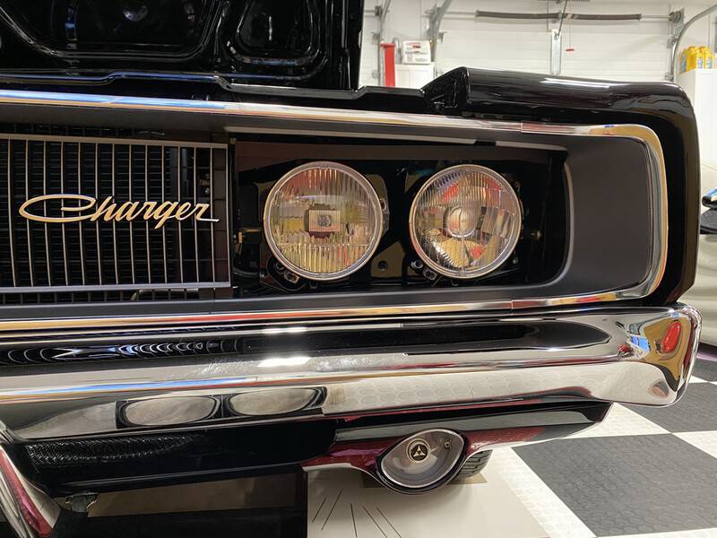

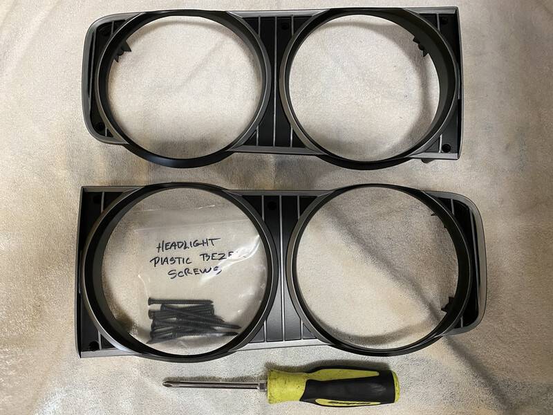

Aligned the low and highbeam lights and installed the plastic bezels.
Also picked up some new garage art

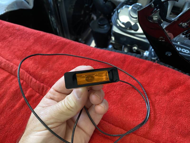

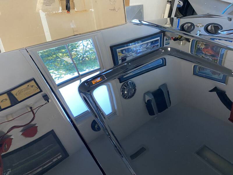

Finally got around to blacking out the hood turn signal lenses. I used black vinyl that matches the paint great.

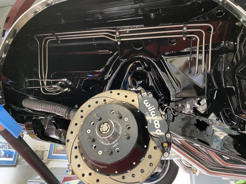

And I got the driver side front fender splashguard and stainless tubing covers installed

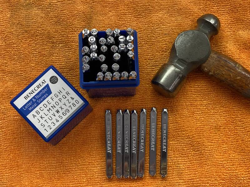

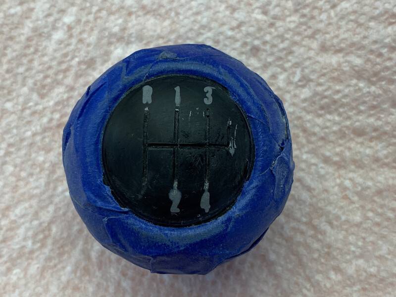

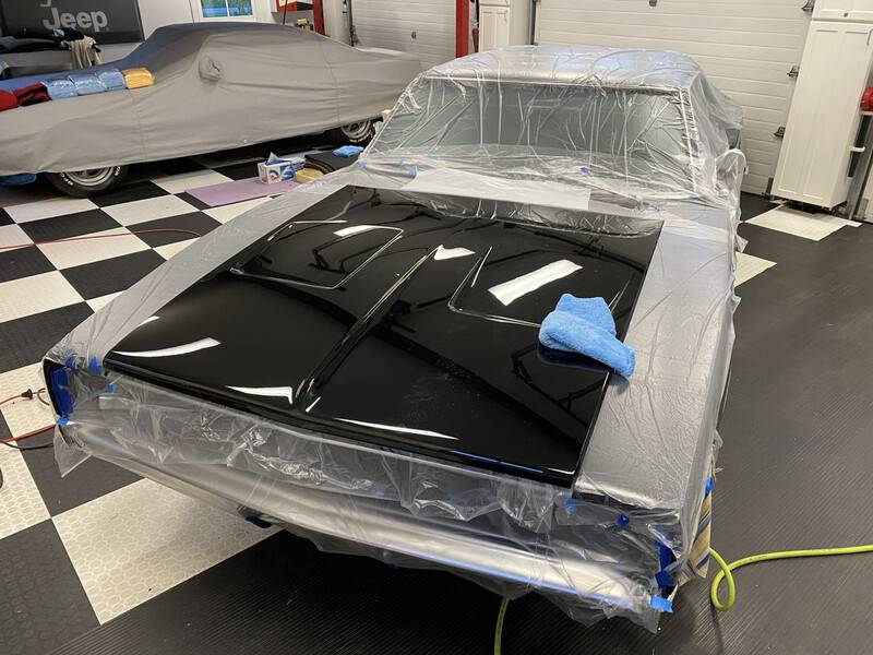

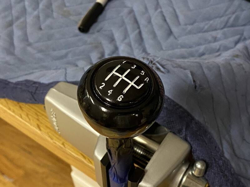

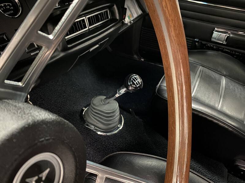

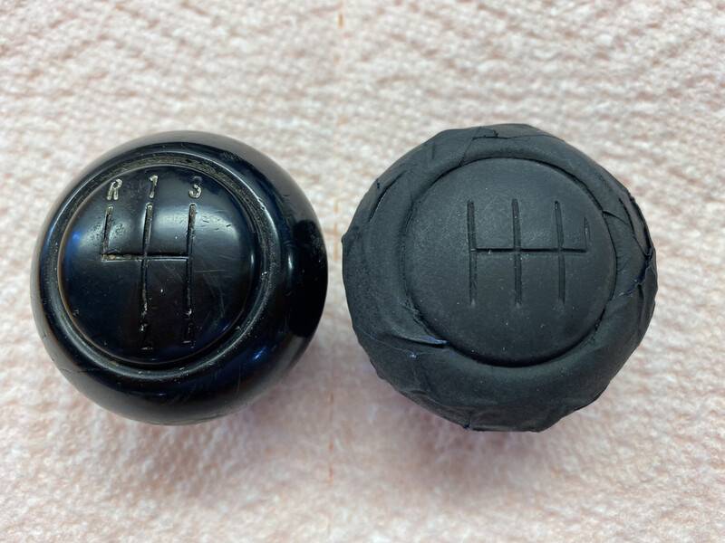

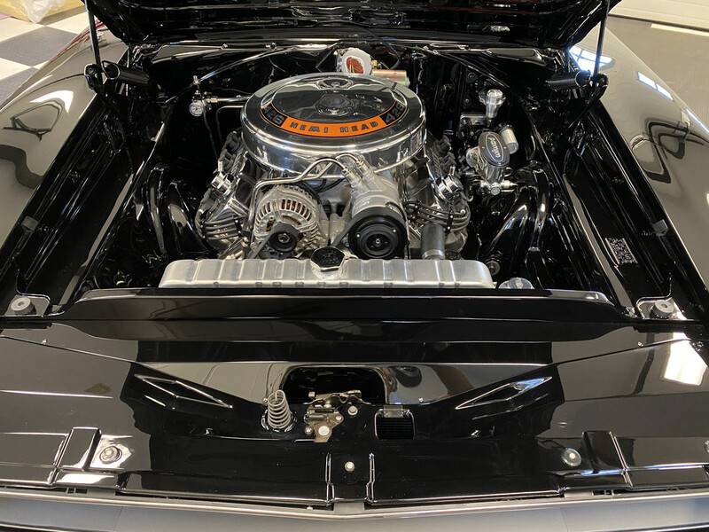

Almost ready for Carlisle. Last polish and ready for ceramic coating. A few details left but I did make my own 6 speed Inland shifter knob out of a 4 speed knob. I was unable to find a engraver that could engrave on a curve So I used number stamps and hand carving the new shape. Looks good from arms lengths;-)
