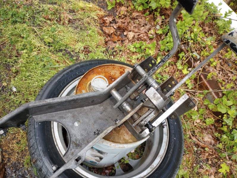

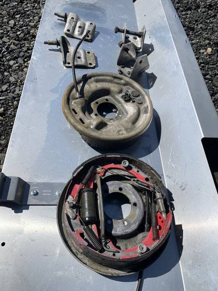

Fresh out of the molasses drum, these were rusted solid from sitting out in the weeds for decades, starting to flash rust already after hitting with pressure washer. 7-1 water/molasses and 3 week soak

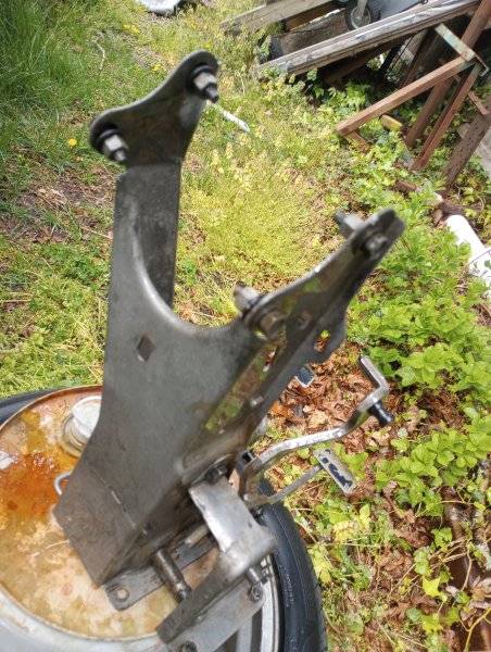

I have a bunch of stuff de-rusted over the winter with molasses. Works great. Just waiting to get some warm paint weather. 2 sets of headliner bows, couple battery trays, couple clutch/brake pedal assemblies, wiper arms, brackets, etc. After washing, I immediately dry with a towel and then hit them with a hair dryer. Keeps the flash rust to a minimum or none at all.

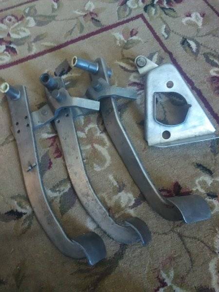

Here's a set i did. You have to wash the residue off when you pull them out of the molasses. It's almost like a black greasy substance but a little soapy water and brush will clean them up.
A bucket heater will speed up the process but the "Stink Factor" will increase exponentially. DAMHIK.

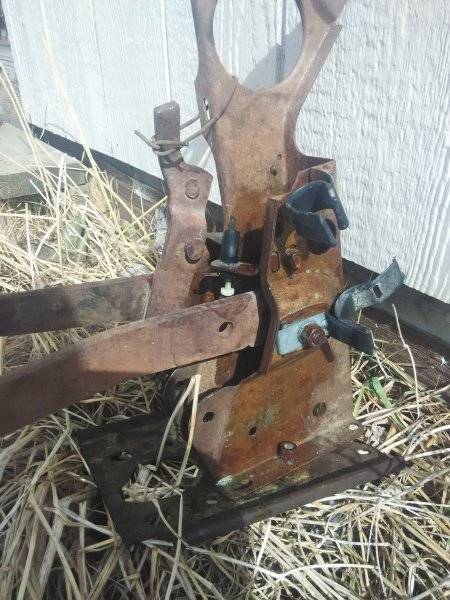

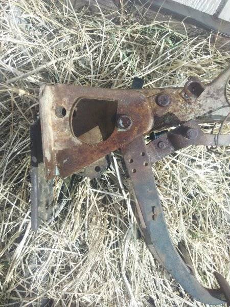

Mine is sitting on my heated concrete floor and stays 68 degrees. My first batch of parts in December made a bunch of jell like goo, and after I skimmed that off it never did it again. The brake parts were the fourth batch from this same molasses. My parking brake pedal assembly was really bad, after the soak it moved freely and looked great.

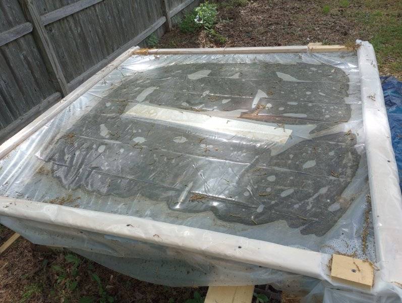

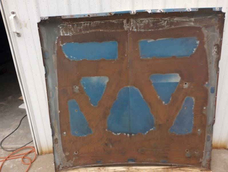

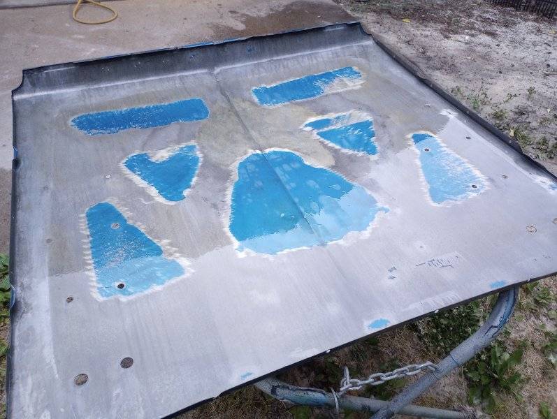

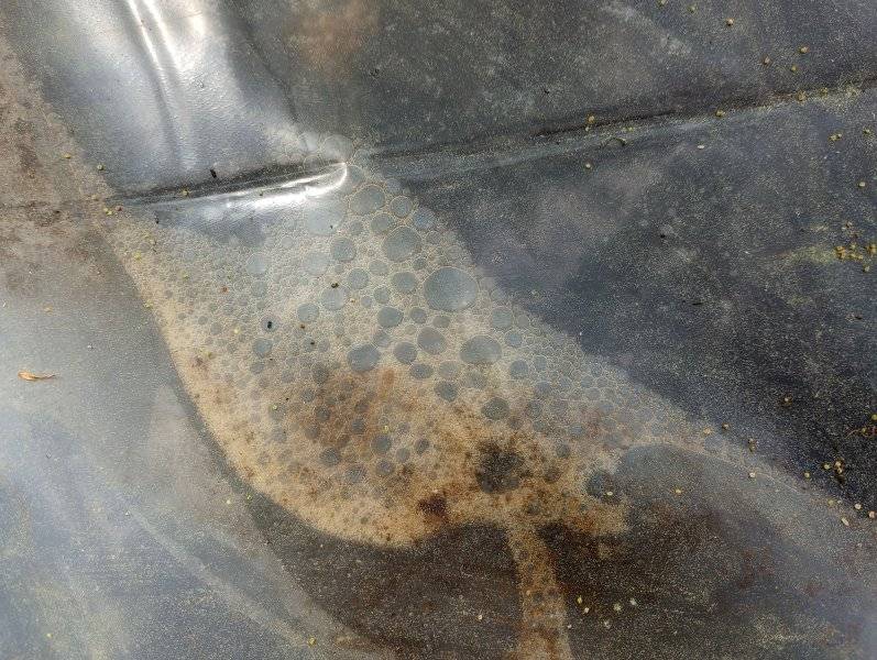

when I did the hood skin, it made bubbles under the plastic.........it was actually a year ago, so May; not overly hot, but certainly not cold....... anyway, the bubbles stopped after about 3 weeks, so I figured that's when it was done. I pulled it out a week later

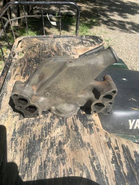

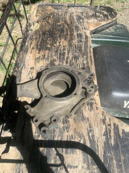

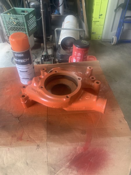

i just started my soak recently. first item out was my water pump housing. it came out nicely, 99% of rust eliminated. power washed as my wife was doing our decks at the same time. cast iron cleaned up in a week , the steel parts seem to be on a different schedule…..
