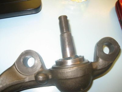

I'm rebuilding the front suspension on my 66 belvy and i noticed that the ball joint to knuckle mounting surface on the ball joints are not machined like the original ones. This does not seem right to me, anyone notice this? Should i try to look for another pair? These were around 55 bucks a piece, and even the cheap ones were not machined on that surface. It just aint right. Heres a pic of what i mean. (yes i know the pic shows opposite sides, but both are the the surface that mounts to the knuckle.) Oh, and yes, they say made in USA.

The surface needs to be flush and milled flat or it will stress and crack.
I know... what am i supposed to do? I got orielly cheapies and they were exactly the same as the moog ones. If the moog ones are bad, then what choice do i have left?
Got my hands on a set of spicer ones... The exact same way, if not even worse.
Neither side of the joint are machined? Take em to a machine shop is all I know. If they are being supplied that way to the locals, they are probably going to be like that to the on line companies too....?
the side with the crown nut is machined, but the knuckle side is not... the old one had both sides with a very nice finish. This is slightly crazy...
Well i bit the bullet at went at it with a large flat bastard file. I think this will work. I'll probably email moog to tell them what a crummy job they did with these ball joints.
An SOB file will finish em off just nicely :D
not sure why everybody is worried about a machined suface.the ball joint is held in place by the machined holes through the casting,not by the tortional pinch on the edges.its all about the bolt,not the mating suface.thats why all the companys leave them as cast.hopefully you didnt take too much off of them and cause a distortion of the lower arm.
If two flat surfaces mate together, shouldn't they both be flat? The bolts are supposed to hold them together and if they don't mate flatly, then the bolts will have uneven stress on them instead of straight shear.....

001.jpgI bought these from Summit Racing They are machined. Slowly rebuilding front end on my 72 Coronet.
you are talking about staped steel againts a cast surface.common sence would say it needs to be flat,but that is not where the stress is being applied to it.if it was the bolt would tear the stamped steel part.
