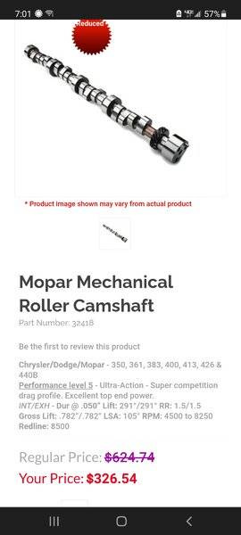

Crower has a big roller cam in stock and on sale if your still shopping? Reasonable too.
Edit: sorry wrong thread.
Yellow, that looks like one REALLY big cam that would need the BEST valve train to go with it, and a big motor with the heads to match.
I believe I put this in the wrong thread. :rolleyes: Someone was looking for a big roller cam (292@.050) and they were back ordered...?? You are absolutely right on VERY costly parts to run that cam. It's cheap enough though, it may be possible to have it reground with a smaller base circle?
Most likely a 102 to 99 ICL to boot. A long rod motor would make it worse.
