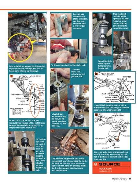

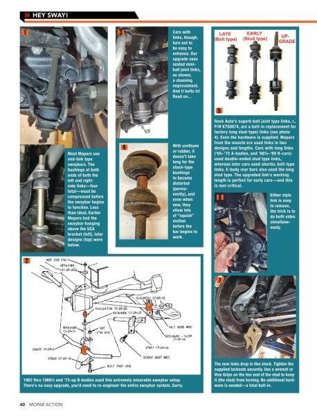

Mopar Action Oct 2021 article re: swapping b body sway bar links with those from a recent Pford pickup for improved handling.
Soooo, Did anyone try it? Notice a difference?
Looks like it eliminates the bushings completely.
No idea if they will fit.

Couldn't you get the same effect using poly bushings?
The point of these replacement units is that they swivel without compressing. There is no lost motion due to the compressing of bushings. Urethane is a lot harder than rubber but will still compress and deform. Awhile back I disassembled the front suspension in my car and found that the sway bar bushings were loose and distorted.
THIS upgrade makes sense to me.

Now installed on my Road Runner ... is there a difference? Initial thoughts in limited testing are definitely yes. I perceive more stability at highway speeds (or greater than) + being able to take tight off ramps at higher speeds then previous. I have yet to really to test any real curvy roads as they are so few around my local area.
Your mileage may vary of course depending on your suspension; those with upgraded suspension (Borgeson, tubular control arms, hotchkiss, firm feel, pst parts etc.) it may not make an appreciable difference. For those of us saddled with
stock type suspensions, for now, I would say a worthwhile upgrade for $45 cdn.

Another note to add... my sway bar bushings are in less than desirable condition; replacement of the sway bar links as describes may change the characteristics for even better.

A quick update ... after almost 2 weeks, still very pleased with the upgrade to these sway bar links even though I have yet to address the sway bushing replacement. No negative issues noted to date.
Anyone have dimensions on the Ford part? My car has an aftermarket sway bar - want to compare with what’s on it. Thanks
1000 miles report- no issues whatsoever with the links. Enjoying the additional handling stability
An update on this conversion- results are still all positive. 2500 miles in.
