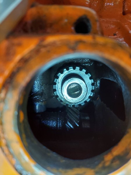

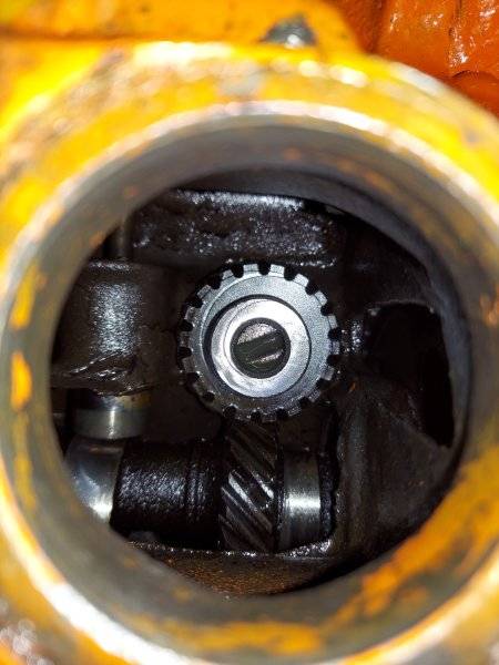

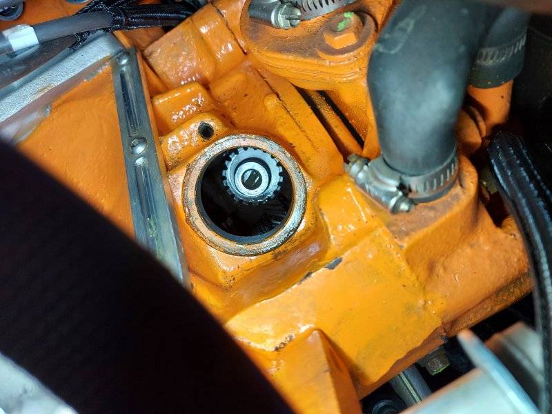

I cannot get the oil pump/distributor intermediate driveshaft out of the block and off the camshaft. I've done it a hundred times before on multiple engines but for some reason, this one doesn't want to come out. Before I do something stupid, I figured I should ask for some help. Help? Any suggestions or things that have worked for people in the past? I have tried all the tools pictured in the last photo, as well as heat, penetrant and some other tools. This particular engine is a 383 that has been rebuilt and ran many times before this issue. Engine is set at top dead center and I'm trying to pull it out to move it inline with the crank/cam to install a new distributor. Thank you.

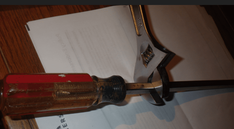

I use a large Craftsman blade screwdriver and an adjustable......
I can work it back and forth to get it to climb up for me. Some extra oil may help.
If that don't cut it, off the pump.

If the drive shaft in this engine is an aftermarket item, then it has probably worn, built up a burr preventing it from coming out. Also, sludge on the shaft can make removal difficult.

If you have a large enough box to fit the plastic handle. You just take a picture where slot in drive gear is now and put it back the same place. If you turned engine over since removing dist you need to #1 etc. Are there metal chips near lifter in picture ?
If your oil pump is dragging or tight that it won't easily spin. It will prevent the shaft from twisting out easily. It won't pull straight out due to the 45° cut gears. If this is the case ? You can put a socket on the damper bolt and rotate the engine it in reverse rotation and it might come out by itself. Maybe?

You will need a flat head screwdriver larger than the one that's in the picture. Turn the screwdriver counter clockwise until it climbs up the gear (more than the last time) then turn the screwdriver the other way until it's all the way down. Keep doing that and it will come out.

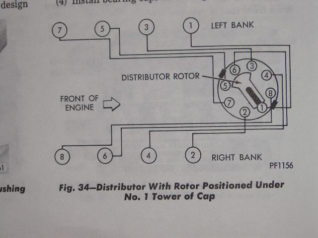

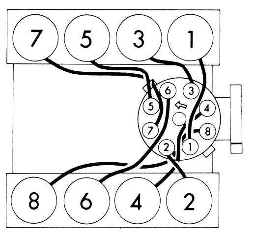

Here is some info from the Factory Service Manuals that may help other members in the future.
  • 383-440-DISTRIBUTOR OIL PUMP DRIVE INSTALL.pdf
