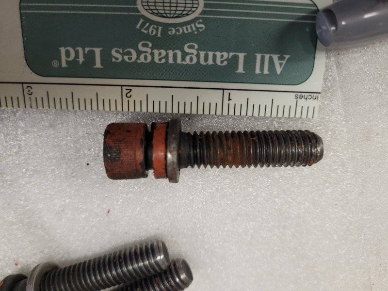

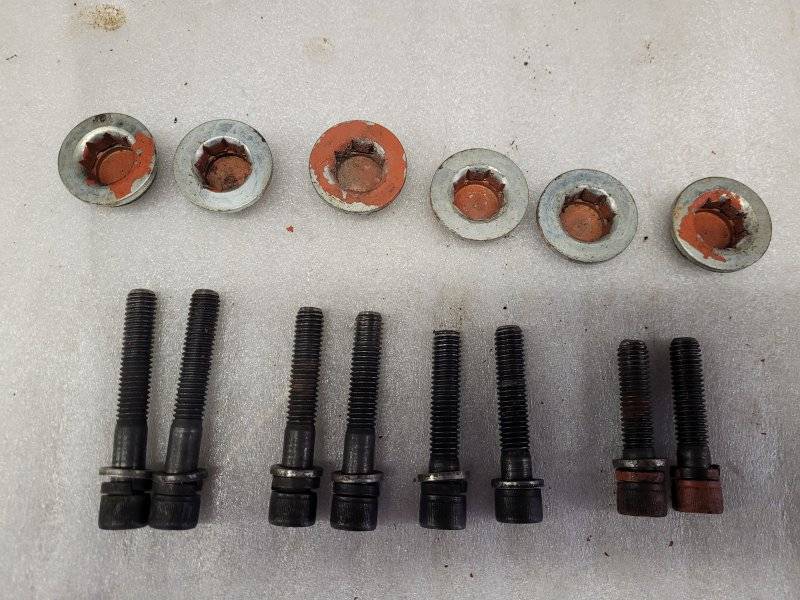

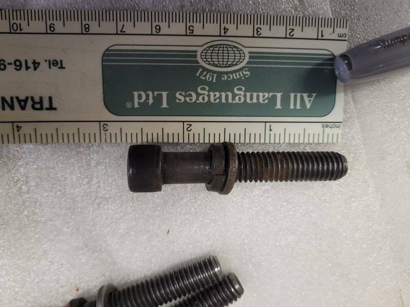

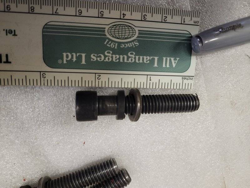

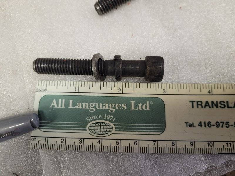

I don't know about hemi's, other than the lids need the gasket retorked occasionally.
For the maxwedge crossram, front to rear they are all different..... and the lengths are cast into the top of the manifold. (At least on mine they are)
I have found the recommended lengths are a bit long.
Wedge..
2.5, 2.25, 2.0 and 1.75.
