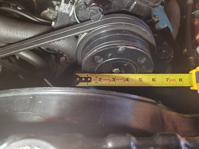

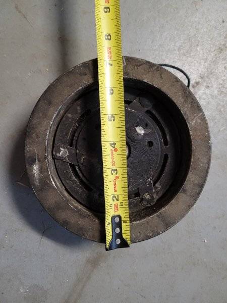

Hi All. Since I do not have a mopar RV2 (1960s-70s style) air compressor to measure. I was hoping that one of you guys could measure the pulley diameter for me...Thanks By the way my car is a 62 Plymouth Fury if that matters.

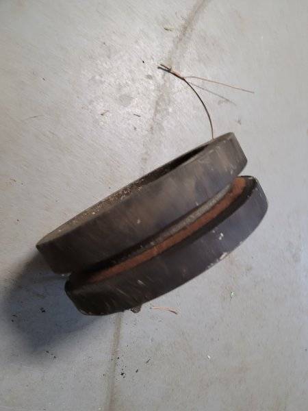

As others have stated there are different ones for different applications. I have 2 67 compressors, 1 from a 318 Belv and the other on the 383 Satellite. SB has a larger dia., thick pulley and uses a single belt. BB is much smaller and thinner and uses 2 belts.
