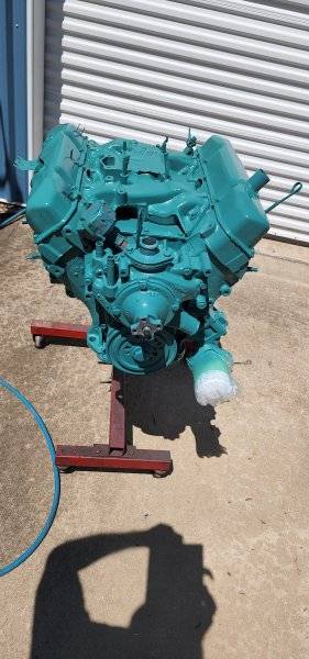

This photo, from a mid 70’s, show a rebuilt (in progress) and repainted block from a ‘68 RR 383. I know the picture is sideways but it gave a full view and it’s really just for color comparison. I don’t know the type of paint but it was high temperature engine paint.
Here is underside of intake; which we thought was original paint. Color matched to paint engine and it was too green. Ordered Bill Hirsch and the difference was apparent. The “splotches” are the BS paint next to it. Perhaps a change in color by factory, perhaps with heat. All I can say the original match we tried was too green.
Makes sense that it’s probably a re paint as the transmission is blue (a833).

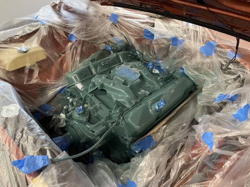

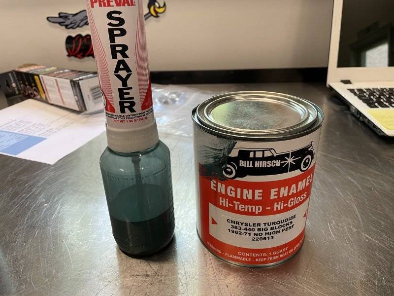

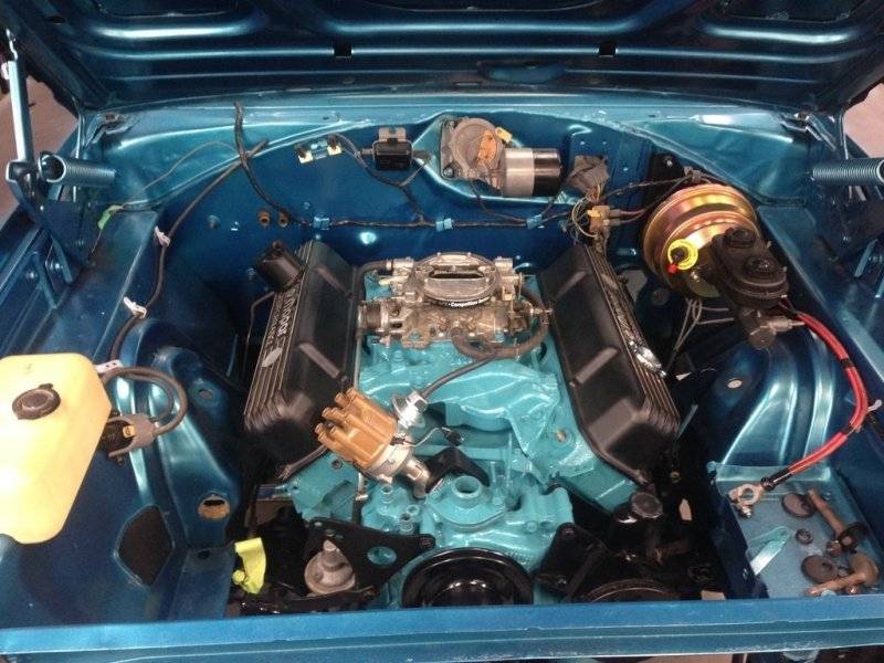

This thread is timely for me because the VHT "Chrysler Turquoise" paint I applied to my 1968 440 turns out to be too blue. I ordered the correct paint (in spray cans) from Bill Hirsch back in April & like everyone else, he was having trouble getting product. He did get quarts a couple weeks ago and didn't know when spray cans were available, so I bought a quart. Bill says his paint covers all years that had turquoise engines.
I wasn't going to yank the engine back out, and today, I stripped the top of the engine and sprayed as much as I could. I used a Preval sprayer which worked out pretty good. The paint just needed to be thinned slightly to get the sprayer to work. Here's the end result ....

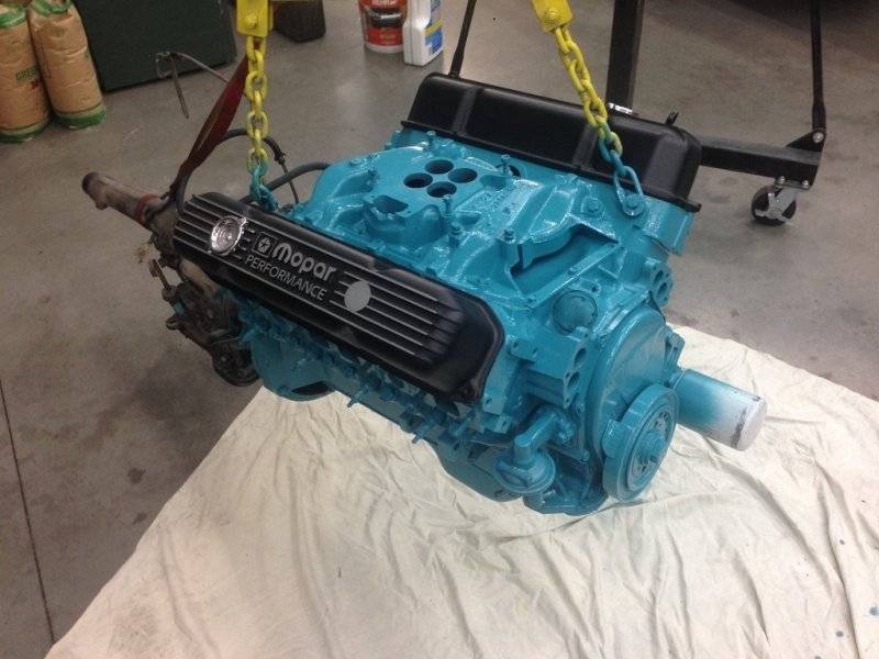

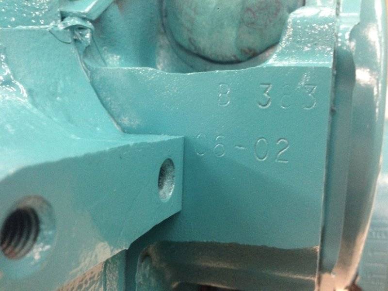

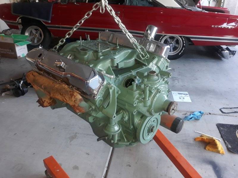

I am satisfied with the PPG formula that I just sprayed on my 67 engine.
I was told the best shade for the 67 cars was detroit diesel green
This is rattle can paint btw
As for WHEN it changed. Im of no help
The bottom picture is a little closer to how it looks in person. But it definitly has a little more green tint to it in person than my pics show on my monitor

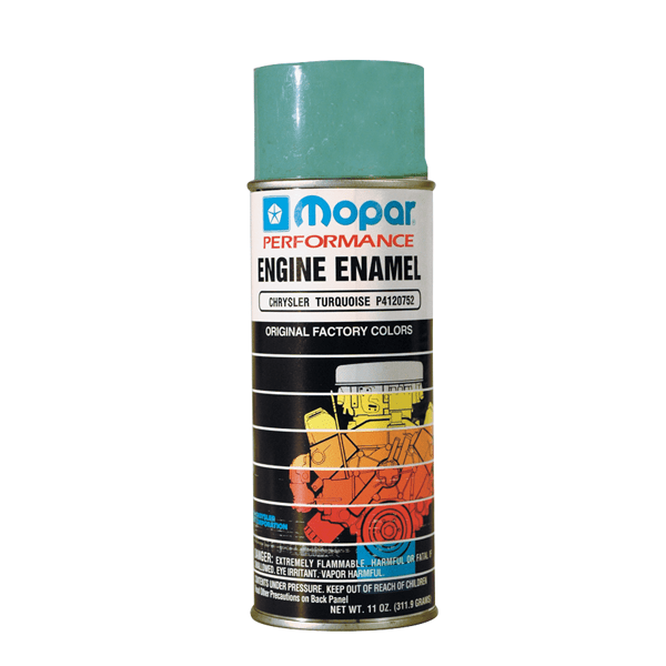

No Idea what years it actually covers
I'm not an overly ****-retentive type
it's close (or for me close enough) for the 68 RR Engine
Think I got it from Year one or Summit Racing probably
I have a can of that in my shop. I have no use for it, and I don't advertise it because no one will ship it.
I actually had some of that up until about 8 years ago. It was dead on to the color I remember. As I don't throw away much, I could still have a piece of can that's probably useless now.

That is what I used to freshen up the engine in my 67 GTX that I picture in my earlier post. It shifts color after a few heat cycles and looks generally correct To me with a greenish cast to it.
That's the turquoise I used too. Looks just the way I expected/remembered. Seems much better paint than the Mopar Performance race hemi orange I used.
If I remember right, the dealer was the only place I could find any turquoise, nothing at the parts places.
The problem I have found with previous MP paint that I've used (Hemi orange) was that it was thin as water.

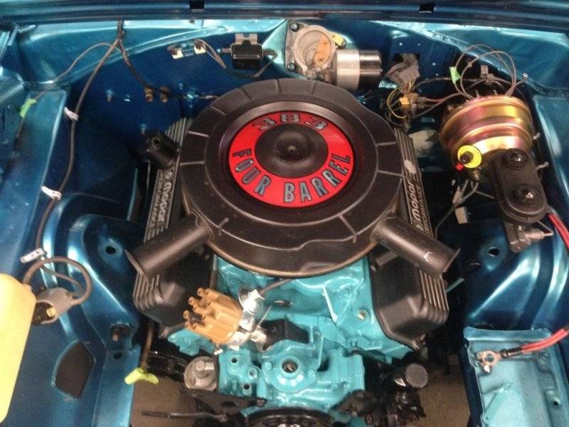

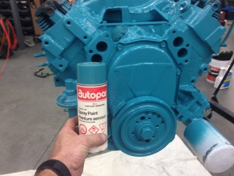

Camera angle and lighting play a huge part. These pictures are all the same engine. Believe it or not. The paint can isn’t what I used but I had a color made to resemble it.
Not to offend by any means, but the engine in post #18 looks like a repaint to me. Color looks like the later corporate blue, yet if you look close, the heads appear to be Turquois.
