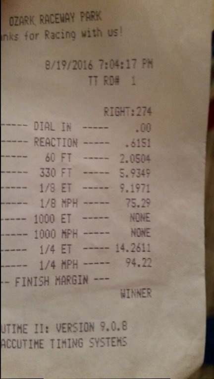

Last weekend I raced my 1967 dodge coronet 440/727/3.23 with best et 14.26 at 93mph.
Looking to improve ets.
Would I do better with 3.55/3.73/3.91 gears?
Thanks Mike

depends. lower gears don't work in stock or near stock combo's. low 14's at 93mph tells me there is a horsepower issue, not gear.
I would agree. Deeper gears won't gain you much if anything with this combo. Been there and done that.

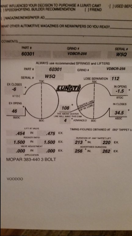

440 0.30 10.5 compression, edelbrock 440 preformer intake, 750 holley
Stock 727 with turbo action 3k stall
8 3/4 with 3.23 sure grip
A shift kit like a Trans-Go TF-2 will help. I was running 104mph with a very similar Combo. Your intake is a big cork too.

that cam doesn't need a 3k converter. in fact, the cam is way too small for 10.5:1. it would run fine with a stock 11 3/4" converter with that cam and may pick up a couple mph in the 1/4. i still say you have a horsepower problem, not gear.
How is this thing not cracking pistons because of detonation at that compression ratio and that small of a camshaft? Something doesn't add up.
It's got 915 heads. Engine shop told me 10:5......run 93.....which I do
Compression high cuz I ran low on fuel in ArKansas cruising around and gas station only had 87.......car was pinging until next gas station.
