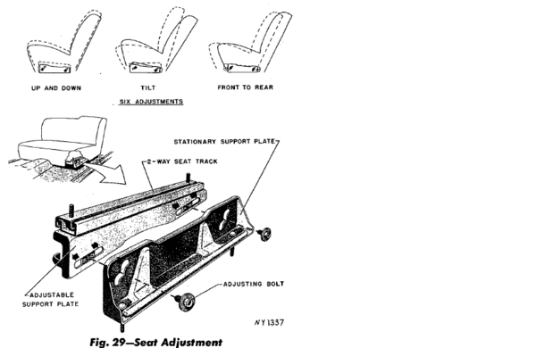

The 66 brackets are two pieces with bolts and semi-captive rectangle nuts sliding in "J" shaped slots.
I guess it's more of a stepped slot-
Looks like the bench brackets might be adjustable as well.
...and look at the drawing of the bench seat.
it's a pre-64 split back height model.
That suggests the early seat tracks might be adjustable too.
yep all the way back and all the way down.
Don't know if it's an option you would want to do. You'd also have to see how much room you have to work with.
Bottom halves of the mounts, cut more of the slots, to lower the seats.
