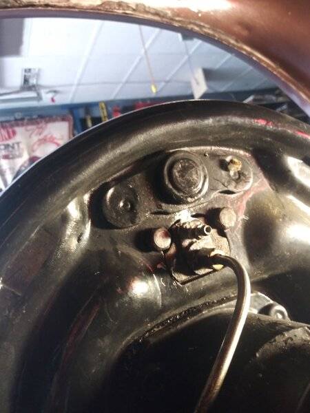

More picks drum id
Nick ciavarino
10:47 AM
Aug 3, 2019
189
29
New castle pa
More pics 64 sfury
20210421_103229.jpg 20210420_195042.jpg 20210420_181836.jpg 20210420_181831.jpg 20210421_103229.jpg 20210420_195056.jpg 20210420_181458.jpg 20210420_181733.jpg

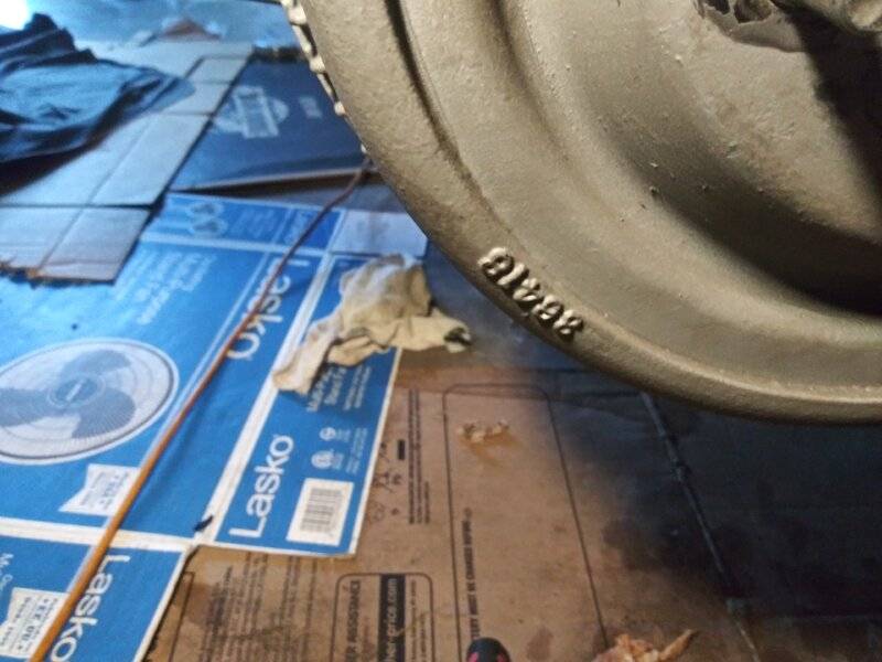

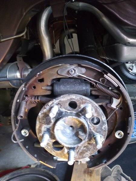

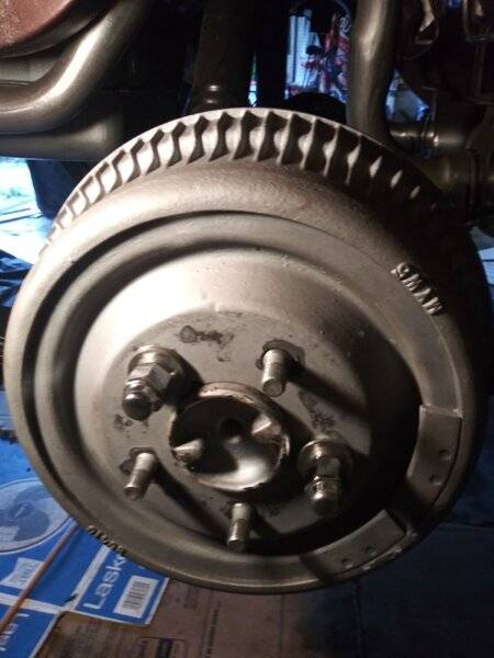

They look like the HD rear drums that my 70 super bee had. 11 x 2.5 rear and 11 x 3 front I believe.
Have you measured the diameter? Might be 11” but I didn’t think 11” had self adjusters. Possibly there were a few exceptions or they were adapted to them.

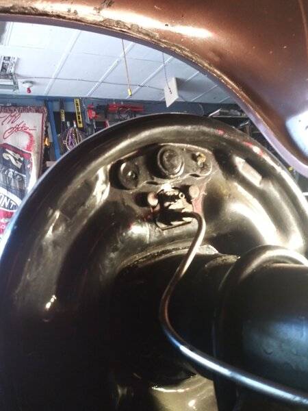

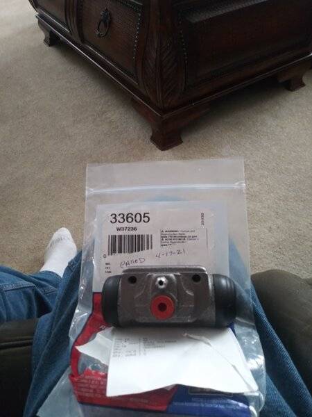

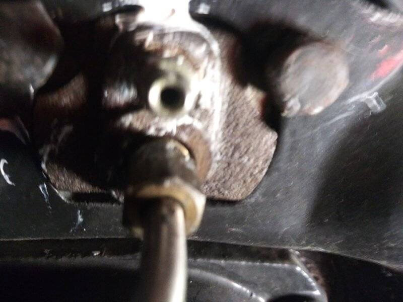

Thanks for all the input guys I just need a set of rear brakes that will work on my 64 i'm going to change out the wheel cylinders to 15/16 bore these shoes do not engage drums do measure 11 inch.Any help is very welcome Thanks Again.
Do they not work at all? Do they move with the drum off is someone pushes the brake pedal?
No sense in changing anything until you confirm a few things.
Did not drive car very much spent lots of time at ball fields with my G/Kids over the years.I hope that's the problem will change out hope it works THANKS AGAIN YOU ARE A VERY NICE PERSON.
Hope the wheel cylinders are the problem. Good luck and report back if that fixes the issue.
Starting in 1970 they did. Prior, at least according to the FSM, they didn't.
I'm just now upgrading all my 11" stuff to the later self-adjusters.
