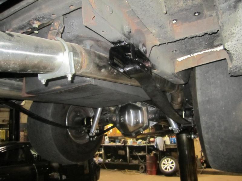

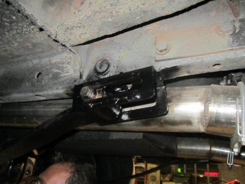

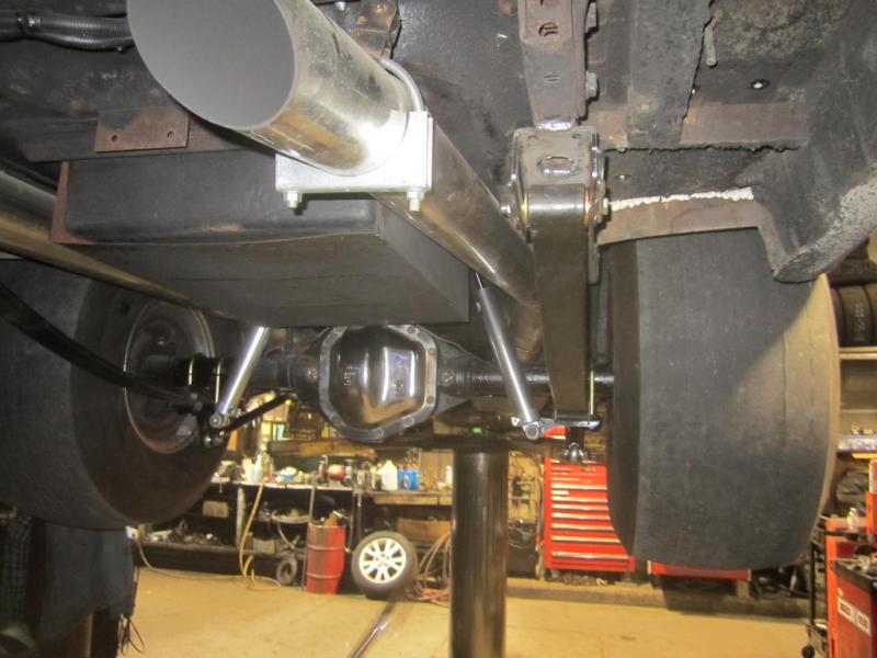

Been too busy to work on the car,BUT did make the time to go to E/town for the Nationals.

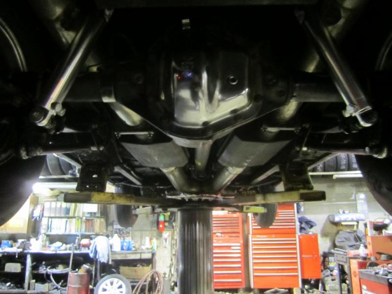

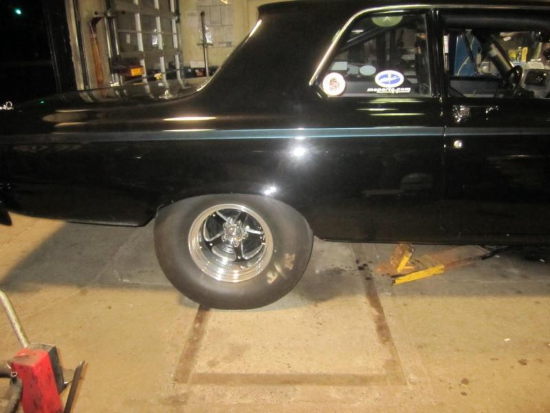

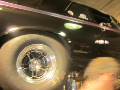

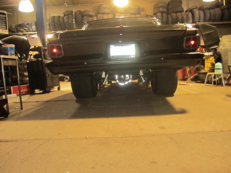

Also found the time to install the sliders and raise the front spring eye which lowered the car about an inch or more. Have not driven the car in a few weeks.

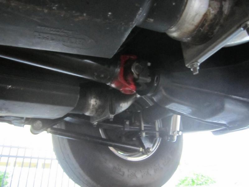

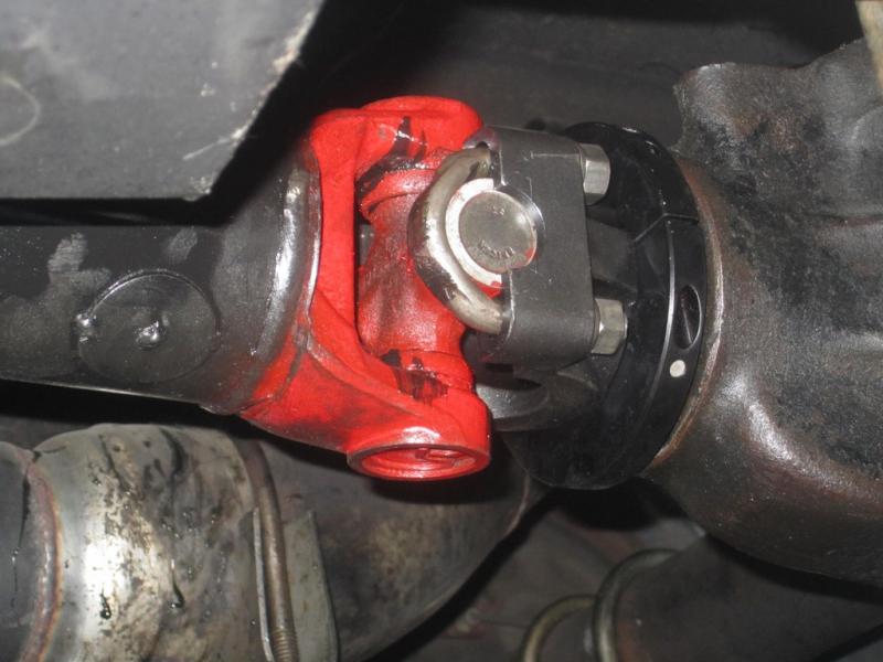

Had to replace the rear yoke for the drive shaft sensor then shorten the 3 inch shaft an inch.

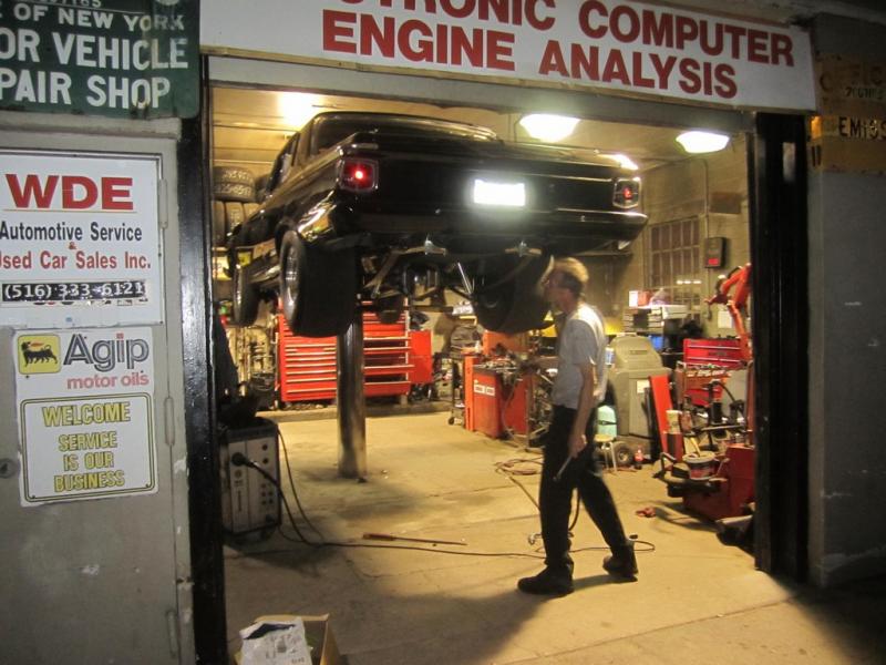

Wow, that's. Bad *** set up you have Hemi - both the car and the garage. Wish I had 1/10 of your skills and set up. Sweet. Thanks for sharing all of this...
