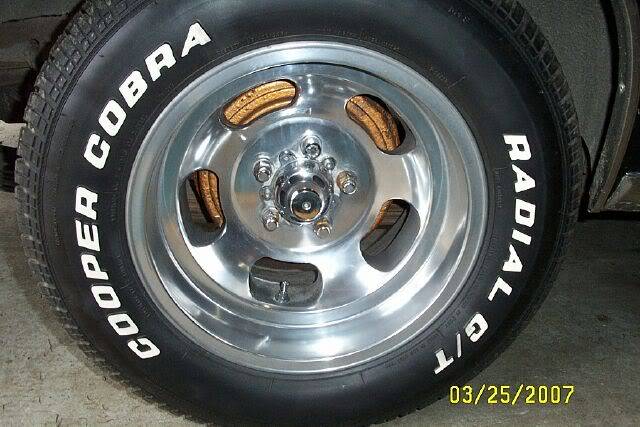

Mothers Aluminum polish used with a power-ball in electric drill motor. Wheels were oxidized for maybe 8 years of sitting outside
Looks great! did you use the large power ball, or the small one?.................MO
Everyone that I have talked to that has purchased and used the different Mother's Power Ball and Cone products say they work real well....some of them use other brands of the actual metal polishing products but the Power Ball's & Cones seem to work real well.
