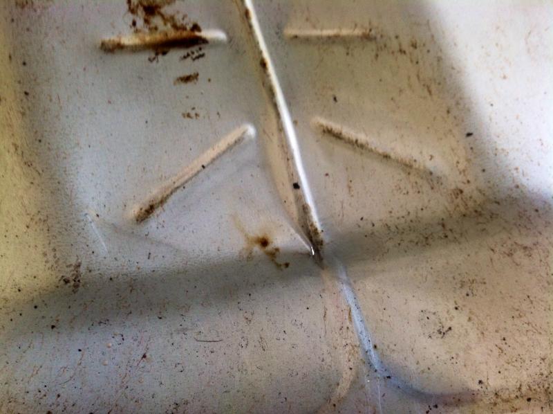

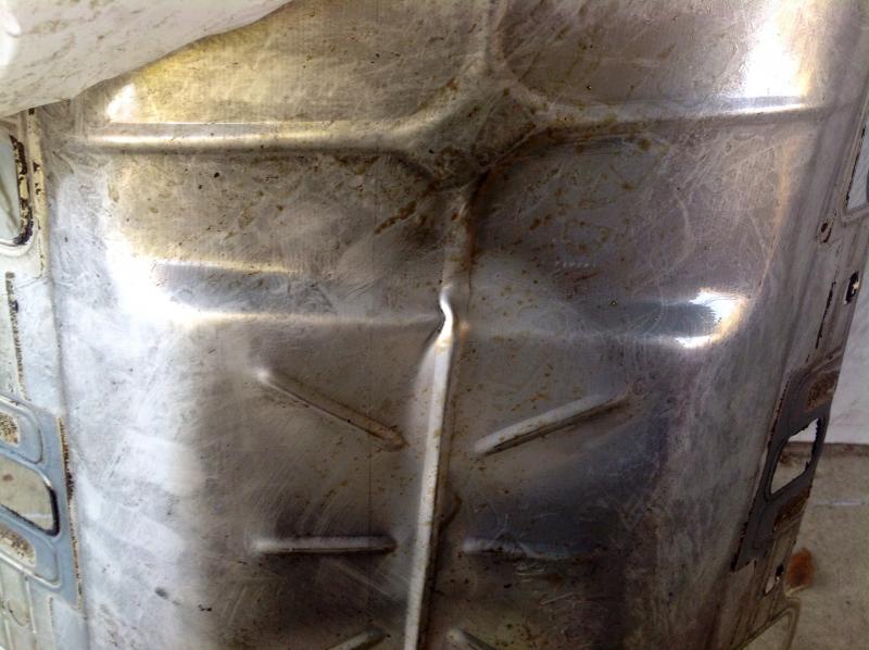

Half way home from Los Angeles, I noticed an odor of oil. Oil in the Valley Pan again. Anyone have a theory on the pictures? A crack or gouge appeared right in the middle of the pan itself. This after about 5000 miles of good service, and right in the middle of about a 400 mile trip. I made an add and drove home. Good oil pressure.

My theory may be a bit challenging to grasp, but here goes: 1st off, when these cars were new, Chrysler stuffed this weird pillow underneath the intake. my speculation is, is that the weird pillow thing was a dampener to keep the valley tray from vibrating from the engine running and from crank case pressure pushing up in it.
my suspicion is that as the valley tray vibrate and crank case pressure mist makes its way past the inside, between the intake flange and heads and condenses on the under side of the intake and pools up in the top side of the tray.
