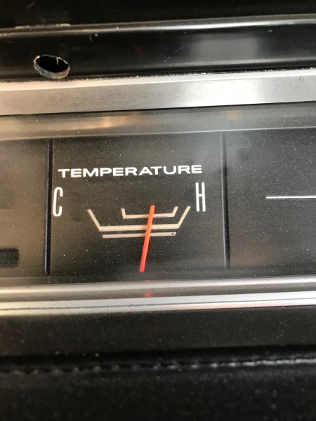

Post # 13, C to H conversion. Do you mean C to Fah? Multiply C by 9/5 & then add 32= degrees Fah.
Agree with Bob, hole in stat does nothing. Holes in stats started because some performance water pumps eliminated the bypass. The fix was hole in the stat. Adding holes will not improve cooling & just delay warm up, needing the choke on longer....
Do you know what the range is from the C to the H in degrees F?
Yes….it varies with every car, sender and gauge. That “could” be running cold (seriously). All those gauges are worth is this…if you drive the car for 3-4 yrs, you will notice if it’s different. That’s it. You should invest in an infrared temperature gun from harbor freight for $25
