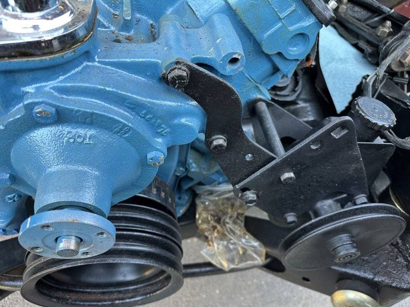

Received my BPE brackets for the Sanden. The front bracket gos over the top bolt on the PS bracket. The hole on the right side of the new bracket looks like you'll lineup fine to bolt it in to the block. This is the part number. MN410701 is for iron pump. Guessing that I could cut out a piece on the bracket and I would guess manufacture would say wrong PS bracket. Suggestions please. Thank you.

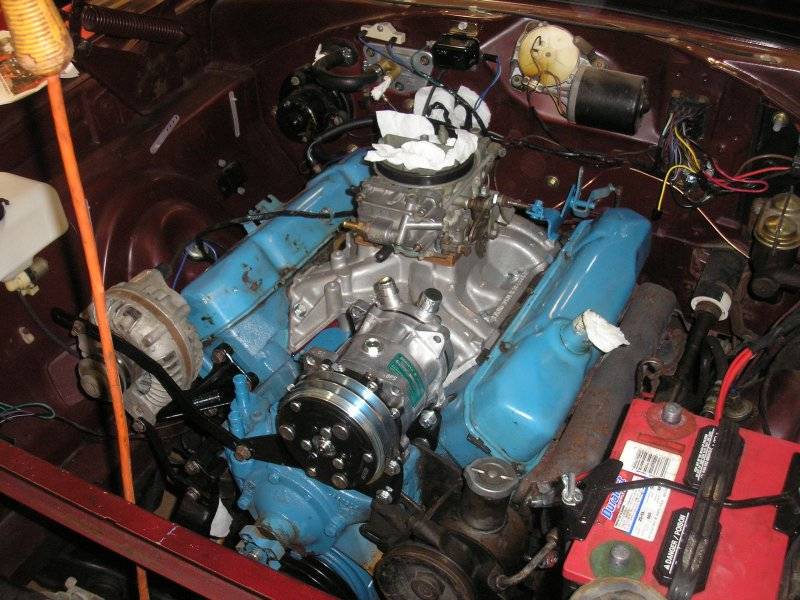

I don't know if this helps, but this is my setup for my 67 383. Best picture I have.
6872n73 I want you to put spacers between the bracket and the bolt I assume to lineup the pulley. I may be able to see if I can put spacers on the block first thank you.​

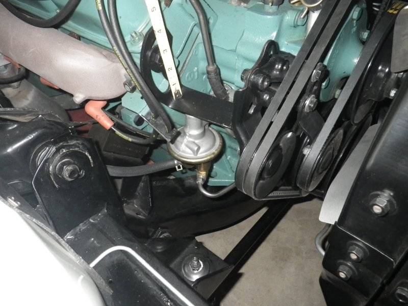

1 Wild R/T at least they made two different brackets one with an iron WP and the other not. they look really similar except for how it notches around, but length looks the same​
Thanks for the photos and didn't realize that there was so many different placements for the PS pump. I may be able to make a notch out of the plate to go around that bolt or try to space it out first on the block to see if it can clear and see how it lines up with the pulleys. thanks so much everyone your advice.

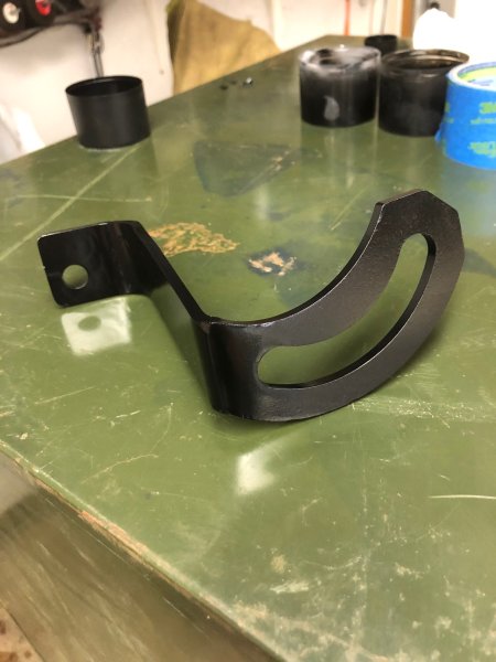

You're correct I'm gonna have to do some type of hole or relief cut out. But I did talk to Randy at BPE and I showed him what I had. His suggestion was that I'll take a holesaw mark it and cut like a half Circle around that area dress it up. And this way I'll go around that top of that bracket and bolt. I cut out a piece of cardboard last night so I can kind of see how far up I would have to go and I think that might work out nice. Was planning on doing it today but it's 32 out and snowing again. So hopefully tomorrow!

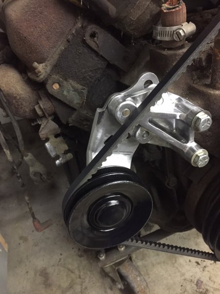

I like challenges like this. I don't have great pictures, but my 65 Cop car was missing most of its Leece Neville alternator brackets. From a picture on the internet and seeing one setup in person, I made most of the brackets. I was able to source one of the idler pulley brackets as it is a common bracket. Made most of the other stuff including the other idler pulley bracket. The last picture is an original setup.
So your modification should be pretty easy compared to this!

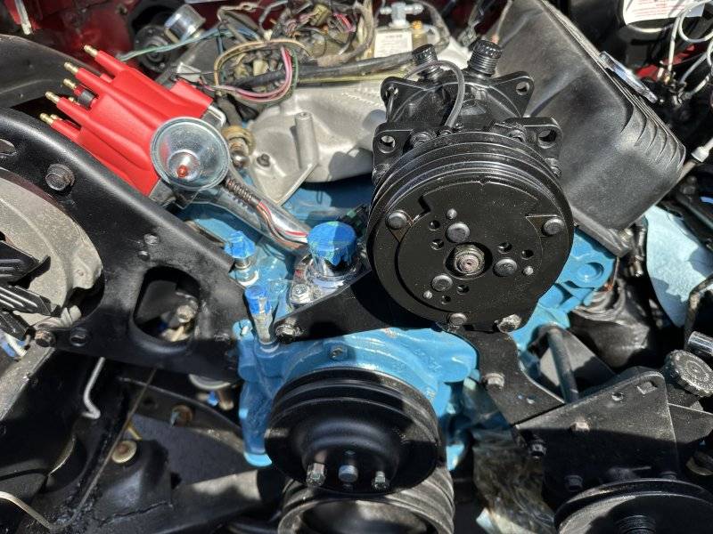

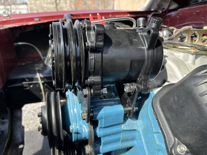

Thank you so much for such great ideas and willingness to help. This is such a great group to have for our vehicles. So a friend of mine came over and we took an 1 1/2 hole saw bit with a drill press and held the bracket down really well and made a nice Semi circle in the bottom, right hand of the bracket. This looks like it might work out well pulling, everything apart and giving everything. A black satin finish. Much closer to getting the front end all set to go. thanks again everyone!!

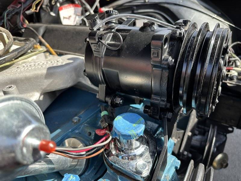

Got the compressor mounted on. Had to move some washers around for I believe a better trueness for the pulleys to lineup. ordered up a couple of new belts as the ones that was for the original compressor is a little too short. 100 amp alternator pretty much lies right against the distributor. We'll see if I'm off alignment wise after the belts on. so far so good!
