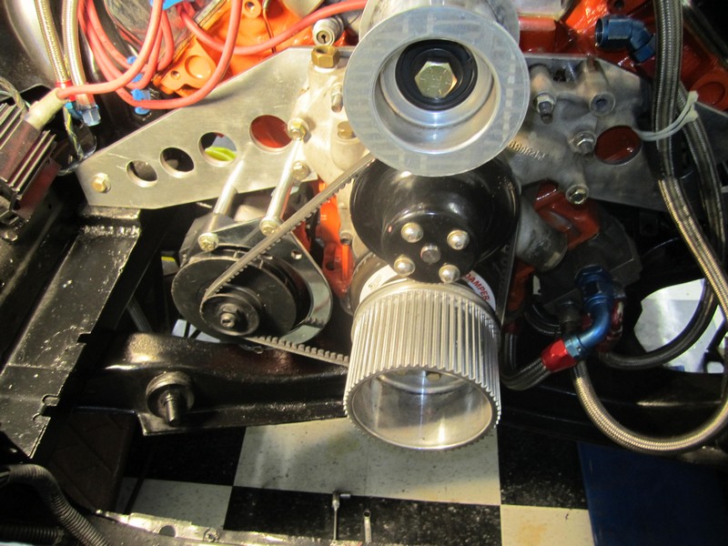

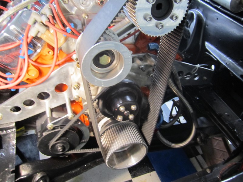

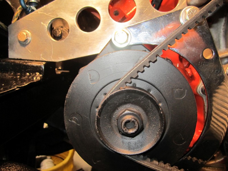

Mounted mine low on the passenger side.Bought the Jegs chrome SBC kit for like $30:blob1:
I have a meizere type water pump on the engine so I have no water pump pulley to go around only the crankshaft.
