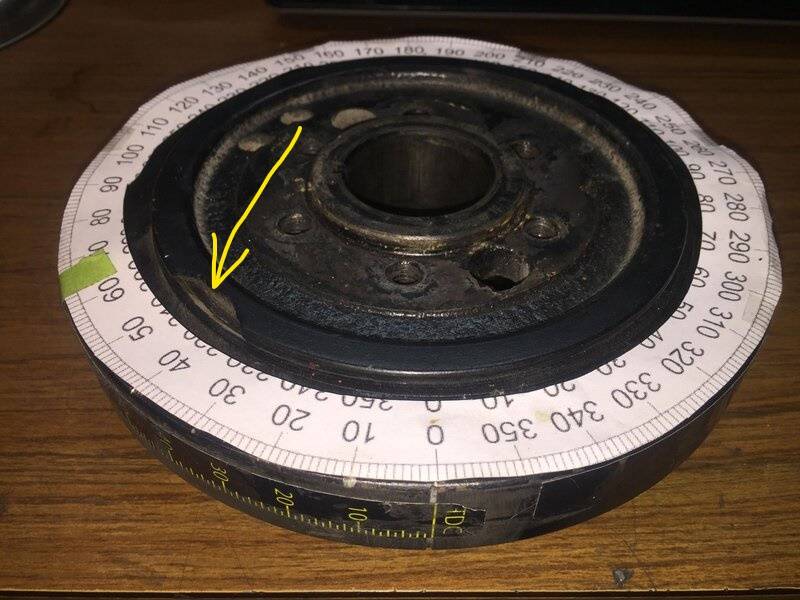

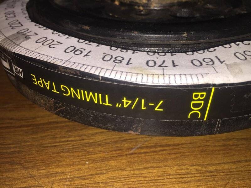

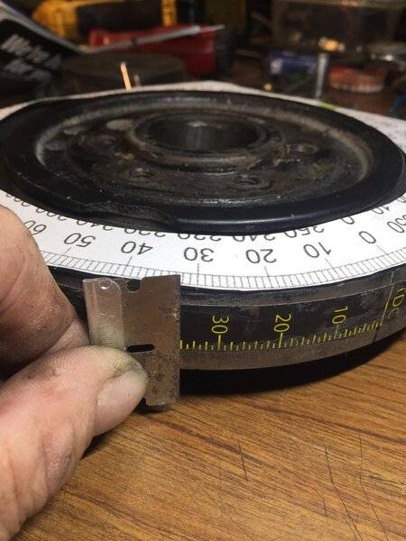

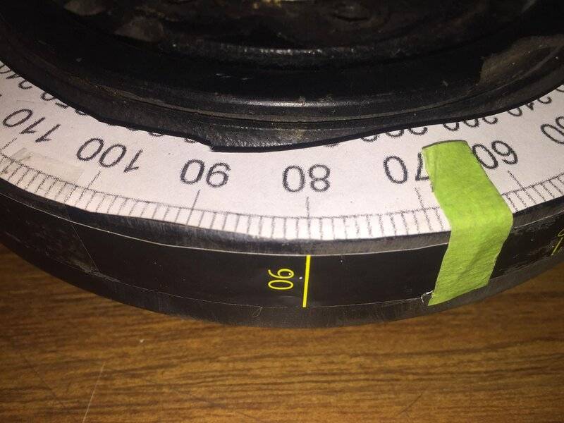

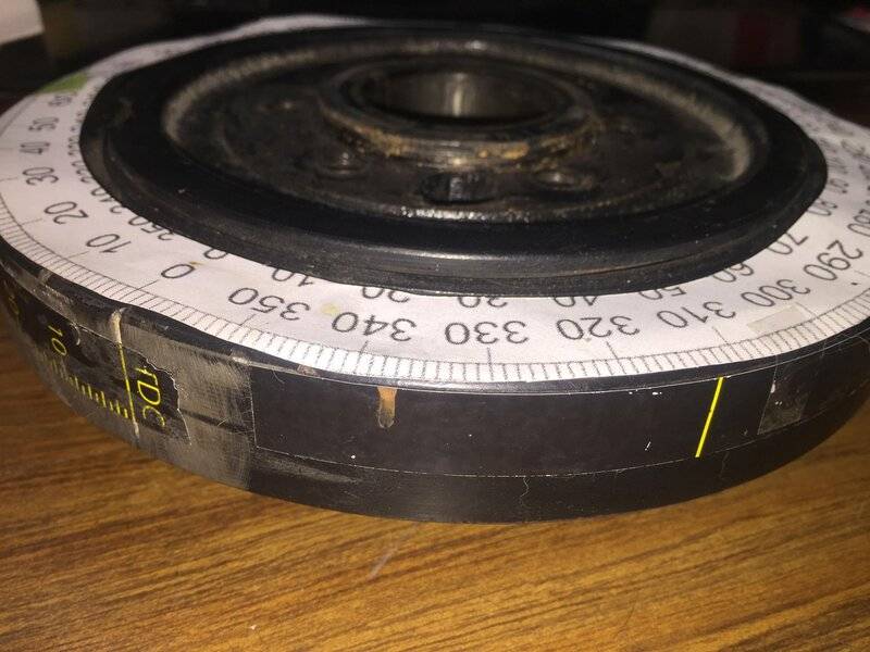

I bought the Mr. Gasket #1593 timing tape for the 383's 7.25" balancer and discovered a huge discrepancy in the marks and length around the circumference!
First thing I noticed was that the 0° and 360° marks did not meet at TDC. 180° did not meet the centerline of the balancer.
So I got online and found a site to "print your own" timing tapes and found that I could also print out a 7.25" 360° protractor to lay on top of the balancer so that I could double check the marks.
@ 90°, the tape is short by 10°.
In the fourth photo, the mark on the right is the 360° mark and should meet at the TDC mark on the left.
Last pic shows that when I set my TOTAL timing at 36° it falls short of that by 4°!!
Please tell me that I haven't lost my mind already!
HUGE Issue!!

That's close enough. I get .003 short of 2 9/32 for 36°.
NOT saying this is what you did, but lots of people stretch those tapes to try to get them on tight, so they dont fall off.
Circumfrence of balancer equals pi x dia. Single degree is that result ÷ 360. Then take that number x whatever degree # you want.
3.14159x7.25=22.7765...etc
22 7765etc÷360 = .063268etc. times 36° =2.277etc, .004 short of 2.281, 2 9/32.

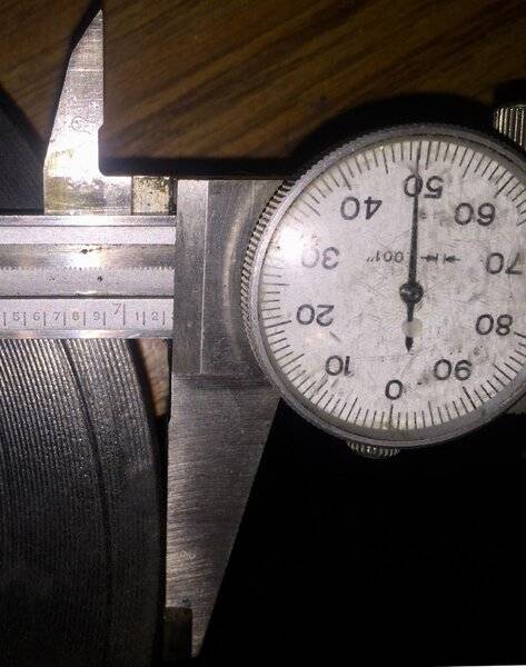

You would think the tape should be 22.765 inches long. Did you measure the circumference of your balancer.
Circumference measures just over 22.75"
As should the tape ....
If you had one that goes around the OD and it was to long make a copy reducing the size. Reduce to say 95% to long try 90% to short 93% etc.

Arc Length = S
Angle = Theta in radians
Radians = (pi * deg)/180
r = radius
S = r * theta
= 3.625" * ((pi * 38 deg) / 180)
= 2.4042"
S = 3.625" * ((pi * 36 deg) / 180)
= 2.2777"

Yes, I used a piston stop and confirmed that line on balancer was, in fact, true TDC
36 degrees is 10% of the total circumference. Hard to do in inches but you could figure it in metric in about 3 seconds.
HUGE Issue!!View attachment 1134668 View attachment 1134669 View attachment 1134670 View attachment 1134671 View attachment 1134672 View attachment 1134673
