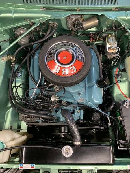

Excellent news.IT'S ALIVE! 2.0
Yesterday was the culmination of time, hard work (for me), and money.
I primed the oil pump holding 55 psi, poured some Sunoco 93 down the carb, cranked only two/three times so fuel got to the carb and - boom - it fired right up!
20 Min 2000 RPM - the temp never went above 180. Good oil pressure, running NOTICABLY smooth compared to 1.0 attempt when I F'ed up the timing. Throttle response is very nice, no stumble.
I bled the brakes today and added PS fluid. The Flowmaster tailpipes aren't behaving well with the H pipe from tti.
The ceramic tti headers held up through the process!
Nothing major to sort out, but I do want to get the hood back on before a road test!
