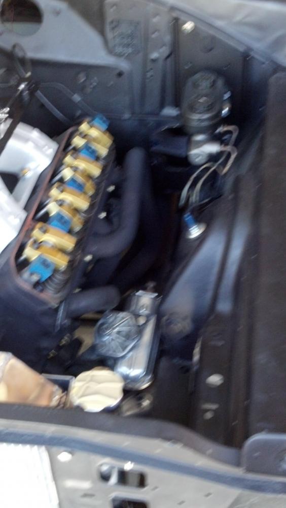

i used the mancini rod on my 67.had to shorten it a bit but it worked fine. 2012-06-06_15-04-09_518.jpg
