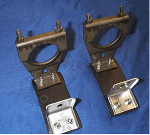

Saw These But Not Sure How They Mount

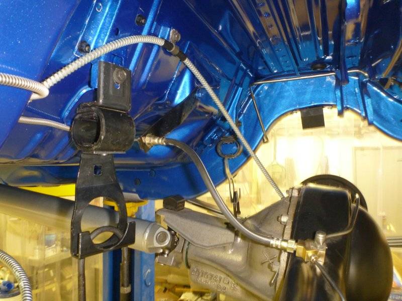

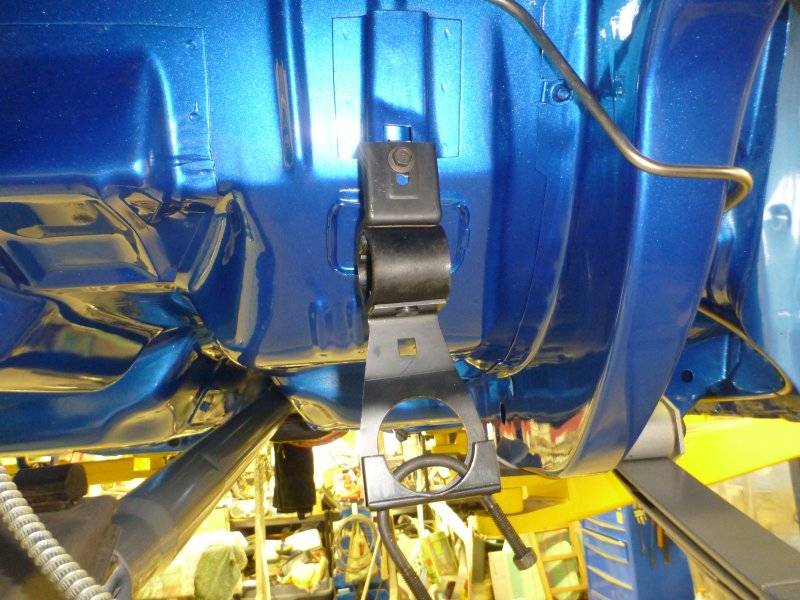

The hangers in the OP's picture are stock OE style hangers, as are the ones I show in my pictures. I got both styles from Frank B and used the closed loop ones as they held the exhaust up tighter. I should add that the hangers in the picture that he showed are not factory correct with bolts in the rubber.

If I could remember how to spell his last name I would have.. LOL. Frank is a concours judge and restoration "expert" and sells parts. He was the only game in town for correct hangers in 2017. You can now buy them from ECS... Mopar - Clamps & Hangars
Thanks Guys. Just Posted A Generic Pic of B Body Hangers
Ordering a Set From ECS

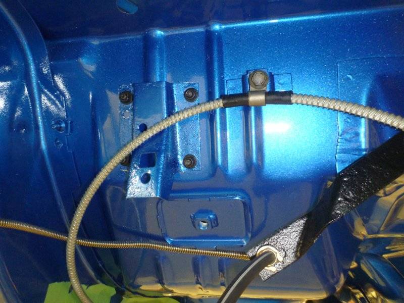

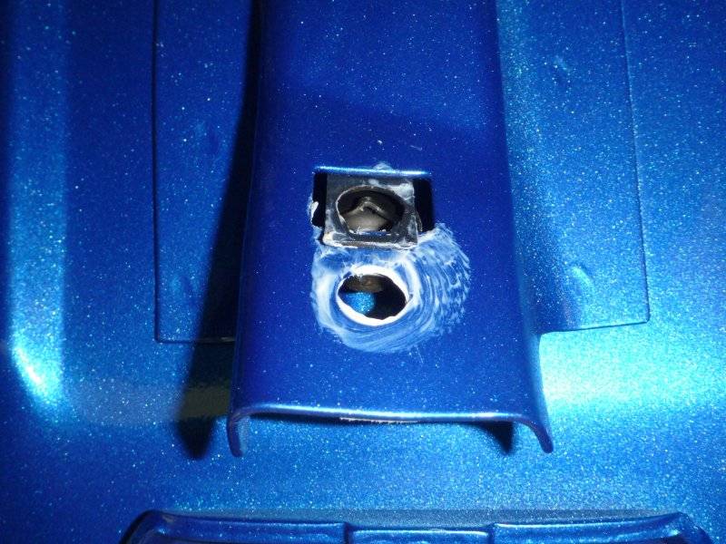

Even the AMD floor pan comes with one welded on the passenger side. The drivers side is an "option" so it's bolted on by View attachment 1399425
That’s interesting - I noted the left side was bolted in on my car instead of welded and wondered if it was original. So right side welded in and left side bolted in. Good to know - thanks.

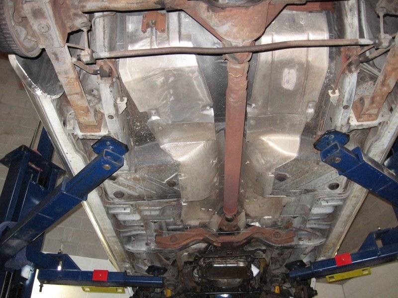

Even tho this is a 79 it did have factory dual exhaust (with 3 cats) you can see in the photo the driver side bracket is bolted in.
The passenger side is completely different most likely using the single exhaust bracket.

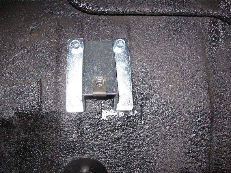

This photo is of a 64 Belvedere that had single exhaust.the passenger side had dimples for the location of a dual exhaust bracket that I bolted in a factory style bracket.
Sorry for the double post.The Black under coat is the 64
