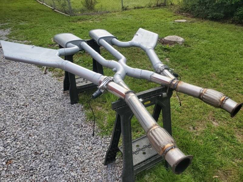

I have a 3" system, Doug's electric cutouts added and 3" 40 series Flowmaster mufflers with a X pipe crossover.
I like running with the cutouts open at Cruisin the Coast and at the drag strip, but I don't think it affects performance, and that's mainly because the exhaust is so efficient.
