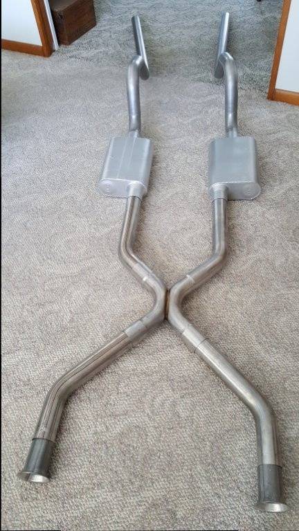

I'm upgrading the 65 Coronet to a dual exhaust system It will be the same system I had on my 64 Belvedere before it burned in a storage fire. Manifolds into a 2.5 inch x-pipe through the muffs into TTI 2.5 tailpipes. On the last one, I had thrush turbos and the drone was so loud the kids didn't even want to get into the car. I'm looking at the Dynomax super turbos as they are supposed to be a lot quieter and less drone. I'm not interested in Flowmasters either. Anyhow, The case length is 19 inches for an overall length of about 25 inches. Will these fit under the car? The Thrushes were 5 inches shorter overall. What do you guys use?

I bought a cheap set of mufflers from Jegs. They are just baffled with no insulation so I don't know how they are going to sound. The X pipe should eliminate any drone with most mufflers.

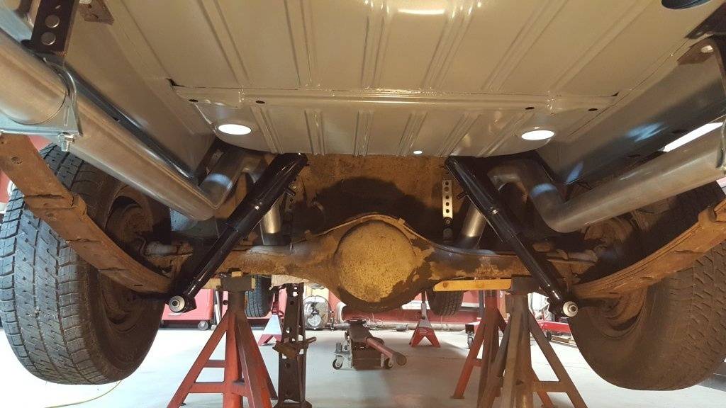

I already have the pipes. Only thing changing is the mufflers as the 30 buck thrush turbos were resonating like crazy. I use band clamps at the back of the mufflers and turbo flange style V bands in front of muffs. at the front of the x pipe I use header style ball flanges. This setup allows me to easily drop the x pipe out if I need to do trans work. 2 clamps and 6 bolts and it's off. the thrushes were 14 inch cases I think and the dynomax are 19ish...
