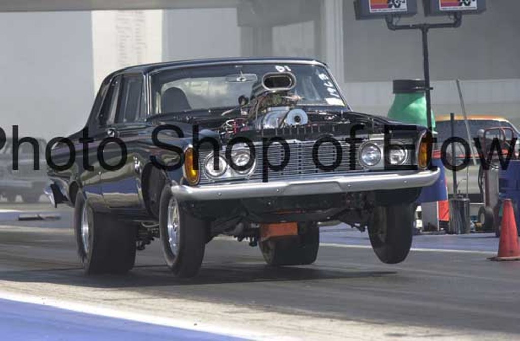

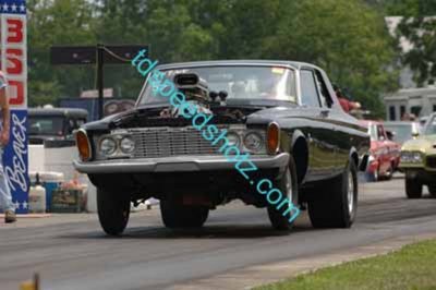

When I threw the alternator belt off one time at the finish line,had to turn off the ignition cause the water temp went up FAST!!Well my *** was off the seat steppin' on the brakes and almost did not stop in time at E/TOWN in NJ.That was about 129 MPH with 10x2 drums up front.So,depending what your trap speed is,might be time for some front disco brakes.SSBC supplied a real nice street/strip for my 3800 lb brick.
