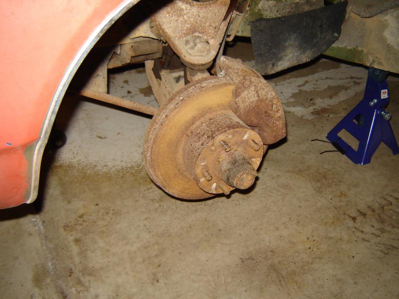

I swiped the wheels and tires off of my 71 Charger parts car (and my friends wonder why I need more than one B-body around). The LT rear drum was seized, but some PB blaster and a BFH got it free. The lug nuts on the RT rear were seized up, so out came the torch to loosen them up, had to knock both RT side wheels off with the previously mentioned BFH.
You do know the drivers side lug nuts loosen the other way right? Not trying to be a jerk. I did the same thing when I was a kid. I don't know how old you are and if you have had a car that old. Looks like a great project. Enjoy!
Yes..... this is my 7th old Mopar. The RT side of the vehicle is also the passenger side :icon_lol:

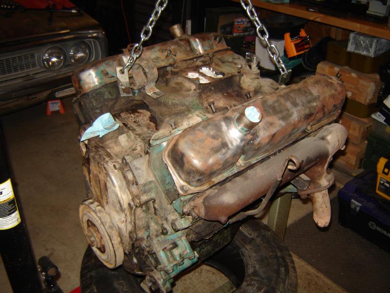

Here is the engine that will be going in the car for right now. It is a 66 383, the original short block was gone, and what was left was burnt by a carb fire and rusted up solid.... so into the scrap bin it went. I've been scraping years of grime of the outside trying to get it clean enough to open it up. I'm going to change all the gaskets for good measure, as well as the timing chain and oil pump. I've also got to swap oil pans since this engine came out of a C-body.

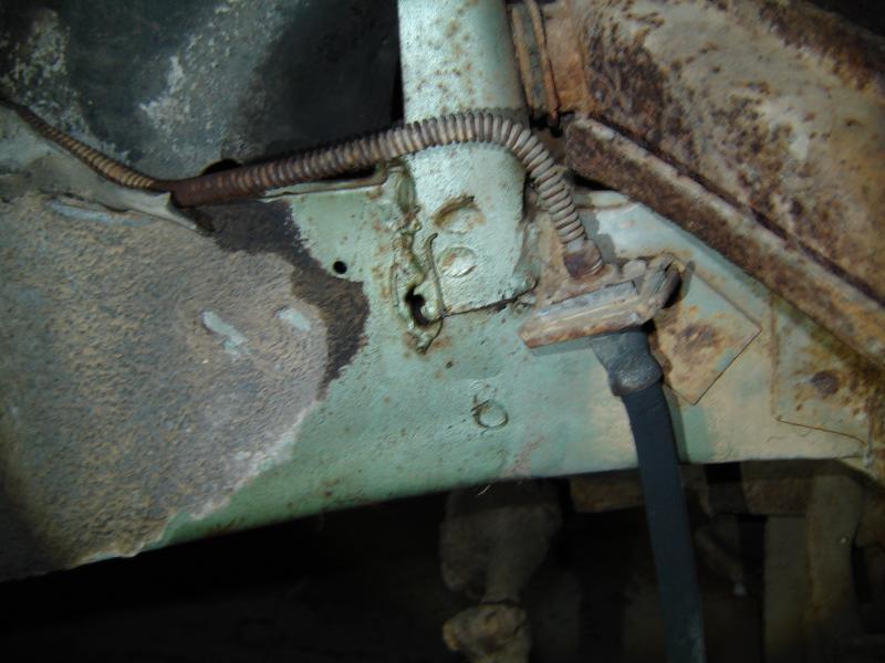

And it just wouldn't be a classic Mopar project without a little of the factory "build quality". That is not a shadow behind the shock tower... that is a weld burn through on the RT front frame rail, must a been a new guy welding that day.

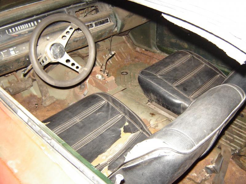

And lastly the interior. When I bought the car the front seats were missing, a fellow FBBO member kindly offered his front seats at a very fair price. I have the original steering that will go back on to replace the parts store "sport" wheel that is on the car right now. I also was to covert to the car to a Rallye dash, but I know finding a rallye, a/c, 3 speaker dash frame will be tough.

Or you could look for a 150 rectangular speedo and leave it as is. R/T's didn't have rallye dash standard. I've had 2 R/Ts with the optional Rallye dahs and the present one w/o.
I have considered doing that, but in the end I really want the rallye dash. My current dash is in rough shape due to some wretched little turd shooting out the side glass while the car sat. After getting the car home and doing some sluething..... I believe the car was parked do to an underhood fire. The engine harness is cooked and it makes me suspect all the wiring in the car. I know I have to pace myself with some purchases (ex my Hemi) my goal is to minimize purchasing things twice. Since my wiring is cooked I might as well do the swap.
I don't recall who but someone has done this and there's a fairly recent thread. Try doing some searches

I've seen a few welds like that before lol. Nice find!

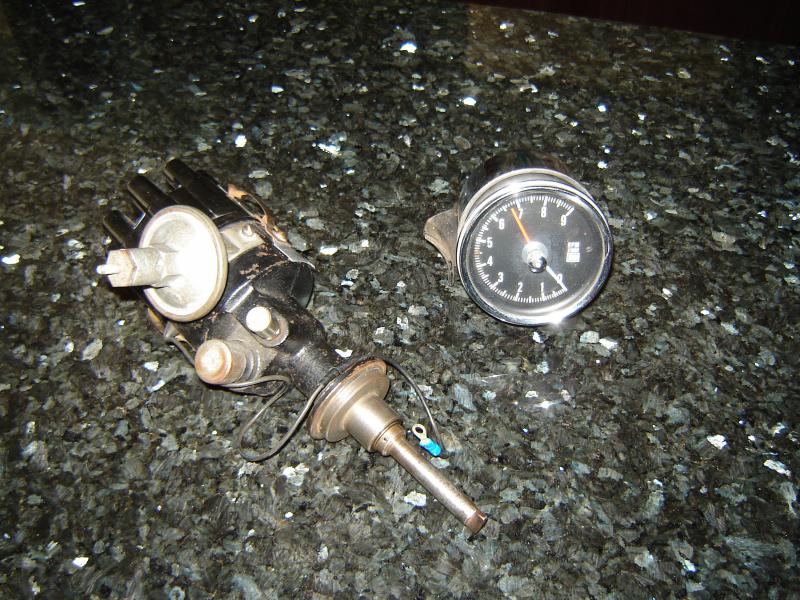

Problem solved by my first vintage speed part. A Stewart Warner 9,000 rpm mechanical tach, and a factory Prestolite tach drive distributor to power it :headbang:
