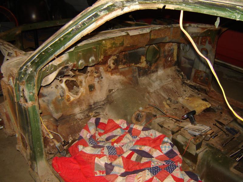

Its been way too long since I last updated,
I've been working on getting my parts car stripped and out of my garage. I got to the doors and that is when things kinda hit a snag. Whoever designed the '71 and up door glass should be drawn and quartered... the lifting tracks were rusted fast to the glass and impossible to remove... after spending a couple days cursing, sweating and cutting myself and got so mad at this rusted POS that I didn't go back in my gargage for a couple of months....
Finally my Dad got me back on track by continuing to send me pics of the new parts he has been buying for his '70 Challenger :icon_mrgreen:
Took a different approach... pulled out my air chisel and removed the glass from the outside of the door.... plenty of room without the door skins in the way.
Pulled out the dash... the A/C box, column support, etc.... car is nearly picked clean.
I've got the K-member bolts soaking... the driveline is next. And the cutting begins.

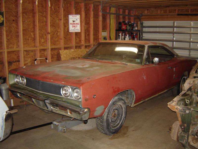

At least I cleaned off the Coronet :icon_thumright:
