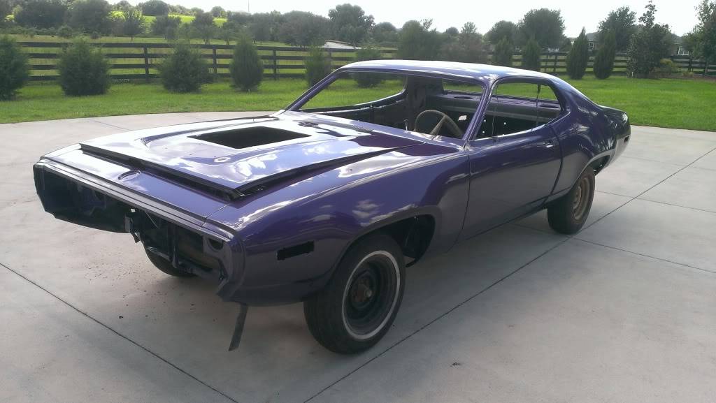

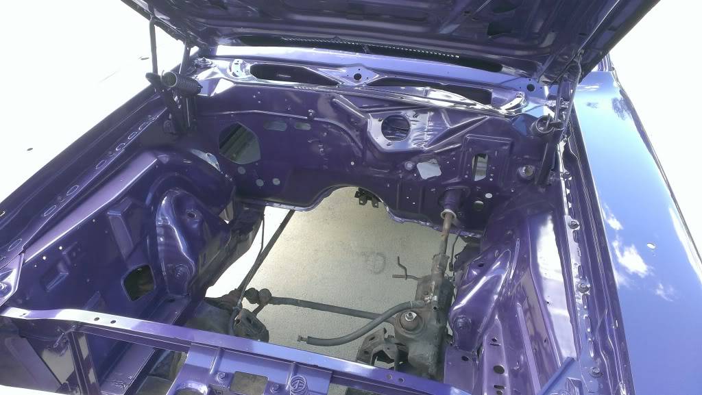

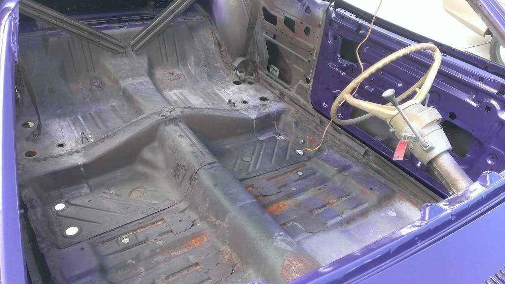

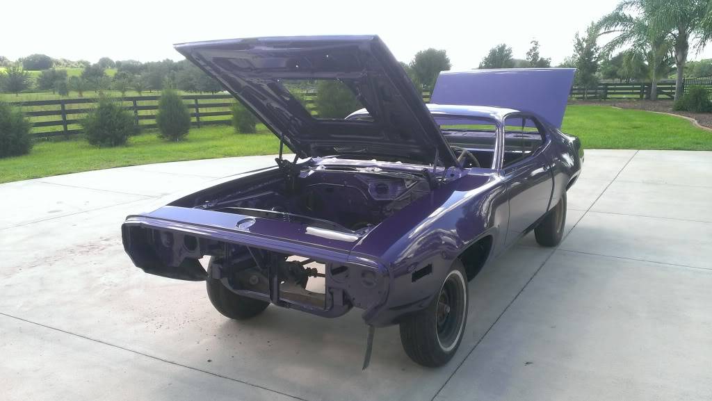

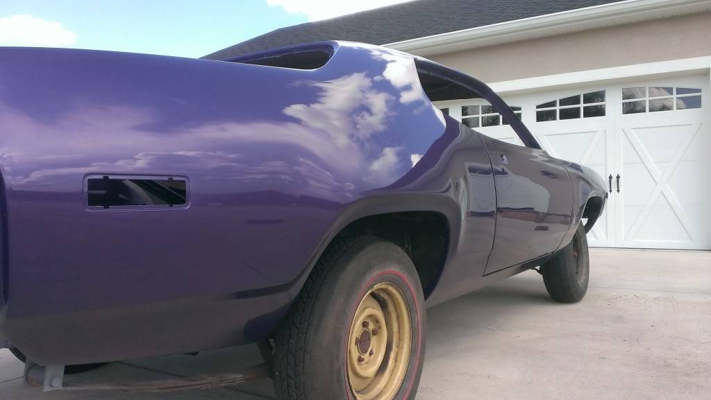

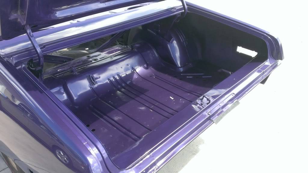

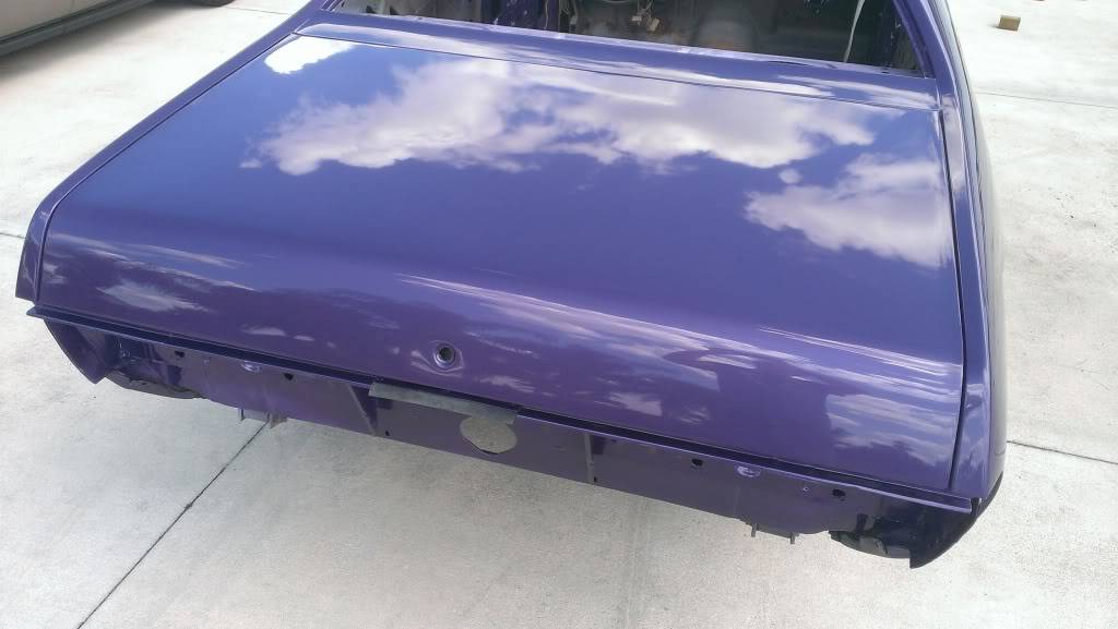

Well, here she sits after paint and body. Does anyone have a suggestion or two about flooring options? Paint, undercoat, Lizard Skin...? (Inside pics below)
Looks great....white interior would look bad ***!!!
Awesome car ! What you do on the floor depends on what your desired outcome is... originality, sound, corrosion prevention, etc... And, inside or underside, or both ?
Man, Thats a great looking car! Im not sure what your really looking for but im using this stuff on another car, its supposed to be real good..
http://www.eastwood.com/eastwood-rubberized-rust-encapsulator-undercoating-black.html

I would put the lizard skin on there, and the matting to keep it as quiet as possible. You'll be glad you did.
I used a spray on bed liner (Xtreme liner) and then insulated (B Logic) it all but have seen many good options that I would consider.

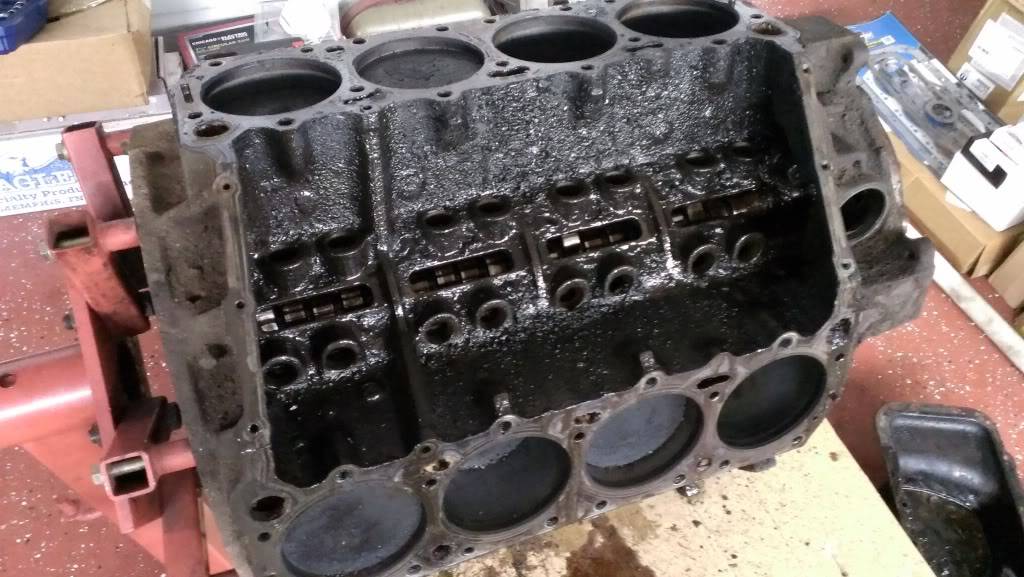

So far I'm refreshing the original 383 and putting it back into the car, but I also have a date '71 coded 440 4bbl from a Charger R/T that I would like to build up eventually and drop in, maybe put in a hotter cam, 6bbl setup...still not sure. But for now, here's some recent pics of the 383 teardown and a few new parts worth mentioning:

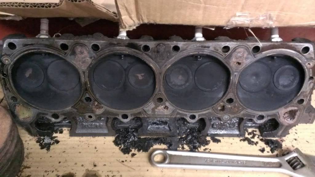

Mmmmm 30 year old sludge.
Cyl Head Before:

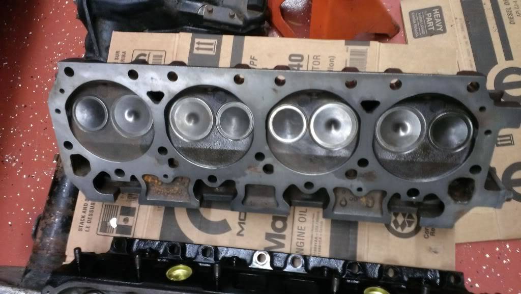

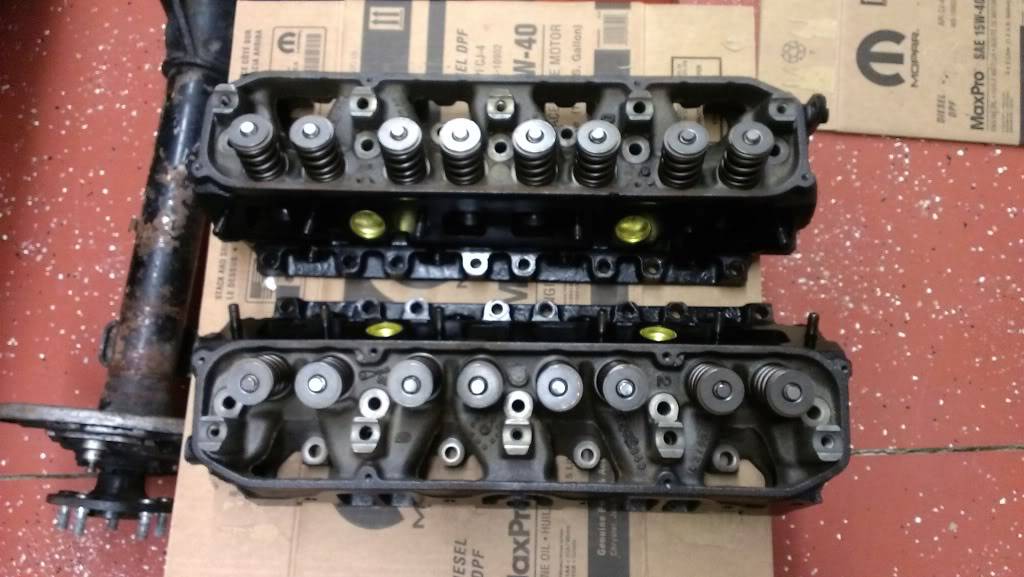

Fresh from the Machine Shop:

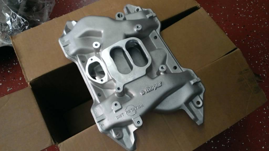

New Aluminum Dual Plane Intake from Mopar Performance:

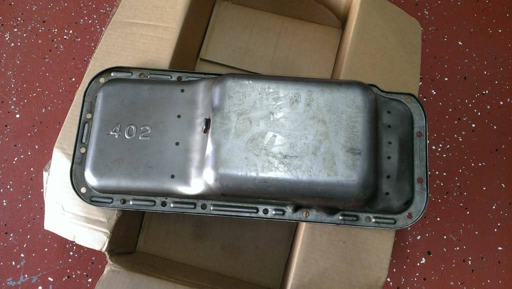

Mopar Performance reproduction oil pan: (Previous one used as skid plate)

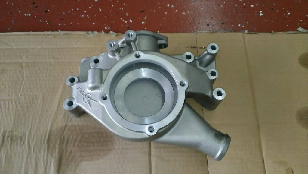

440 Source aluminum water pump housing:
Here's a nice kit from Mopar that includes all bolts, gaskets and plugs for water pump & housing:

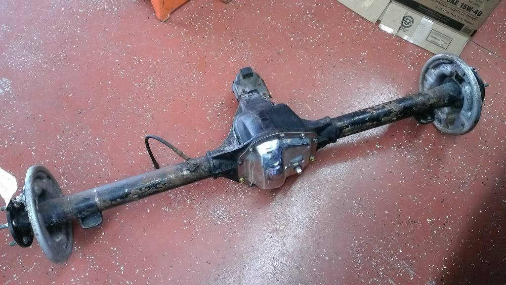

Dana 60 pulled from another '71 RR:
This one has a steep 4.56 ring gear, it's getting swapped for a more highway friendly 3.54

This is John Herlitz Iconic design. Do the roof to if the headliner is out. Keeep it quiet. I used hardware store knock off. Use what you want. That's gonna be a bitchin Mopar. I'd put black inside, who wants to keep white clean?
I did pull out the headliner and insulation also, there is some surface rust to deal with but nothing major. On another note I had decided to go with black interior from the beginning; I ended up getting it all from Legendary Auto interiors, really good quality stuff and priced decently if you buy it all at once for a bulk discount. I can't wait until I get to install it...!
