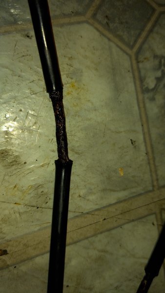

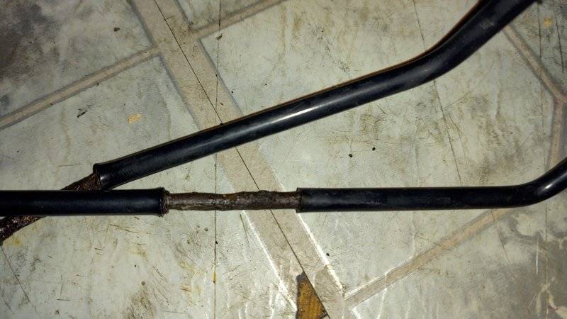

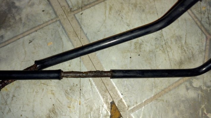

I know everyone likes pictures, so here's a few last ones - sort of a "before and after":
More hard line rot (notice how they've all been in those protected/sleeved areas?); this one is the line
from the ABS controller to the junction for the rear brakes.
Still more rotten hard line - and again, in and under that protective sleeve stuff.

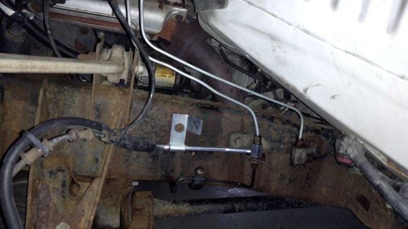

The view from the left front wheelwell now. New caliper hose/metal line, new fabricated
line from that up to the rear port of the master cylinder and the newly replaced rear brake
feed from the ABS box above.
All snug, no leaks evident, all bled. Knock wood.
I've left it all open like this overnight for one last look-over in the morning, then I'll replace
the wheelwell liner and go for a white-knuckle test drive.
