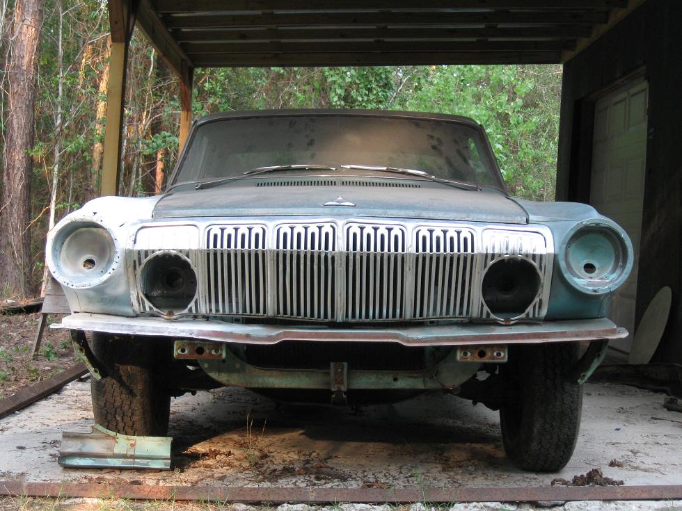

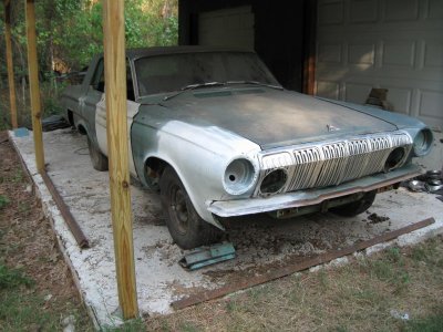

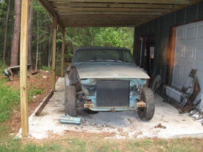

my 63 2 door conversion alterd
I have a 64 dodge 440 4 door that is really solid and a 64 dodge 440 that is pretty ruff. I planned on using the 4 door car to build the 2 door, but some people have said I would be better off converting the 4 door car to a 2 door with the 2 door car being the parts car. Which do you think would be easier? I can either cut out the floor, trunk and cowl out of the 4 door. or cut out the doors, and 1/4's out of the 2 door. Nice looking 67 cougar you have there by the way.

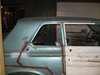

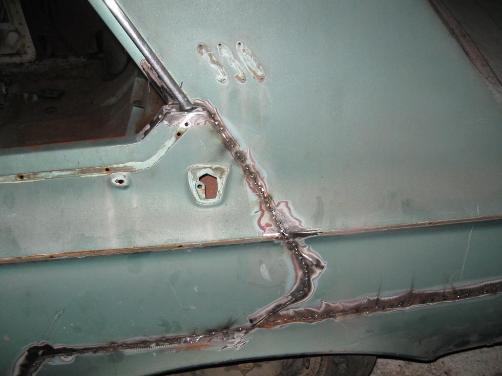

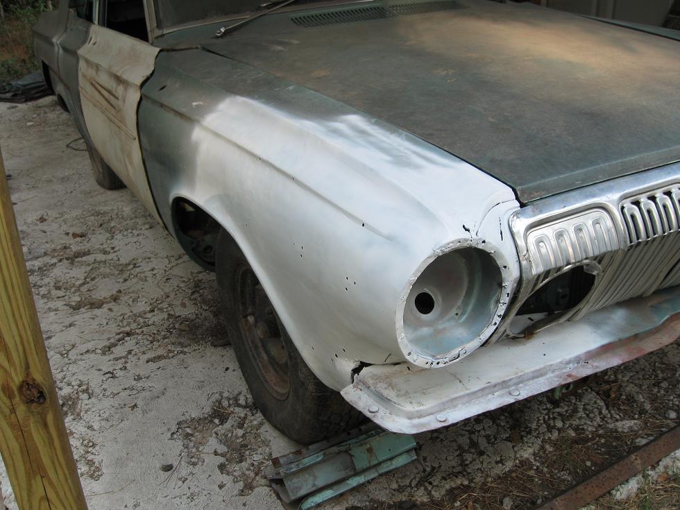

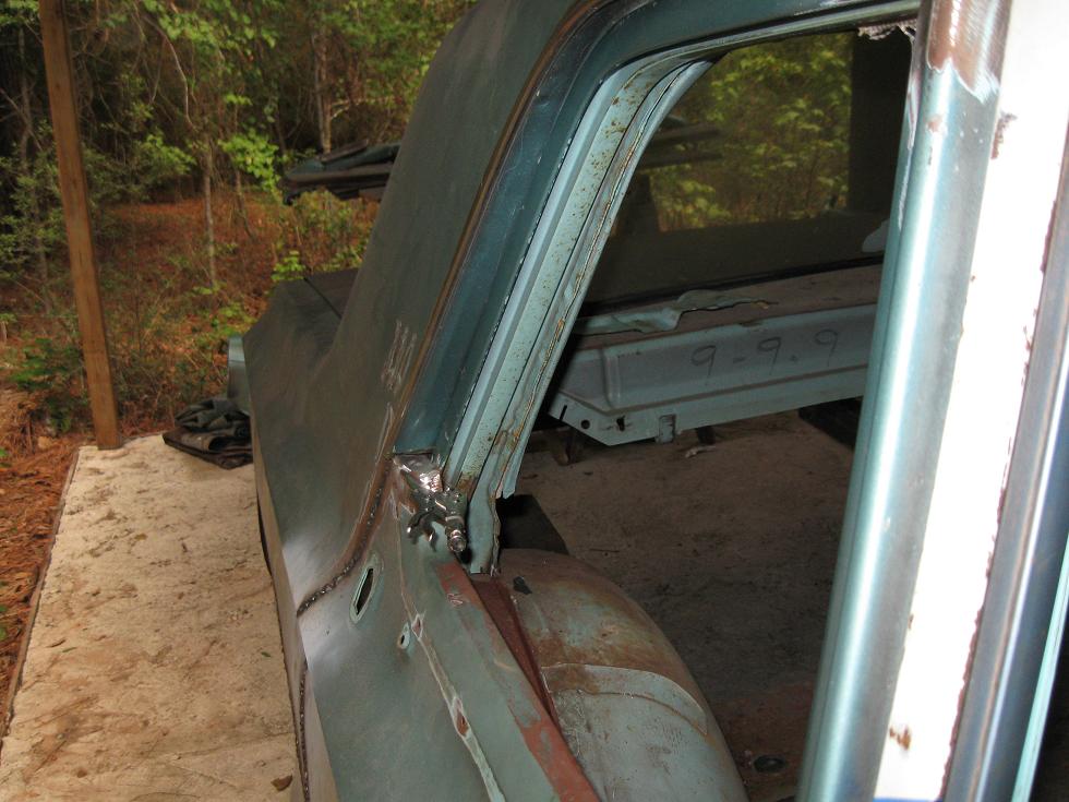

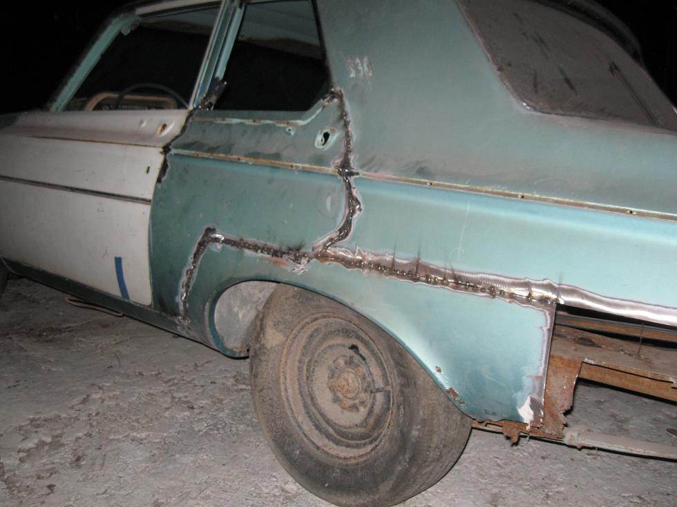

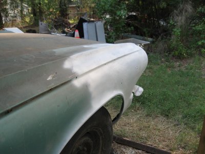

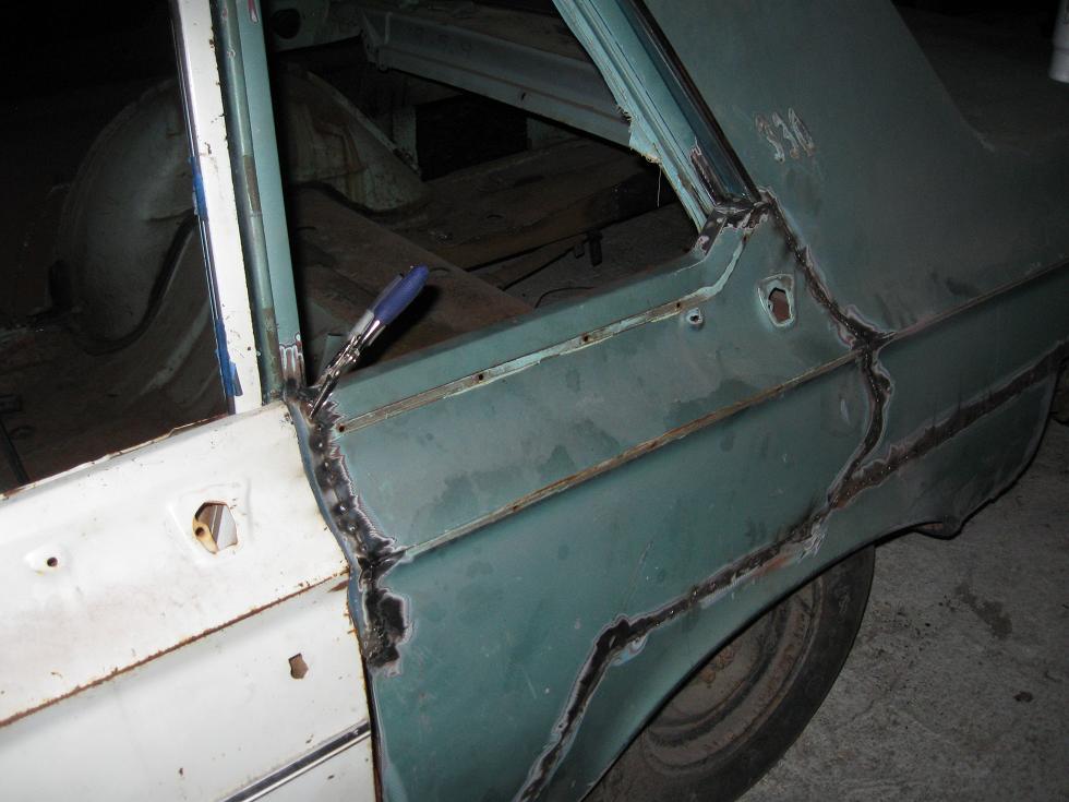

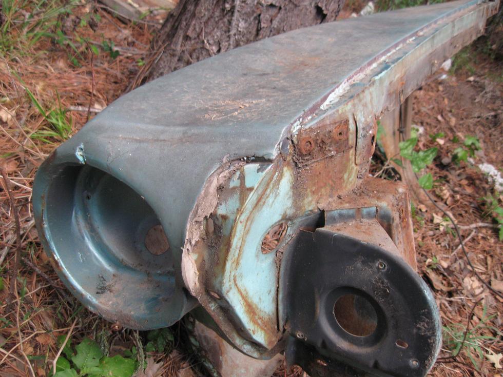

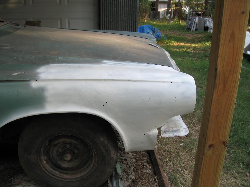

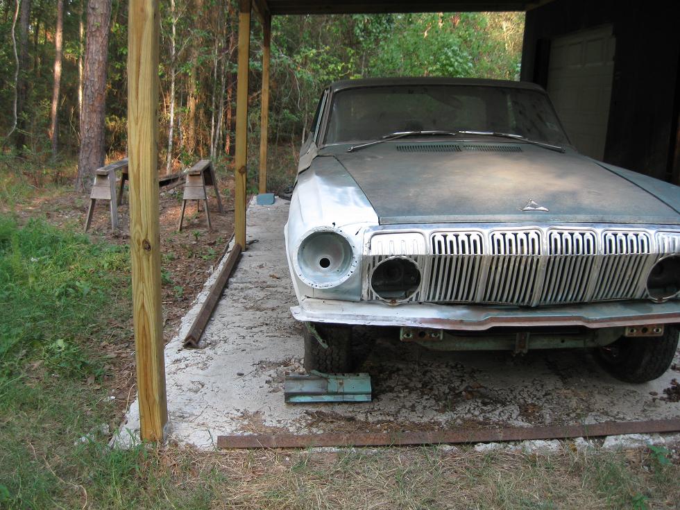

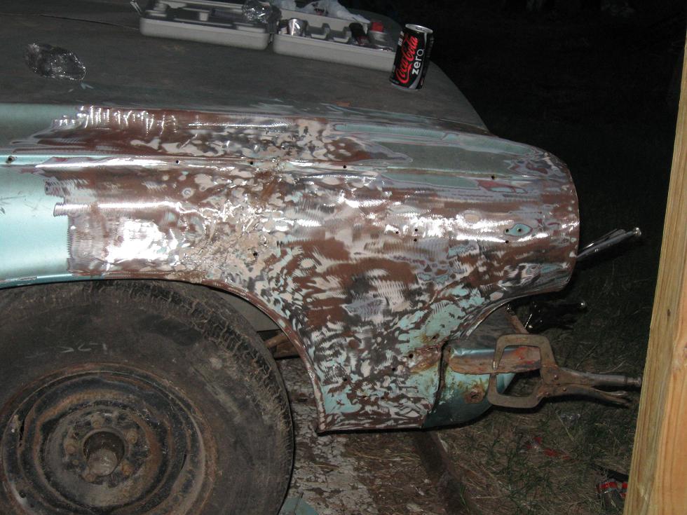

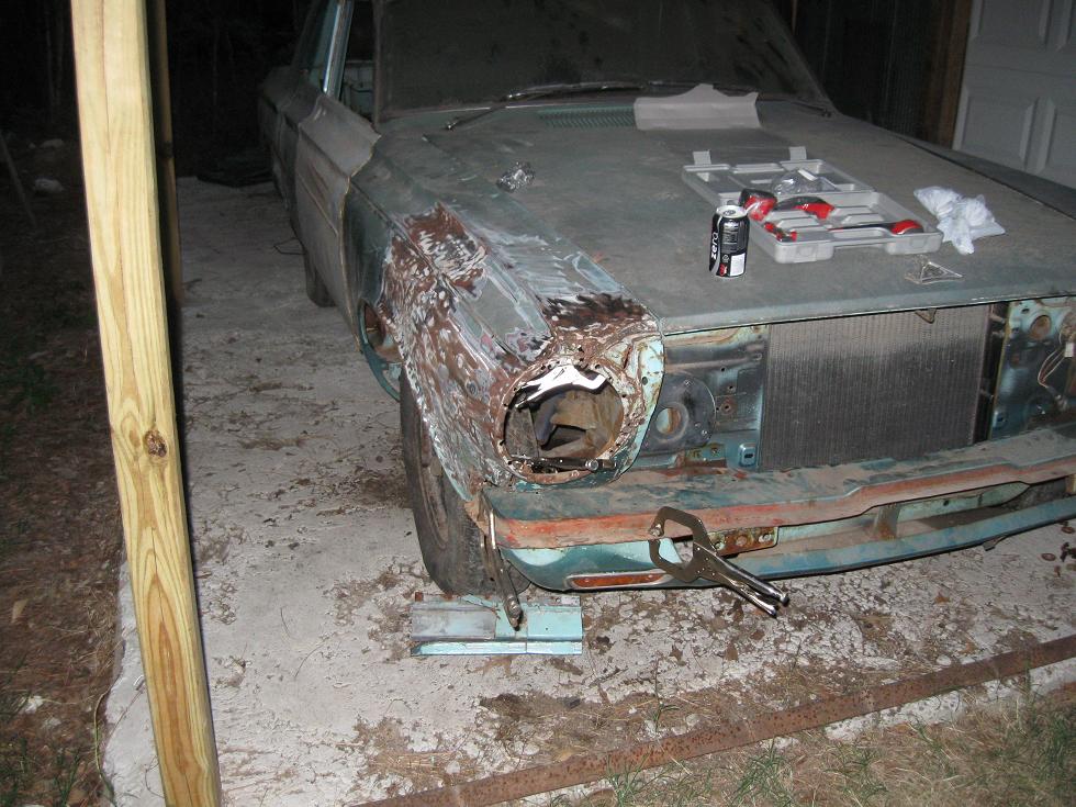

update

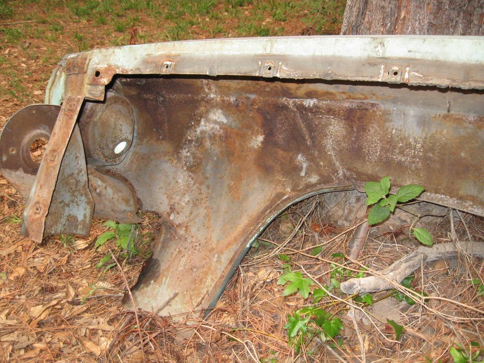

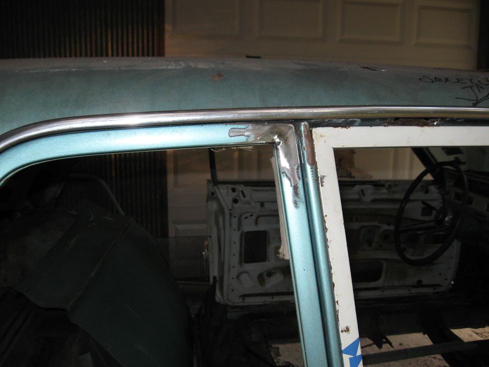

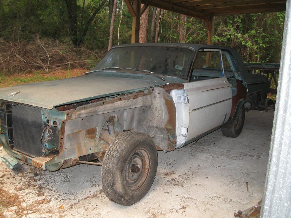

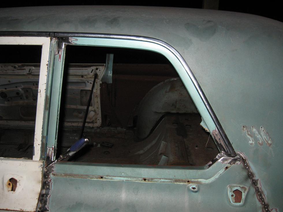

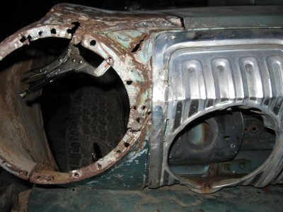

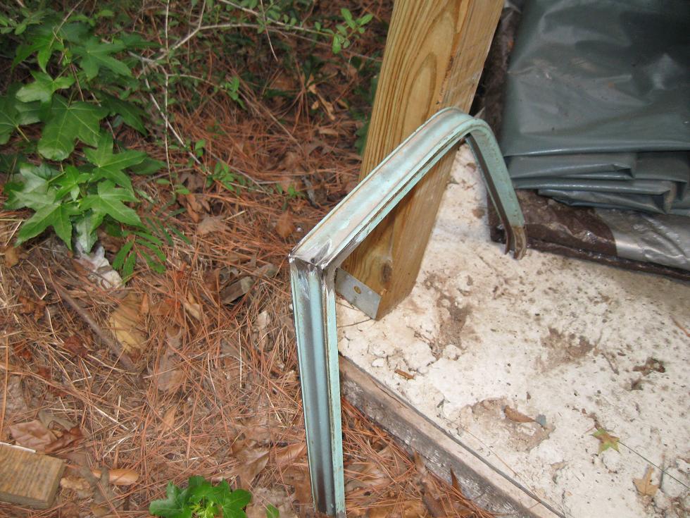

got the quarter window frame done and check out this fender lots of filler
Picture 033.jpg Picture 034.jpg Picture 035.jpg Picture 036.jpg Picture 037.jpg Picture 038.jpg Picture 039.jpg Picture 040.jpg Picture 041.jpg Picture 042.jpg
Wow
Makes me hope that someone buys my 65 parts car whole & does this nice a job. Craftsman ? You are an artist. We are all enjoying pix of your progress.:headbang:

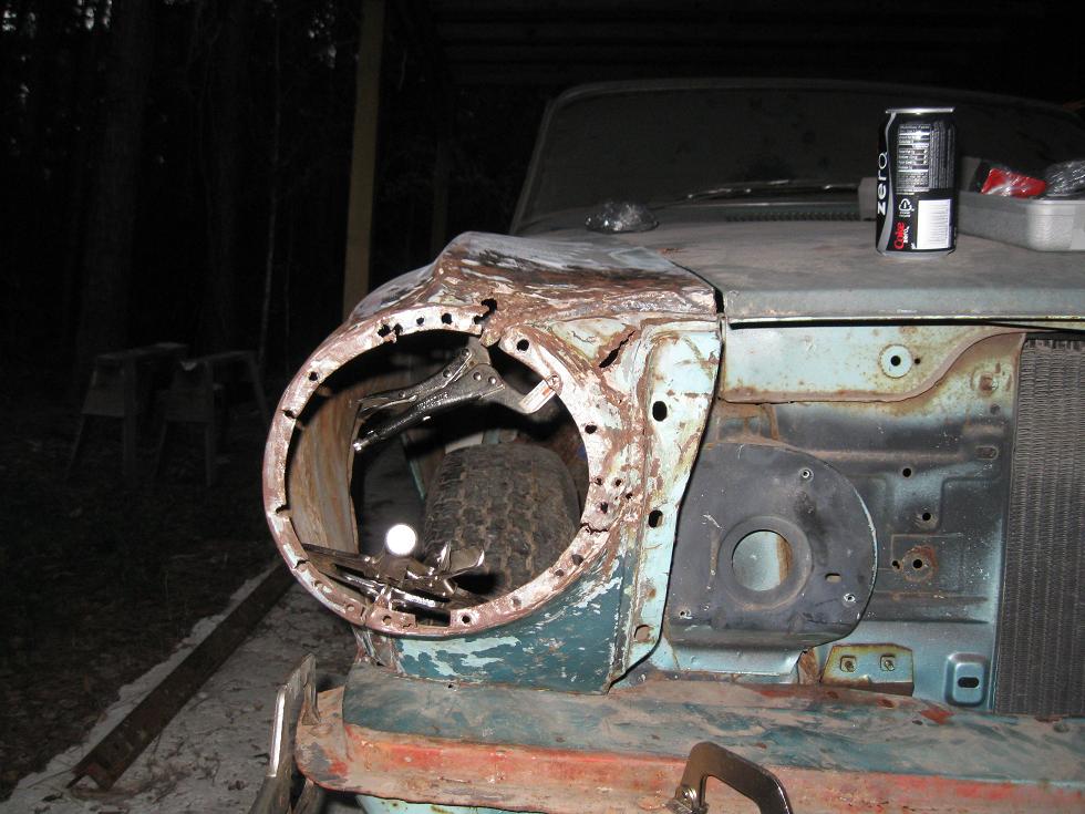

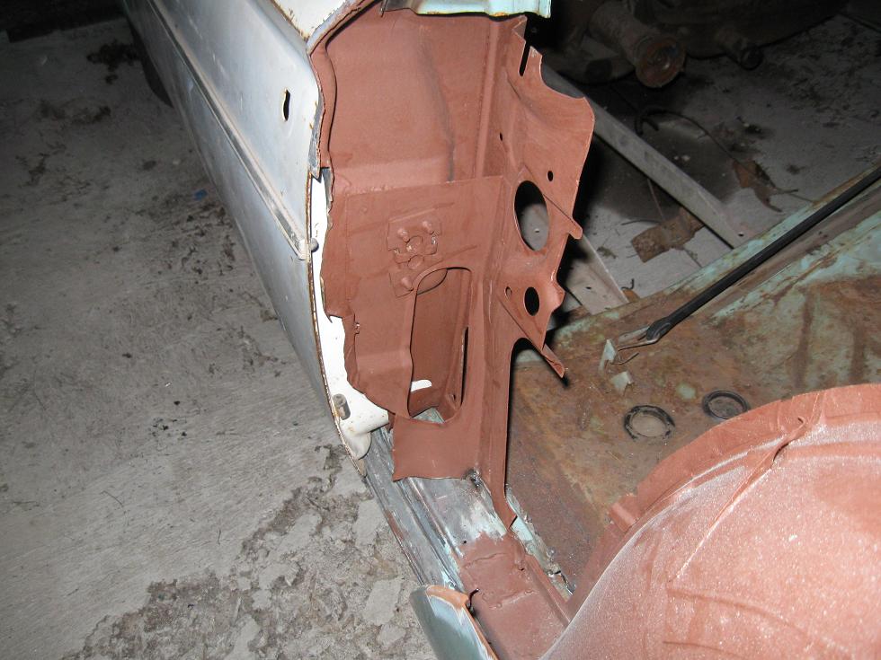

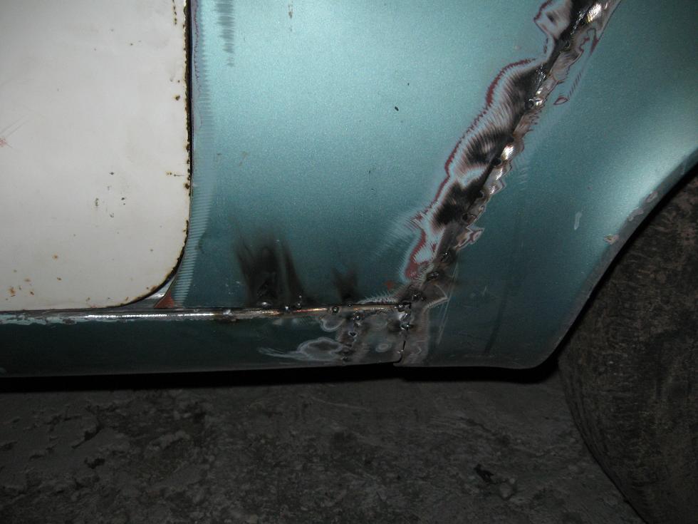

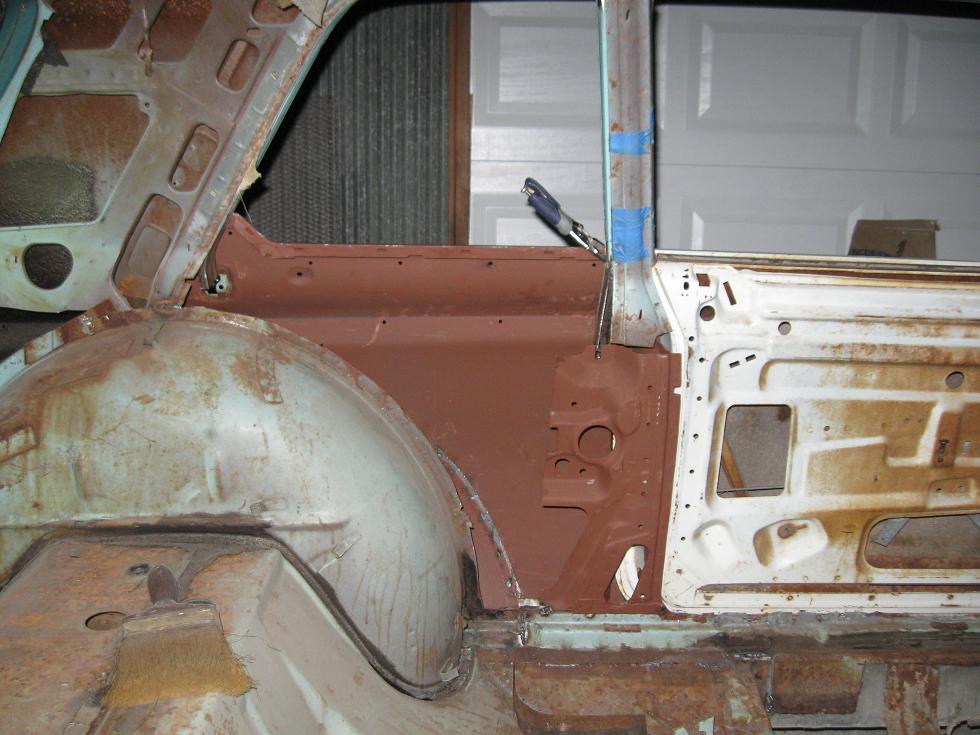

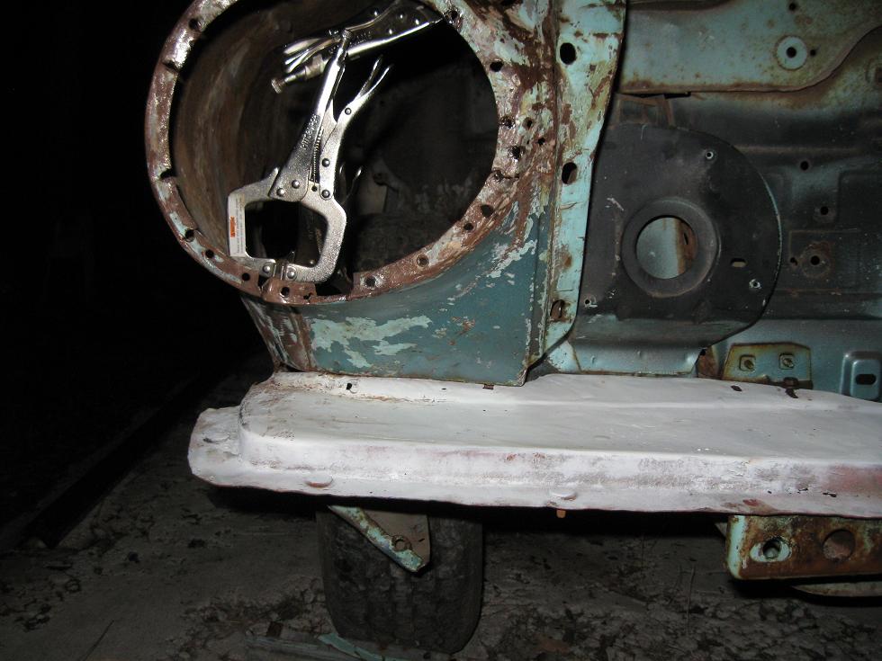

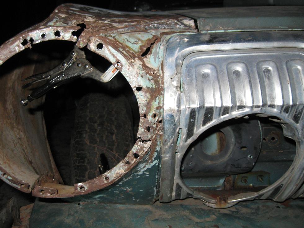

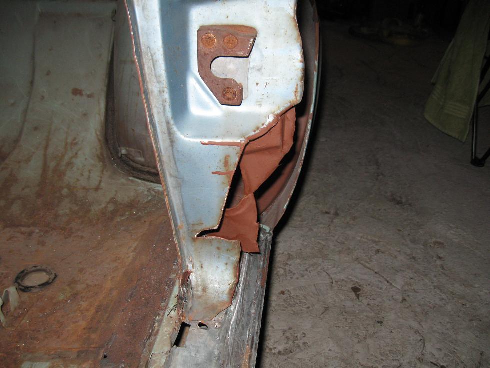

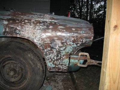

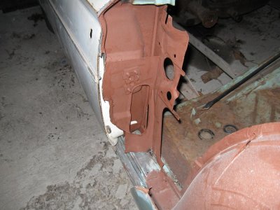

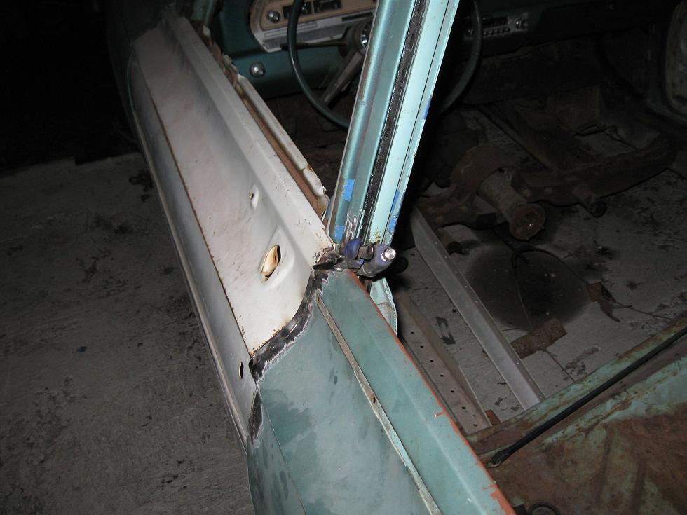

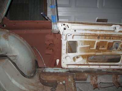

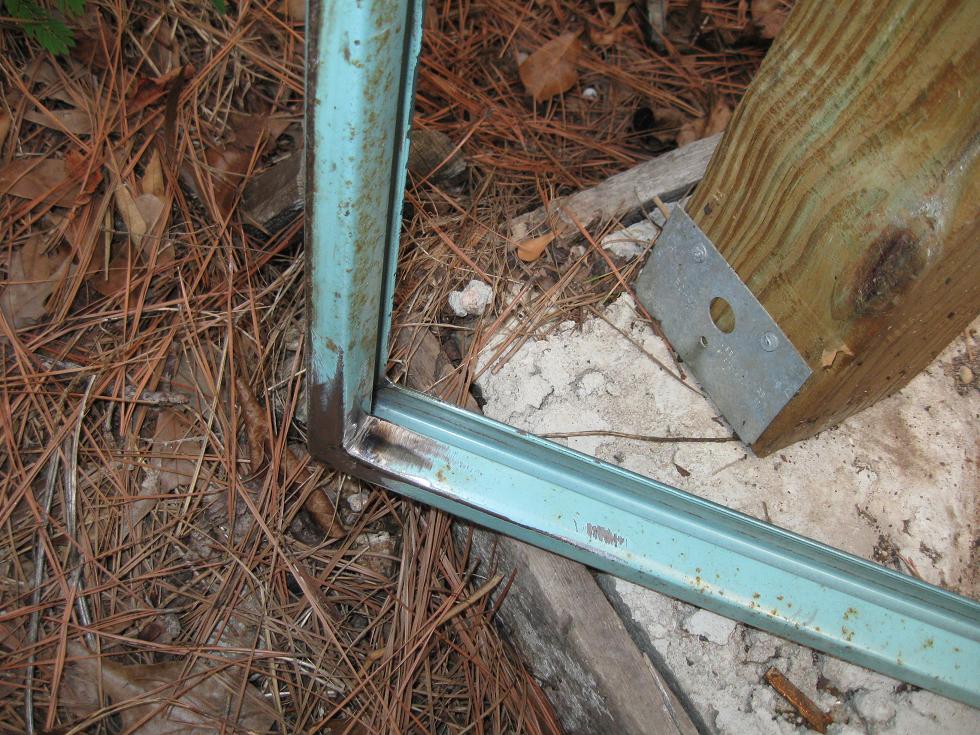

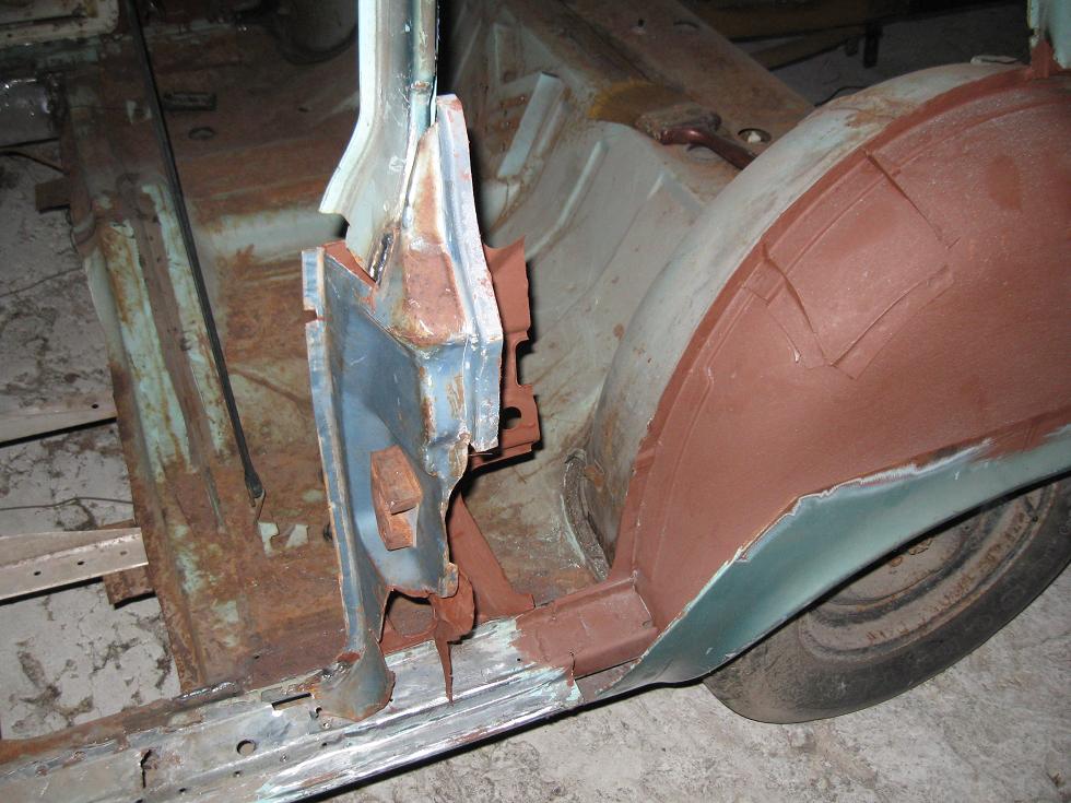

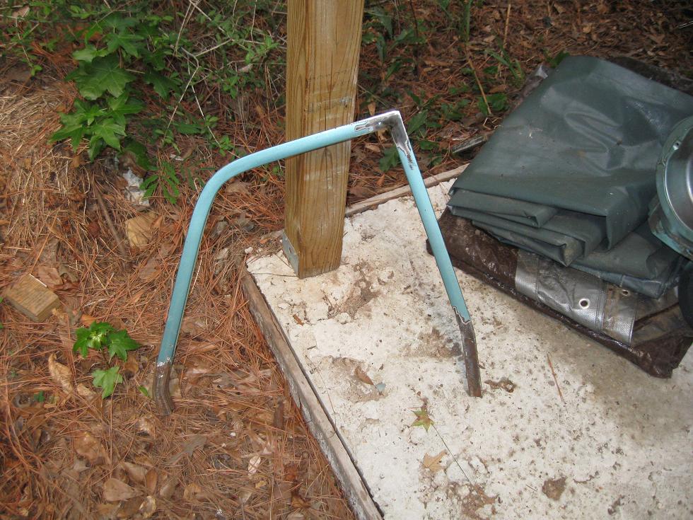

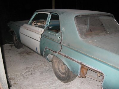

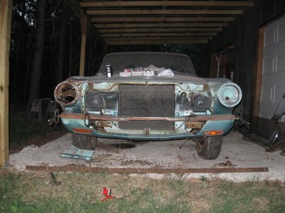

update

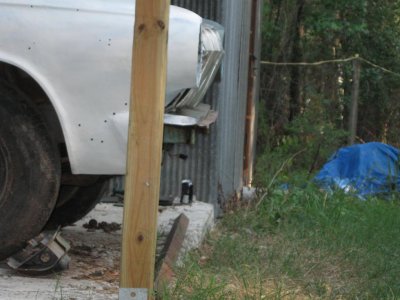

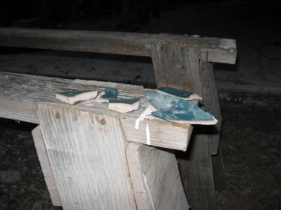

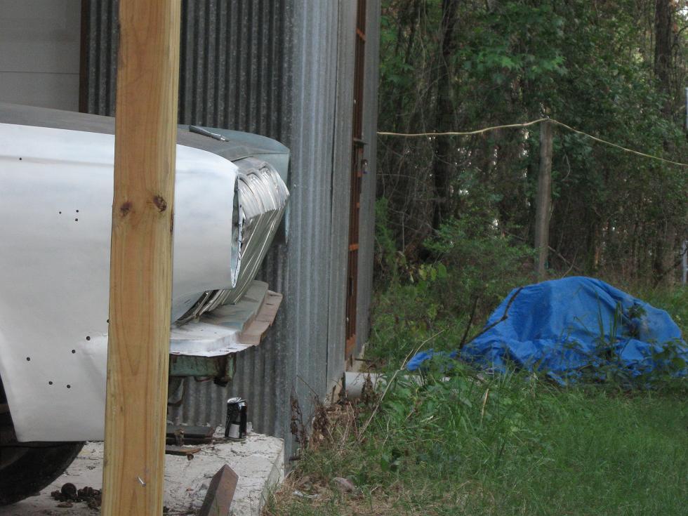

more work done trying to svae this fender check out how thick the filler was man also got the drivers side b-post in need to fill the lower half in just waiting on the metal sheer to come in until then just gonna dolly out the fender :violent-smiley-100:
Picture 003.jpg Picture 004.jpg Picture 005.jpg Picture 006.jpg Picture 007.jpg Picture 008.jpg Picture 009.jpg Picture 010.jpg Picture 011.jpg Picture 013.jpg
Holy Smokes!! That mud is thick! Good luck on that fender..should keep you pretty busy for a while.
Nice Job! Keep it going . My god the bondo. Thought that you broke moms clay flower pot!
Will you name it FRANKENDODGE?
AL
Fender turned out great. Thanks for the detailed pics, If I end up going this way on mine they will be very helpful. I sent the pics of my 64 to you by the way.
I have to admire your courage. I converted a 35 Willys sedan to a two door. Lots of work, and lots of bondo. Keep the posts coming.
i picked up some steel for frame connectors and trunk floor bracing and just ordered a bead roller will update soon also gotta find some 2x3 14 gauge rectangular tubing for front mods thanks for everyones comments its been a puzzle for sure but its gonna be cool
Very cool, I Hope to make a 64 bel 4 door I have in to 2 door, thanks for the pic's.
