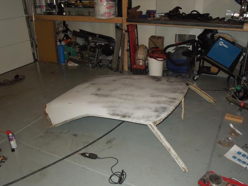

To start things off again, I picked up an entire roof from the A-pillars to the roof/quarter seam. This will solve 95% of the problems I was facing getting the vinyl top damage repaired. I an going to sand and prime the inside before it gets mounted. Pics will come as soon as I get it unloaded from the truck. My garage is half torn apart since I had to clear off a portion of it to install built in shelves. Let's get moving!

Here is my roof. It is complete to the end of the skin at the back and 2/3 of the A-pillars. This thing will save me a TON of effort.
That will save you a bunch of time as you can work on it before you need to install it.
