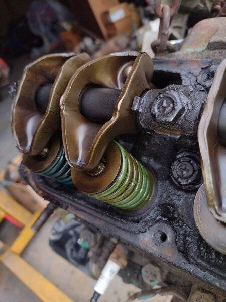

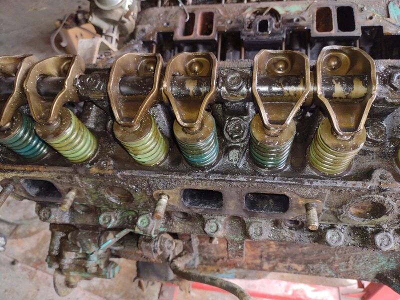

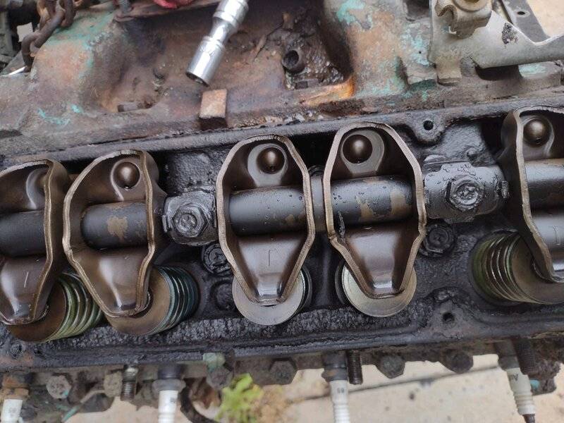

Very little sludge and paint still on the valve springs. The valve cover gaskets were just about non existent, and leaking badly. All the oil and grime on the engine somehow kept the turquoise paint on the block in pretty good shape. It looks as if the engine has never been into before.

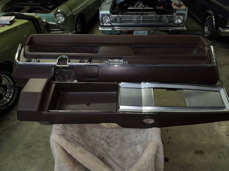

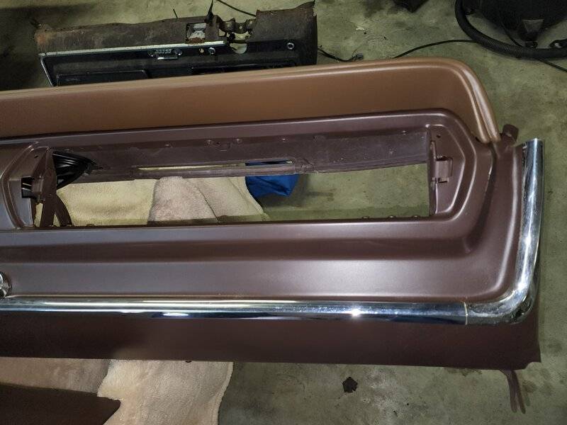

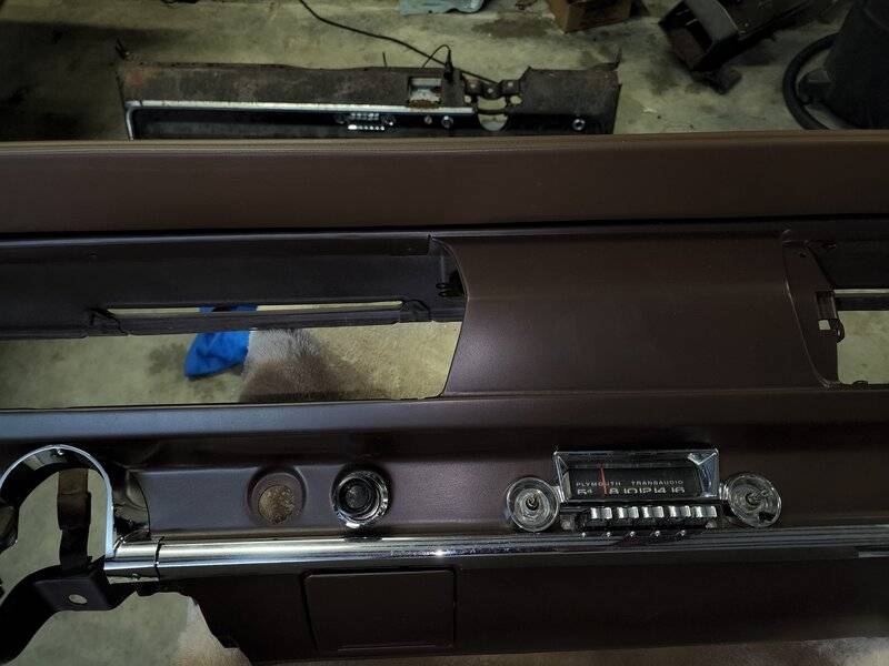

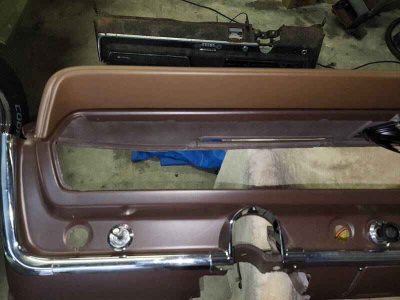

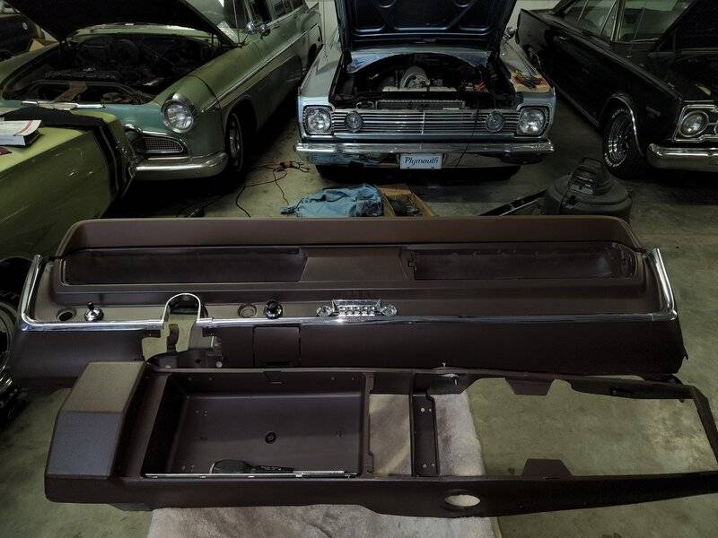

I'm sort of jumping all around right now. A little bit here and some there. If the weather cooperates, it may be painted this week. A little on the console, some on the dash. The harnesses are rewraped, etc.

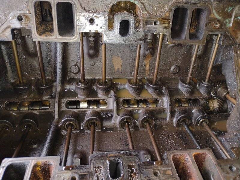

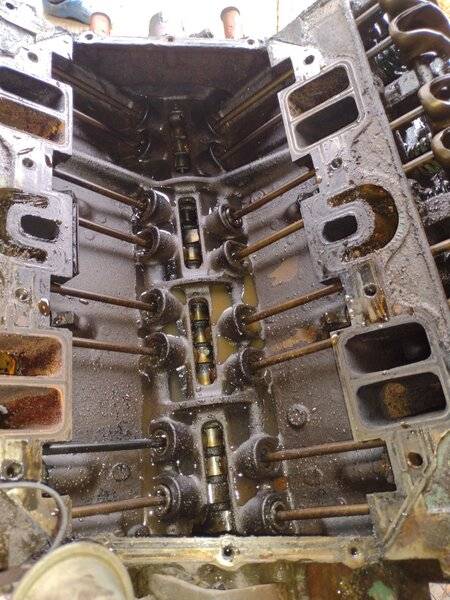

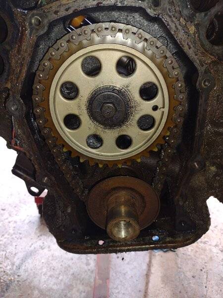

At 91K on the odometer, I thought the engine was due for a refresh. As it comes apart, I'm discovering that I could have run this engine as is. Original timing chain and fiber sprocket with very little slack. Valley area is clean, and no wear on the rockers.
It looks like some one did a great job of maintaining their engine with proper oil changes, etc. It must make you feel good about the rest of the car.

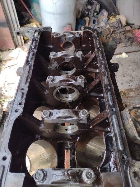

Well it is completely disassembled. Time to get everything measured and decide what I want the machine shop to do. There was a slight ridge in cylinders 1 & 2 but the ring gap was only 8 thousandths. New rings will close that up to 7 thousandths or less. The crank looks like it will only need polished. I will know more tomorrow.

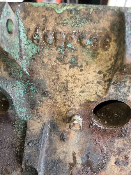

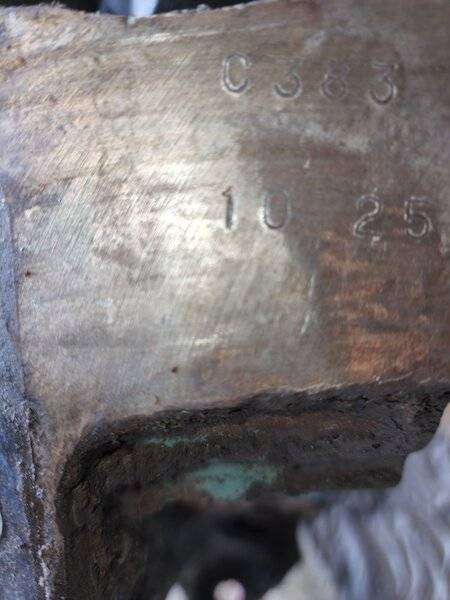

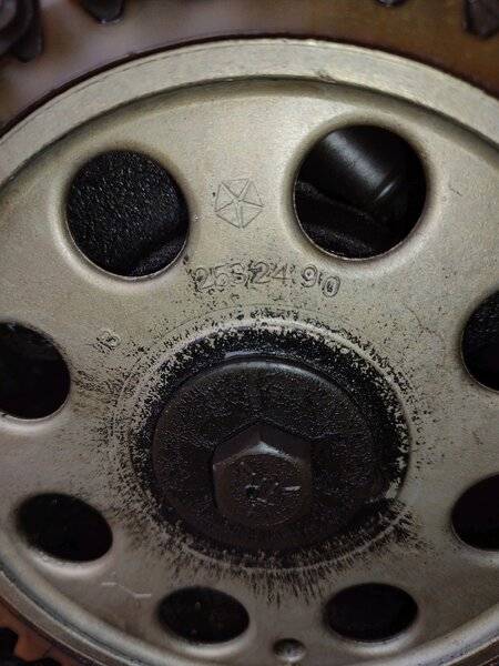

For posterity the numbers on the block.
