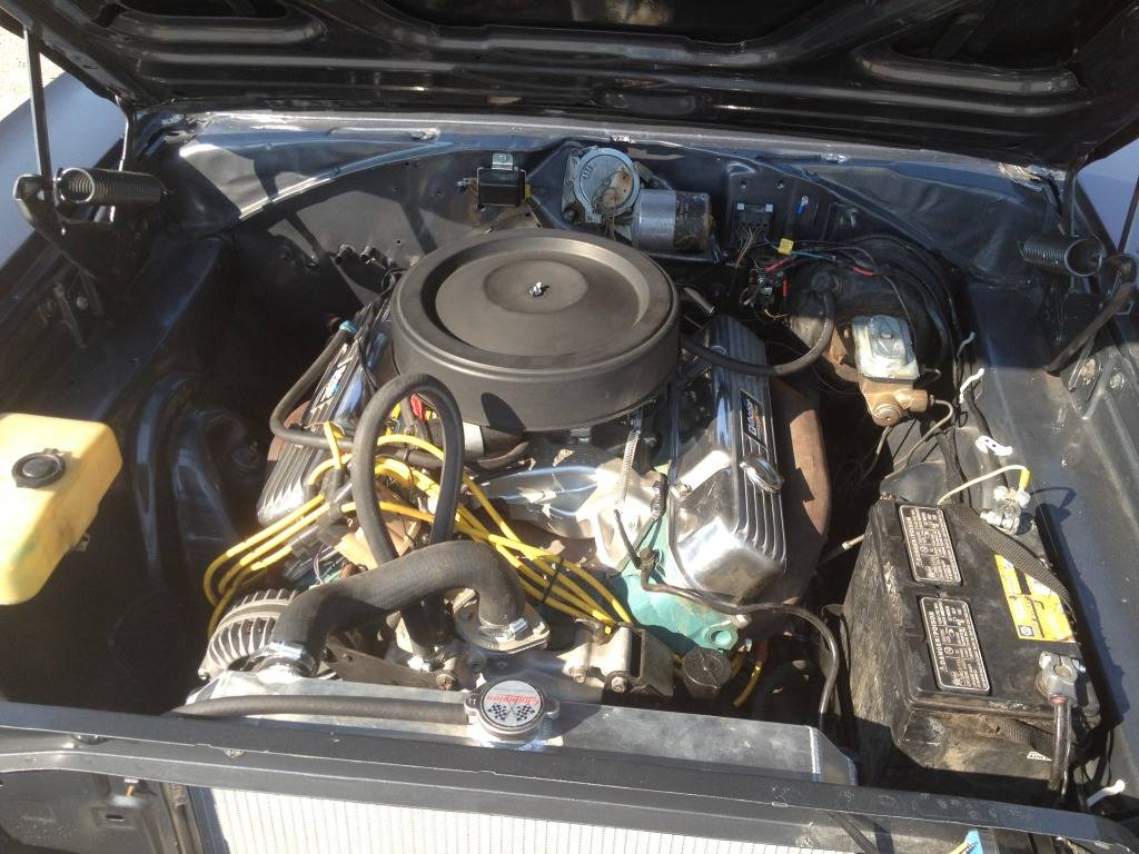

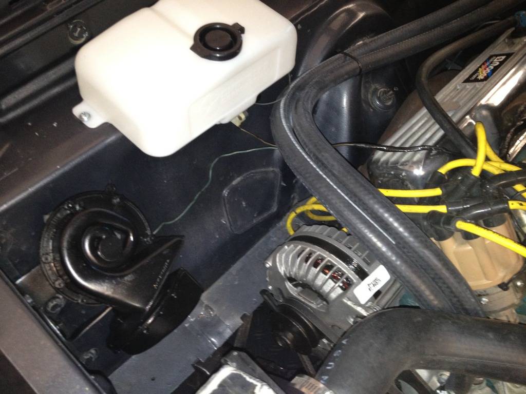

I am starting in the engine compartment and repairing or installing the things needed to make it safe and presentable.
things missing or broken.
Valve cover gaskets leaked so bad it was smoking inside the car.
Heater bypassed (no heater hoses)
No horns installed.
No horn relay.
Windshield washer reservoir brittle and broken.
Spray heads are on but no water lines.
Wipers not working.
Windshield Washer circuit not working.
Commando sticker missing.
Here is before and after pictures of the engine compartment. Once the all the major things are complete I'll go back and remove the exhaust manifolds and clean and paint them. I will also paint the engine block.
Before
After

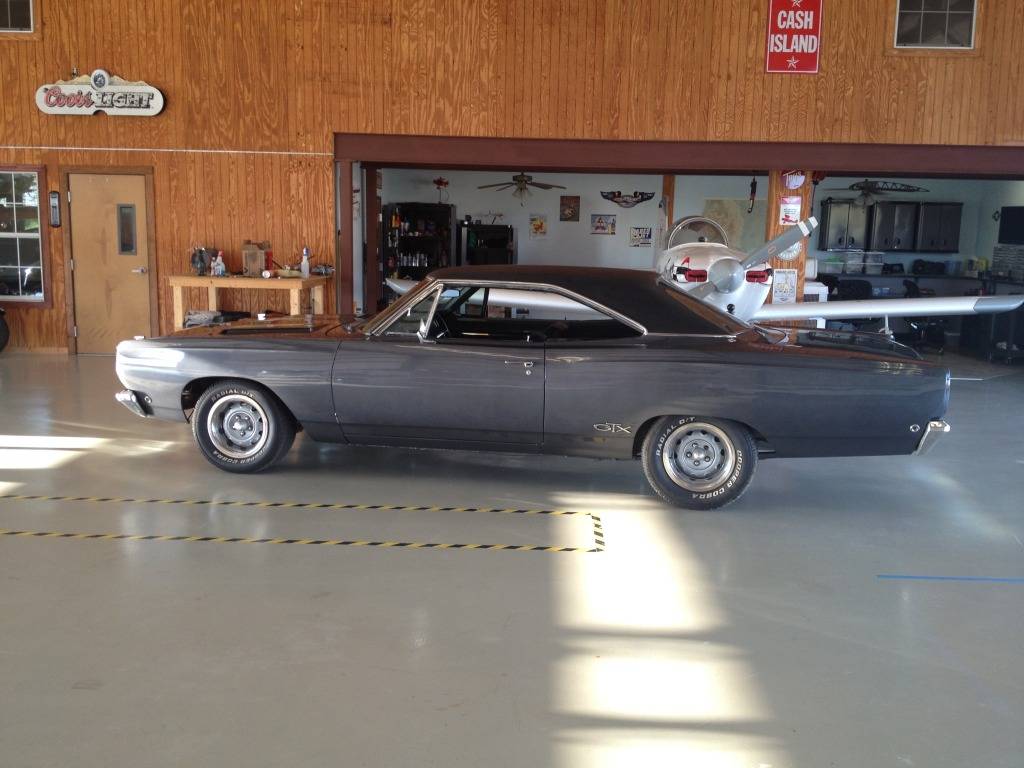

Here are a few pictures of the outside I am going to work on the interior next.
Looking pretty nice now...
does looks like a good start...
it def wasn't "restored" or even freshened up a bit. {a GIANT hose re-routing the water pump back to itself, really?? lol}
What is really comical about the heater being bypassed is, I was expecting the heater coil to have a leak. That's why I added the shutoff, but when I hooked it up the coil was fine no leaks.

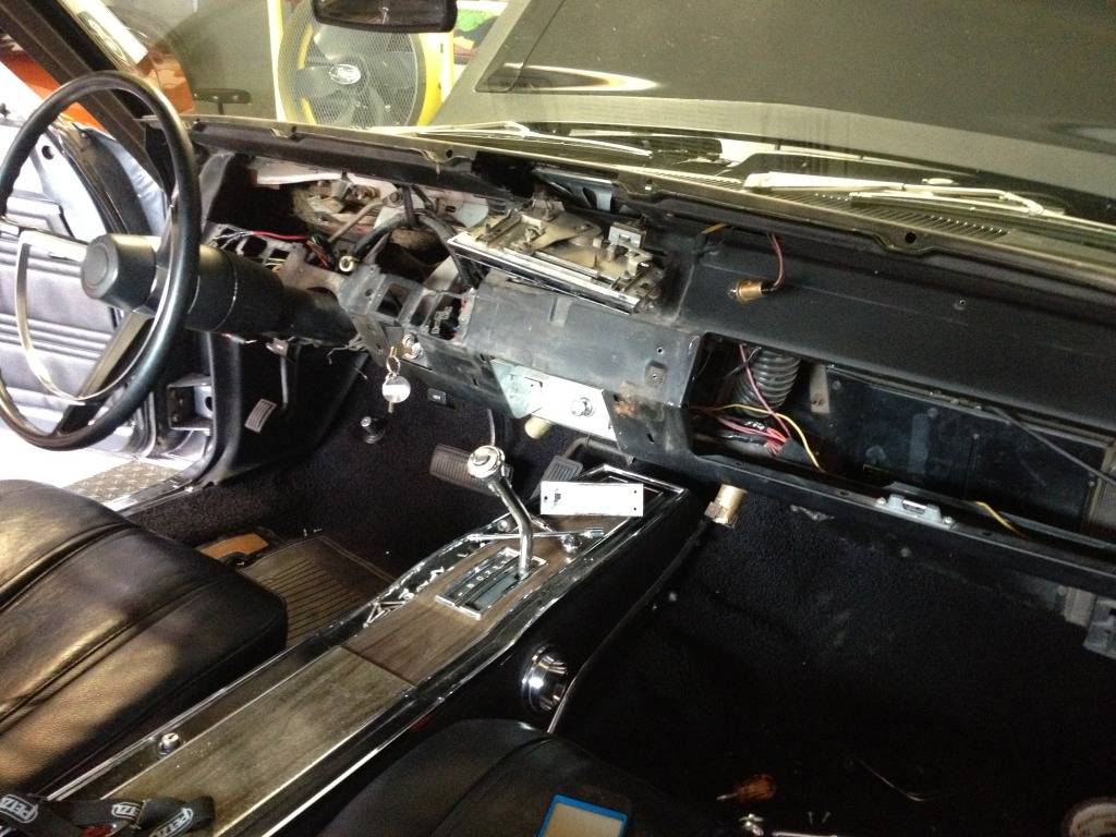

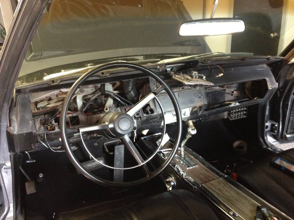

I am completely redoing the interior. It came with a lot of new components but they are not installed correctly.

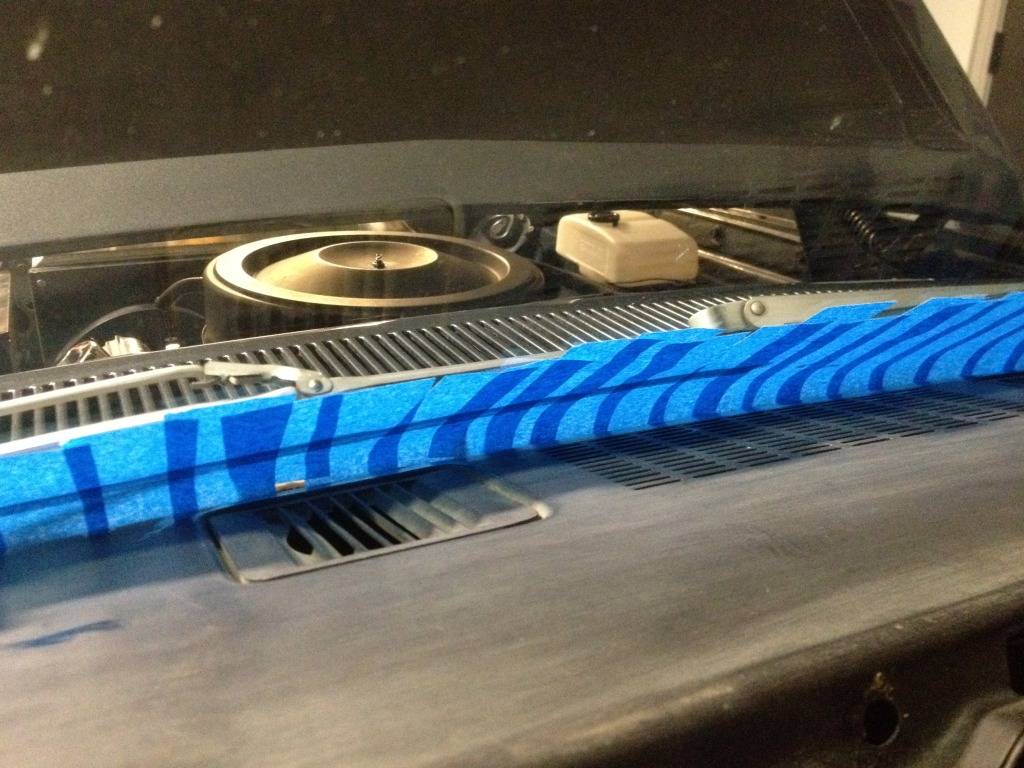

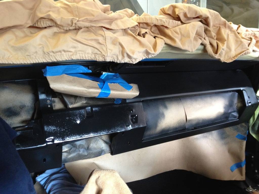

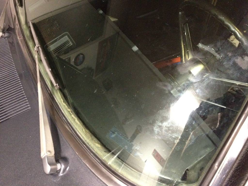

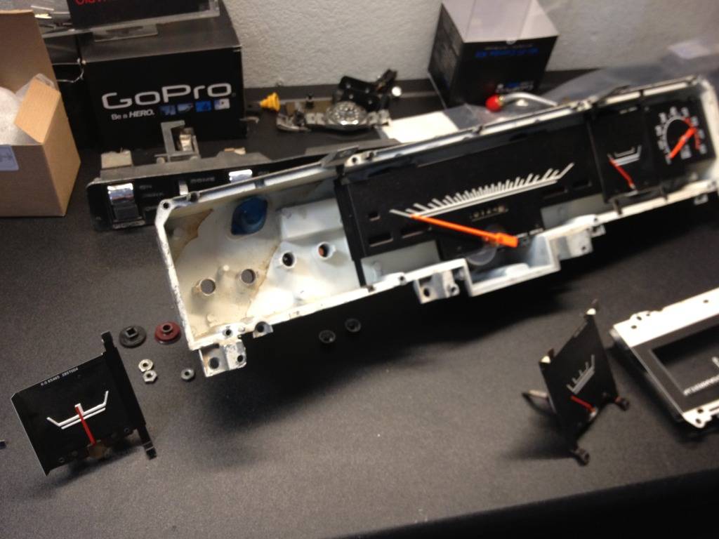

The dash pad appears to be original, I didn't get any pictures of the before but it was badly cracked. Also the dash between the pad, and the windshield, has a considerable amount of rust and needs to be sanded and repainted.
While I have the dash apart I am replacing the amp gauge and repainting the dash panel.

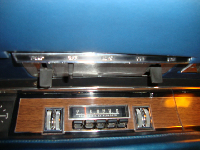

It should,68 didnt have any writing on the plate either.I think the color of the wood varied betwen the 2 years
thanks, I'll check with Year one and see what they have. Everthing I am finding on Ebay describes as fits 68 or 69.

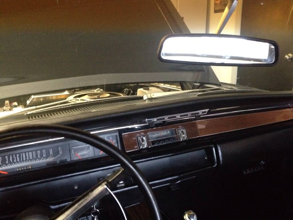

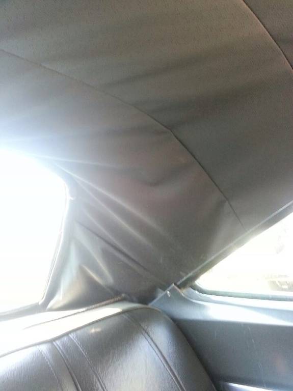

Here comes my most costly repair (I hope) the head liner was new but,,,not looking too good, as you can see from the picture. I had a local head liner shop try to re-stretch it but they called after trying and said the dome light cut out would show. So I had to replace it. :(
after

Wow on the headliner in the 1st pic.Hoping when i get home tomorrow mine looks more like your 2nd pic
