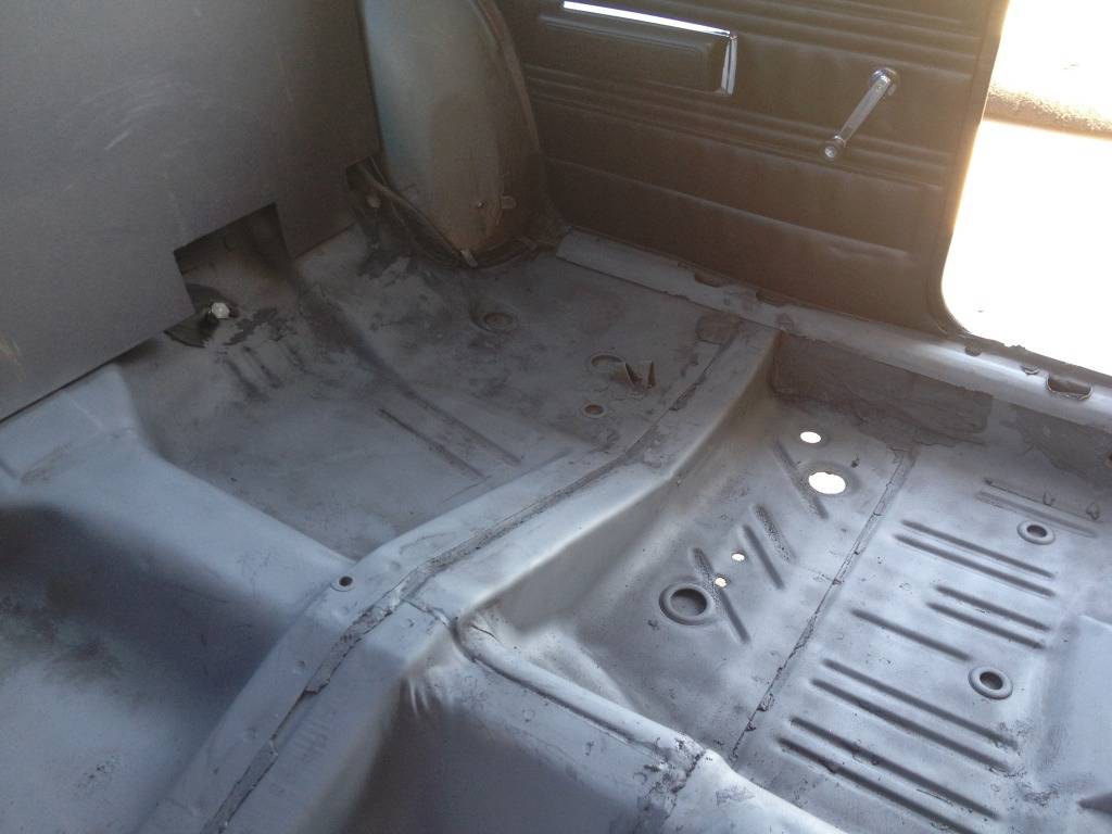

The seat covers and carpet are new but have some issues. The carpet was so badly installed that the heel pad is not straight with the pedals. The carpet on the passenger side is wrinkled and I can't pull it enough to get the wrinkles out, even with cutting it.
I can get new pre formed carper for $140.00, so I decided to strip out the seats and carpet and start over this will also give me a good chance to see the floor pans.
You can see in the picture below how the carpet was installed improperly.

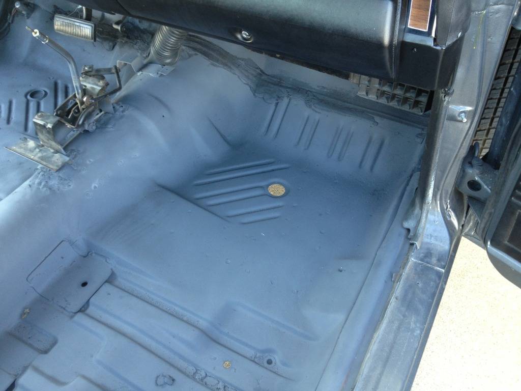

The floor pans look great! These pictures are after I cleaned and painted the floor pans. It didn't look like the floor had ever been cleaned before they put in the carpet.

Thanks for the reply, I agree I have good foundation to work with, I have not found any rust. The car is very solid so it makes working through the issues worth wild.

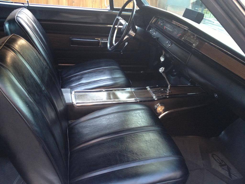

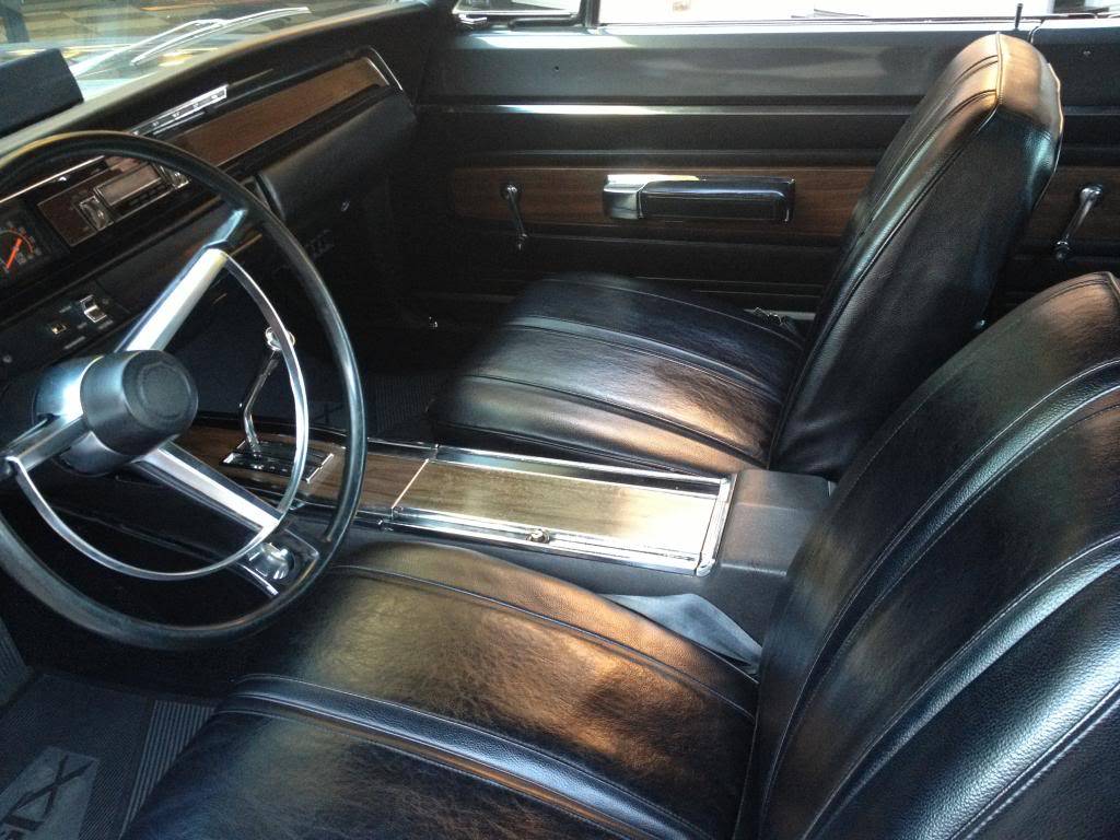

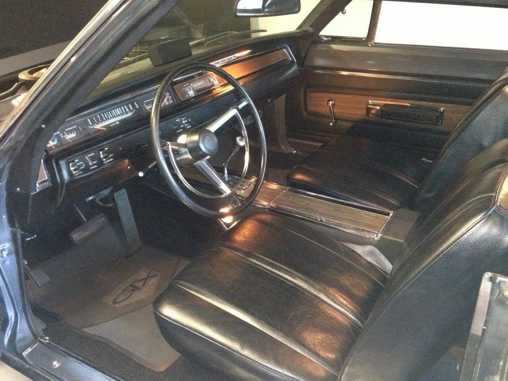

The interior is complete and back together, I reused the new seat covers that came with the car. I added new seat cushions in the front and left the rear seat as they came.
I went ahead and ordered the correct door panels. The RR door panels were new, so I can sell them and not be out a ton of money. I had to order a wiring harness for the console, when I installed it all the lights worked fine.

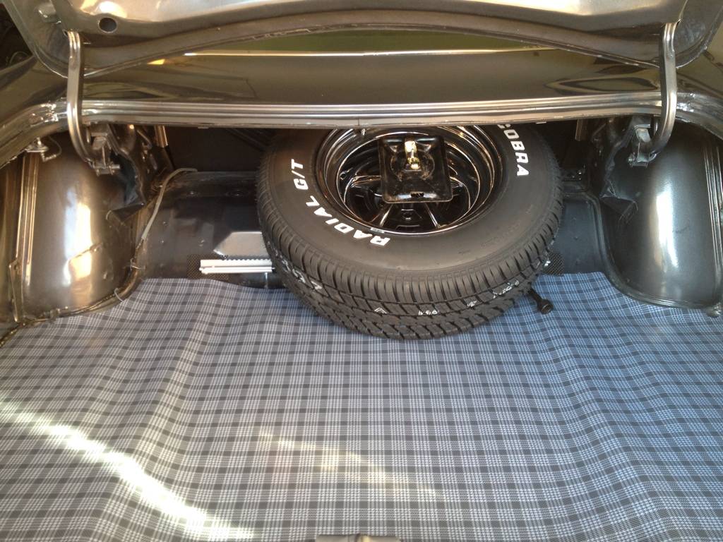

The trunk pan and both quarters are in really good shape. It was easy to inspect them considering this is how it came (Empty)
Before
After I added a Mat, Jack, and spare tire.
It's amazing what adding a few items can do to change the look of something.
