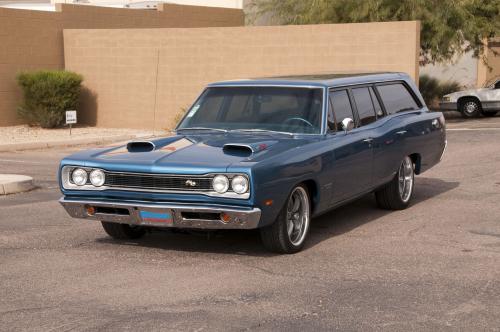

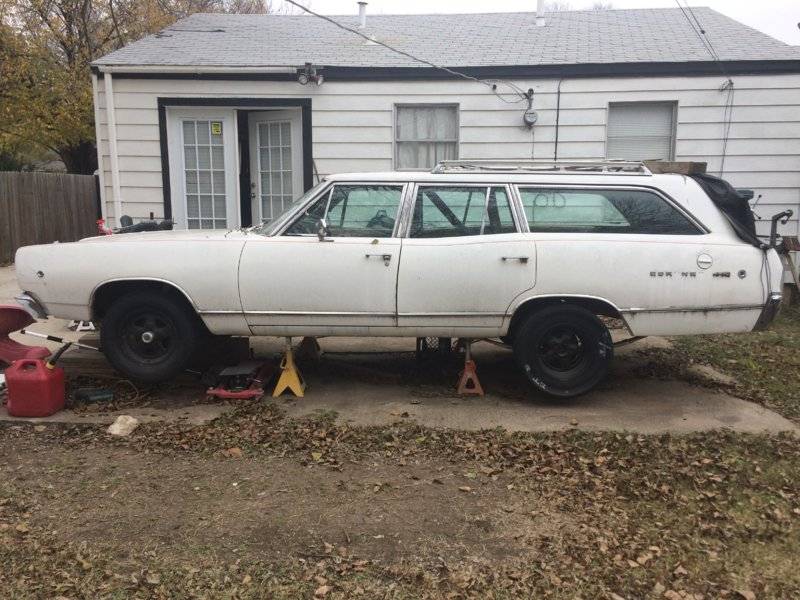

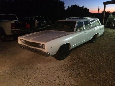

My new 68 Coronet Wagon, can't believe I found one!!!
Very nice, any plans, such as color change or other things.

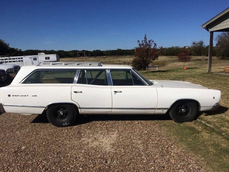

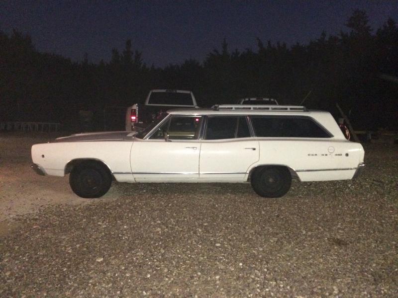

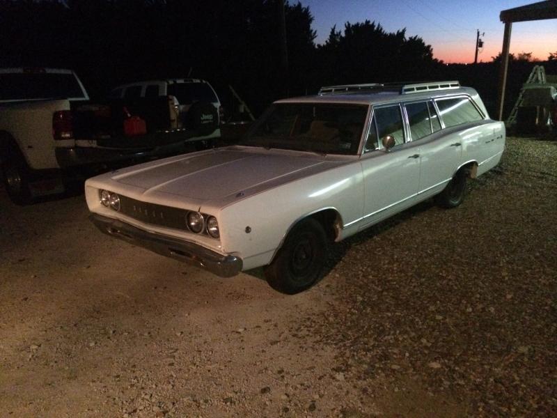

So I have already changed the wheels and tires. Put stock 14" wheels with new tires, similar to stock size. Yeah it looks goofy but it was the cheapest way to get rid of the chrome wheels and huge tires. The car is a blank canvas and I don't want to make any expensive decisions yet. The ignition box is already in the car and wired but the distributor has points. I will get the electronic ignition hooked back up next. I really need a heater next and some kind of dash lighting at night, they are all dead. Also, the motor could use a basic tune-up. The plan is to drive the car as is and get a feel for it.
Radical plans that have already been discussed include a motor swap. I have a 5.7 hemi I was going to put into my cuda and build the cuda as a resto-mod but I have changed my mind. I think I will go back with a more original 340 in the cuda and do a concourse style restoration. I think the wagon should be my resto-mod. 5.7 hemi, fuel injected, definitly forced induction, 5 or 6 speed, and sure grip with 3.55's. For color, I am still undecided and open to suggestions. I do know I want a six pack hood and tail stripes like a bee. I want the cruise and a/c working, probably do a hydro boost brake conversion. It will need all the modern suspension front and rear, maybe even air ride? I like 15" wheels and hub caps but maybe I could be swayed to do a more modern size wheel, with the right amount of persuasion. People will either love it or hate it!

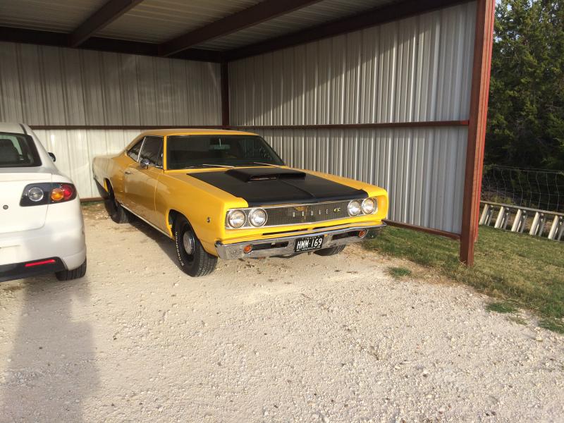

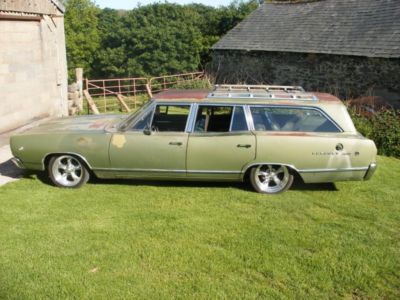

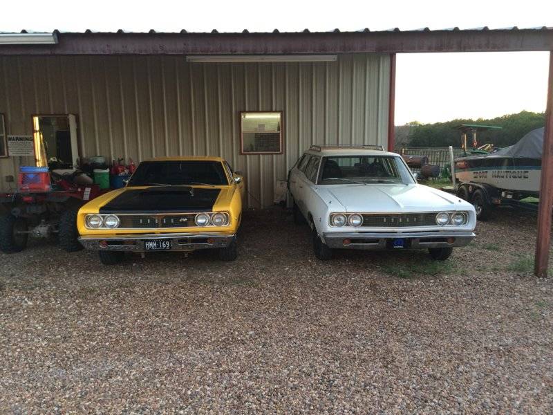

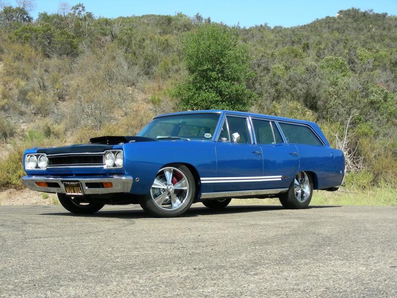

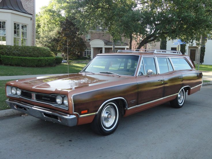

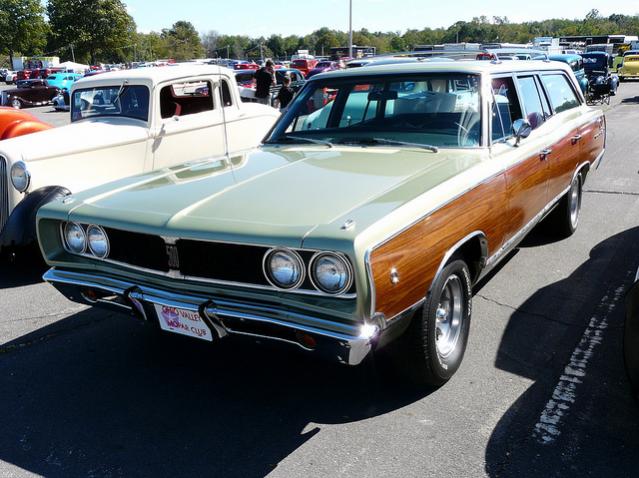

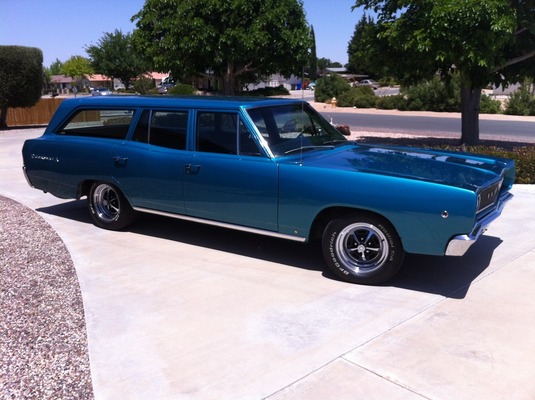

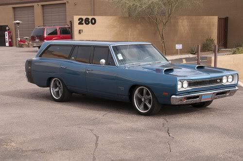

Below is the wagon after putting the little bitty wheels and tires on it, my yellow coronet that fed the need to buy the wagon, and some inspirational wagon pics, which one is your favorite? It would be pretty cool to do the wagon exactly like my yellow car in appearance but modern under the skin for daily drive ability.

Nice wagon! Be a great pro-street project. Big tubs and wide meats.....

Nice Wagon, makes for a great pair of cars. I'm not usually a fan of big diameter wheels on 'our' style of cars, but on a wagon.....I must admit that blue one you showed after your yellow car looks pretty neat. Maybe with cast centred Salt Flat Specials instead, just to be a bit more subtle ?

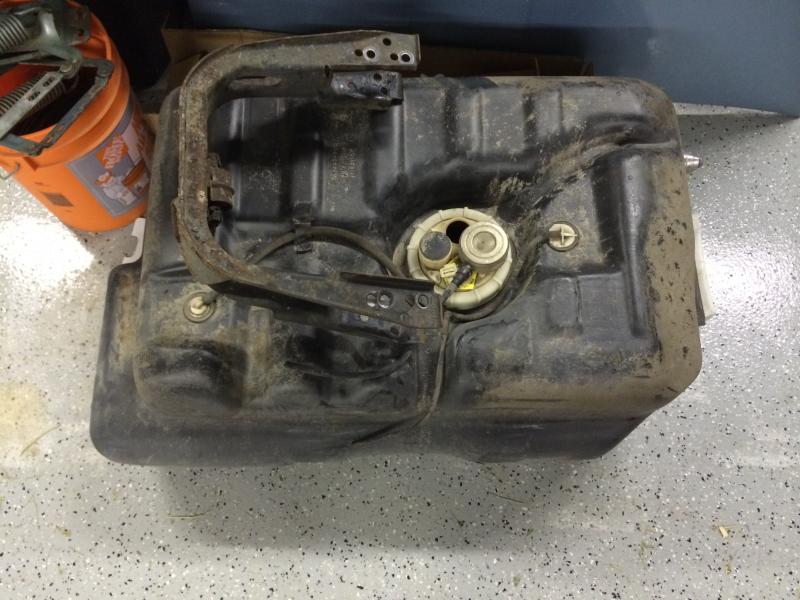

Fuel delivery- Probably the most complicated part. There are fuel tanks available with in-tank pumps for lots of money. The factory tank can be modified with the right amount of ingenuity. Or a fuel pump can be mounted on the frame rail. Be sure to make sure the pump puts out the right pressure, and/or a filter regulator combo is used. Circulating the fuel with a return keeps the pump cool and increases life span. Do what fits your budget and skill level. I plan to modify the tank to accept the fuel pump from the Vans fuel tank. We will see how this turns out.

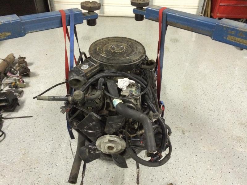

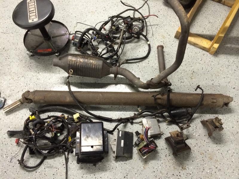

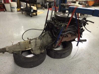

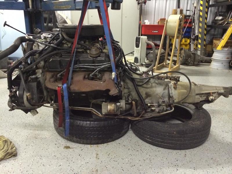

I'll post up pics here as well at major milestones but I'll leave details for the swap thread. First major milestone, the engine is in the shop. For $700 I was able to grab almost everything I need for the swap. I'll get parts like the oil pan and transmission mount ordered Monday. Can't wait to get started. Does feel weird to pull apart a running and driving car. It will be worth it though!

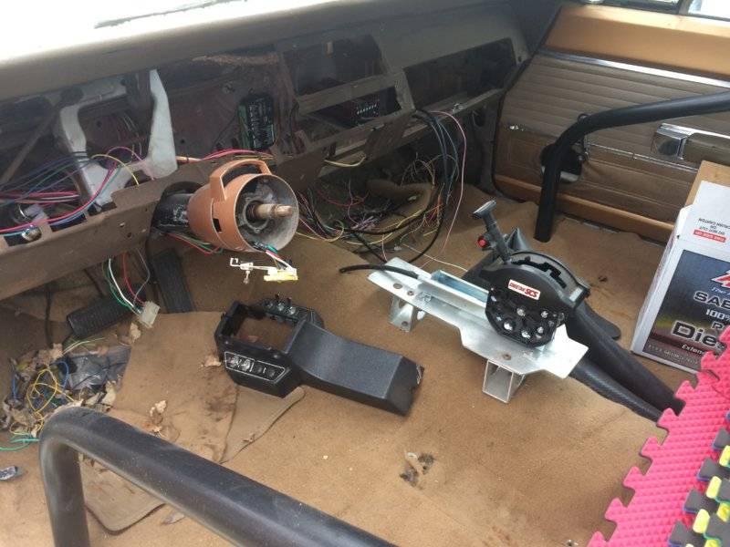

This project didn't die on the table, but a lot happened and the car is nothing like I had intended in my earlier posts. I'll tell the story as concise as possible:
About 20 months ago my job moved to a different city a couple hundred miles south and I choose to stay put. I was worried it would take a while to find work again since I live pretty far from town, so I sold off projects and parts to pad the savings account. Got to do what you go to do right? Well after selling the wagon to a buddy, a bunch of motors and transmissions, four wheeler, dirt bike, bunch of toys, etc., I find myself in a new job after just two months.

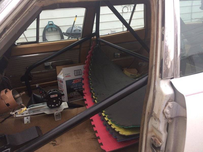

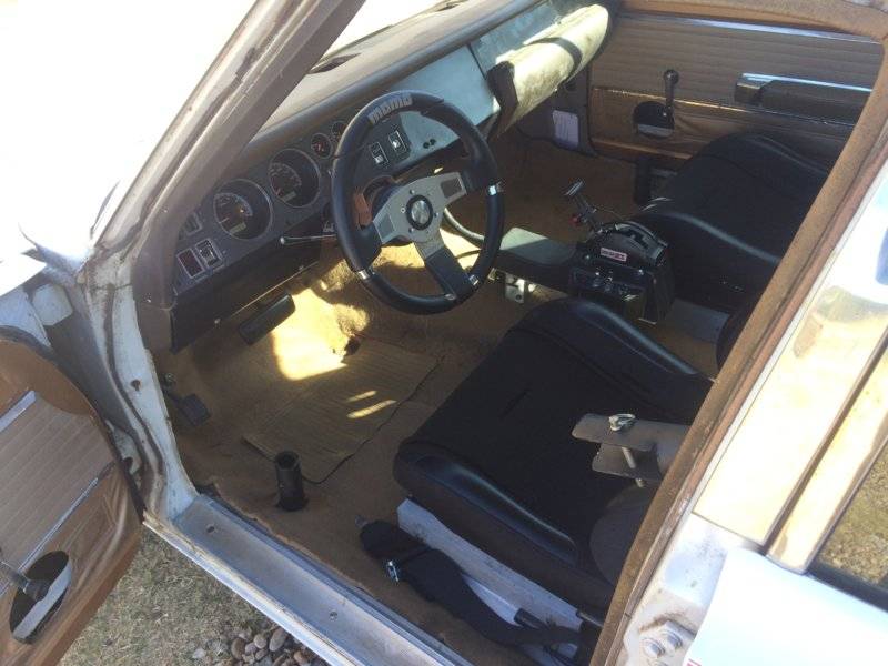

The buddy I sold the wagon to immediately stripped the car, and went nuts ordering parts on the credit card. He put in a 440 and 727 with manual valve body and trans-brake, 4.10 gears with spool in the 8.75, driveshaft and loop, and rips out all the wiring and interior including a/c parts. Adds a roll bar, racing seats, fuel cell, complete fuel system, dakota digital gauges on a flat aluminum dash, MSD digital 7, and a wiring harness from painless. Changes the steering box, all the ball-joints, ties rods, bushings, new disc brake kit from SSBC, all brakes lines, cal-tracks for the rear, longer studs, new lightweight aluminum wheels, skinnies on the front, and drag radials on the back. Does an aluminum radiator, electric fans, electric water pump, complete exhaust, and basically finishes installing everything needed to put the car back on the road. The only things left to do was finish terminate the wiring and tie up some odds and ends. Well like a lot of projects, he lost interest at the wiring step, so close to being done!!! He never intended to do any paintwork and tried to make it look like everything was right out of the junkyard, I guess going for a sleeper look.

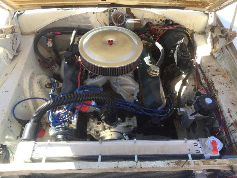

The first couple pictures are the condition of the car after sitting for at least a year waiting on wiring to finish it up. I took the opportunity to buy the car back for a bargain since it wasn't running anymore. This friend had recently bought a hellcat and was already modifying it so I figured he had no intention of ever going back to finish the wagon. I spent the next month finishing the wiring and getting it road ready. The last 5 pictures show the condition of the car today. It has made a dozen passes at the drag strip and driven to town a hand full of times. Honestly this whole roller coaster of a story worked out for me in the end. It's not the direction I would have gone with the car, but its a lot of fun and the total investment I have in it is still pretty low.
It's not too late to go back, but I think the car is fun the way it is now. I now dream of putting in a 500 cu. in. monster and cleaning up the interior a bit. What would you all do with it now?
