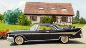

You read my mind on the black and gold combo. This image is of a 59 but anything from a 57 – 60 will do.

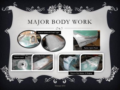

project update
All of the bodywork has been done and the primer coat starts tomorrow. Other than some issues with rear splash panels, the body was/is in great shape. Other body work was due to filling in holes de-badging and removal of rear windows, antenna and side markers.
