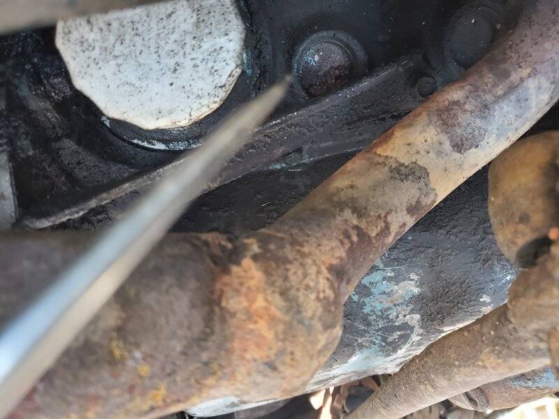

I bought this car a couple days ago. Rats ate wiring. Old owner bypassed "some stuff" and got it running soon found blowen freeze plug then the car sat acouple years then I bought it.
I just got it running the water is coming out of the back left of the motor hard to see exactly where. Any advice is appreciated.

Small block Mopars have freeze plugs behind the starter, and worse, in the back of the block, covered by the transmission.
Get "deep" brass plugs.
MUCH easier to install, not as prone to pop out and won't rust out.

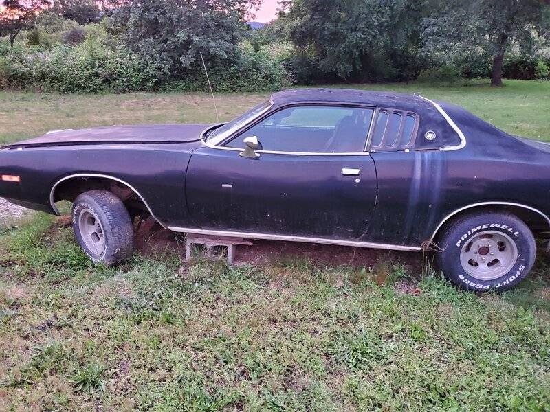

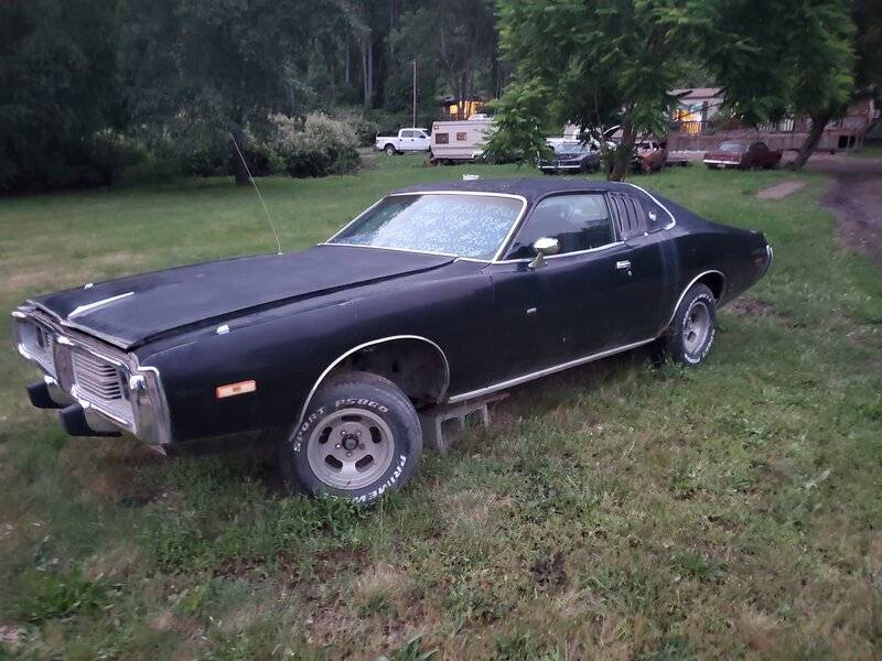

Seeing how we’re both from Michigan I’m sure hanks73340 would agree that a Charger project that appears to look as rust free as that is near impossible to find around these parts.

There's definitely some rust under the vinyl top
Yeah I see the rust streaks running down on the rear fender. Here in the salt laden states from the bottom up is more of a problem, which looks pretty good on your Charger.
I didn't pull it the engine out.....do you think I need to???? I was just going to replace the one i know is bad. I hope I don't need to pull the whole thing out..
I did get the one bad one out and I'm picking a new one up in the morning. I was just going to replace that one and If more turn out to be bad i was going to pull the engine and do them all..
When I got the one out there's alot of nasty behind it...

So what do you think? Think I can get away with replacing the one
What does the car look like without the vinyl top? Is it just a hard top underneath? Can I pull it off and just run it a hard top?
Fix the one if another freeze plug gos soon I'd consider pulling Motor it's a fairly easy task probably make your life alot easier the trying to do the plugs in the car!
As for the vinyl be prepared for rust !
Its a normal roof under it but not painted . Also there Bondo around those side 1/4 windows that is probably going to look like trash they didn't make it look good because the vinyl covers it ! So don't freak out it's again not a big deal it how they installed the window plugs to give it the Gilles ! Nice car, P.m. if you need help I've had a ton of these cars

Ok so I replaced the one and what do you know it starts leaking out the back freeze plug.....
Time to pull the motor..

Yeah kinda figured it is an easy job it will make your life easier throwing new gaskets into the motor why it's out would be smart !
Same with the input and output seals on the trans !
