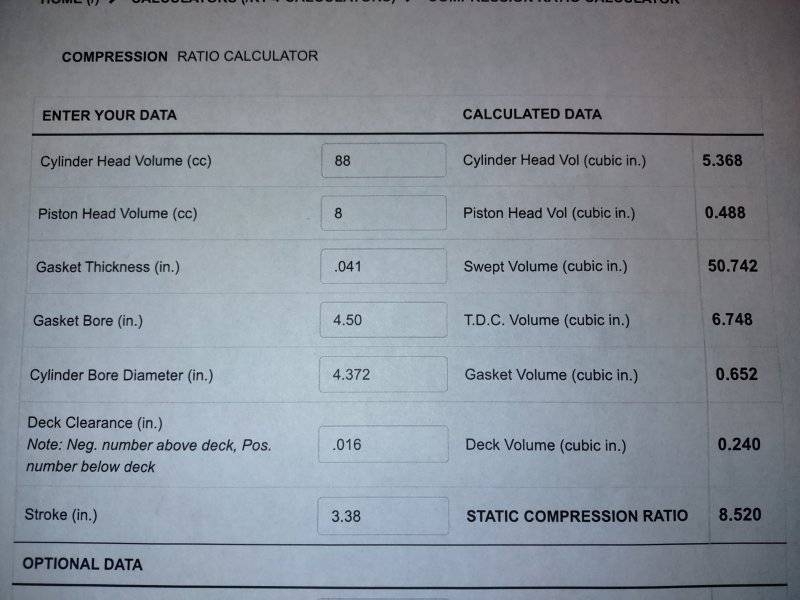

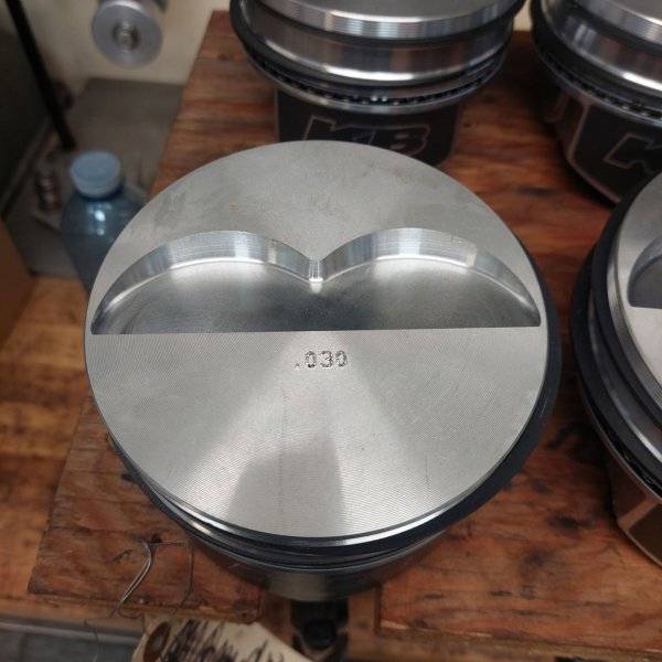

Here is the calculation.  The heads cc'd at 89 before we milled them 5 thou, so I assumed they are at 88 now.  The valve reliefs are huge in these pistons.  That and the short stroke leads to the low compression.  This is meant to be a high torque cruiser that will run on regular gas, however, my back up plan was to build a solid short block as close to zero deck as possible, so that with just an aluminum head and cam swap the engine could make considerably more power.  I had calculated that we needed to mill the block around 25 thou.  When they measured it the only ended up taking off somewhere between 10 and 15 thou, so obviously their calculations were off a bit.
