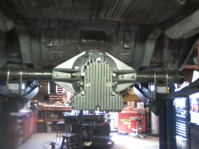

Also I got my rear pritty much done and just waiting for my axles to get finished.Qc 4.jpg

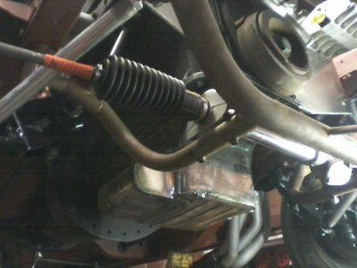

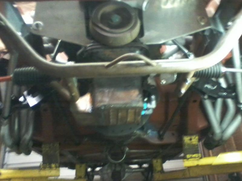

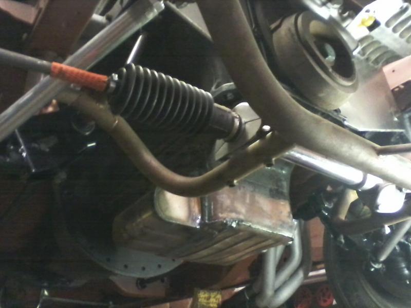

Nasty rainy day so I went and made an oil pan with a dual pick up and a kick out for more oil volume and control. Was going to by one but hell with used parts laying around I would rather do one myself ! Going to have it powder coated so it will be Pritty ! OP1.jpgop2.jpg Also made a front bolt in drive shaft loop. Still Picking away at it!!

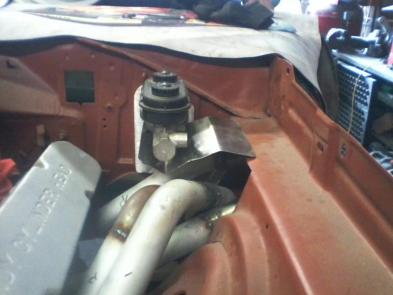

Made a heat sheald out of stainless for the master so as to keep heat off of it. Master shield.jpg

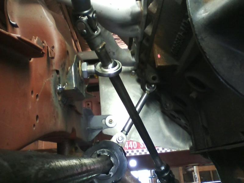

Got the steering figured out and mocked up this past weekend. Nice and smooth and tight . Useing a Pinto style Rack and also made adapters to take Stock outter tie rod ends. Little by little she is comeing along ! ;)steering.jpg
